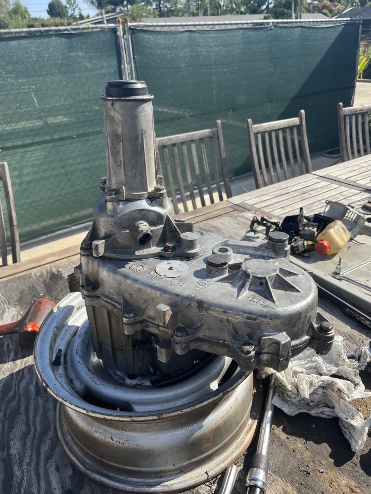

‘94 Transfer Case

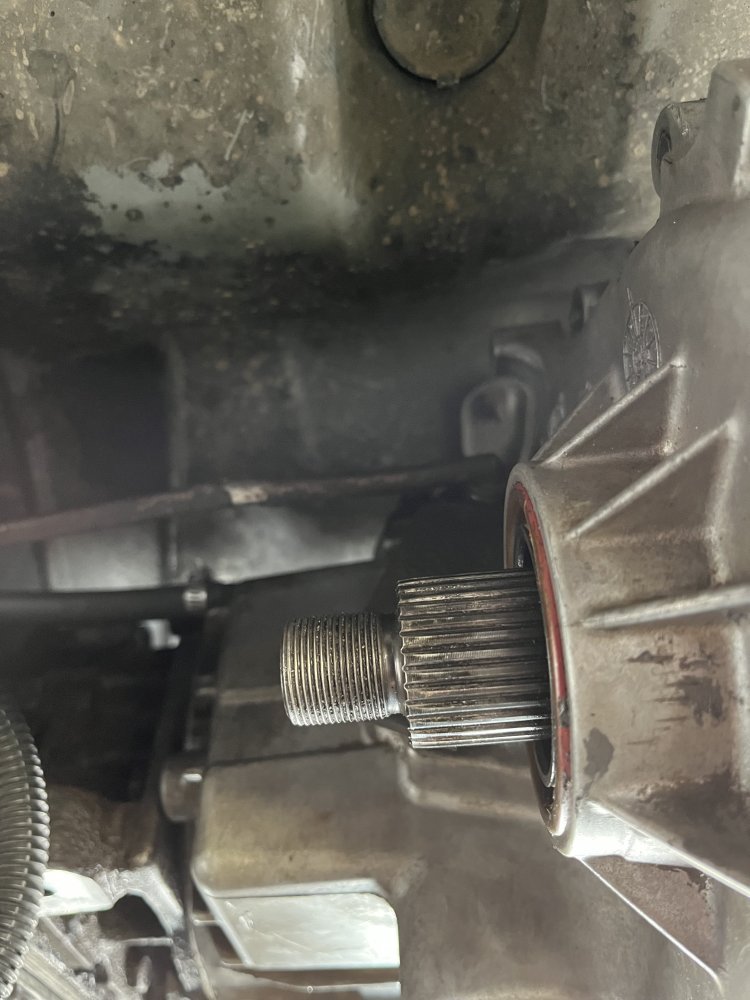

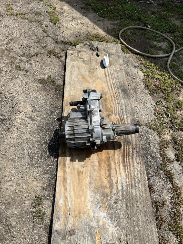

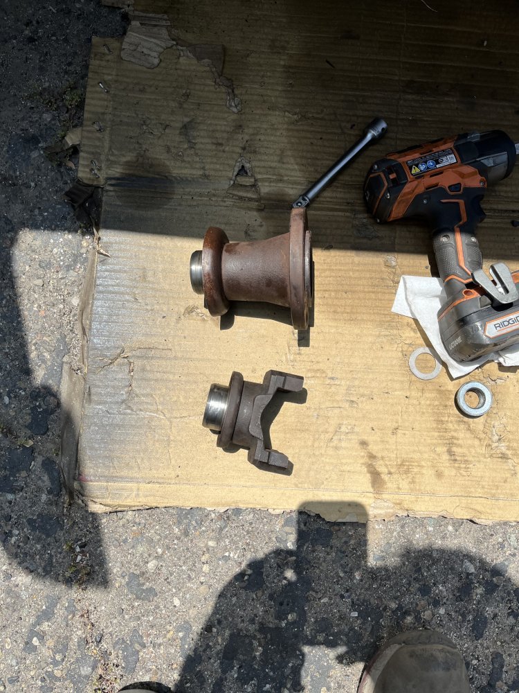

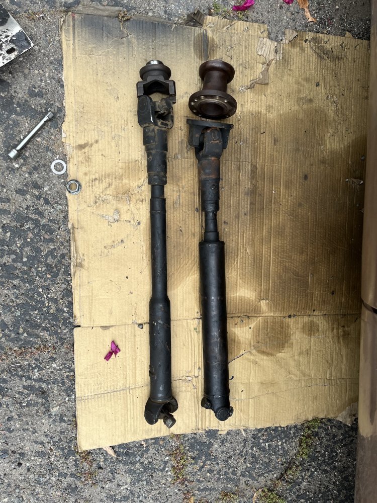

Running into a slight glitch here. As previously noted, the connecting yokes and front drive shafts are different between the ‘94 (top) and the ‘95 (bottom):

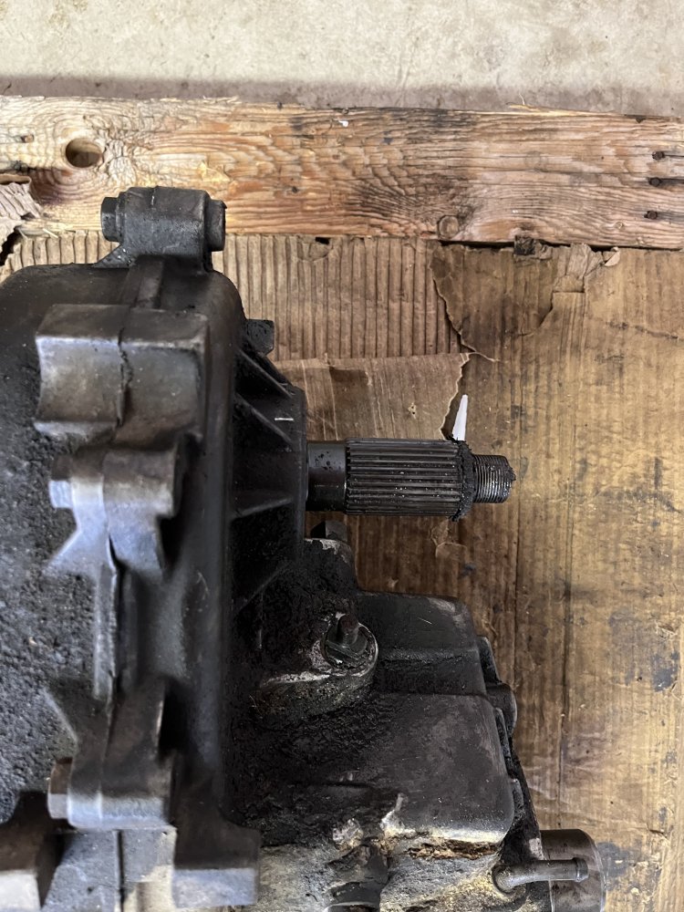

There’s another difference. The front output shaft on the ‘94 is longer than the ‘95:

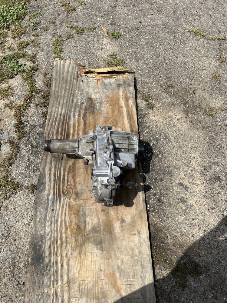

I could just swap the output shafts between the transfer cases….but I ain’t going there. So I’m hopping onto the computer to search the pick-a-part bone yards for a ‘95 and later K2500 Suburban to harvest a front driveshaft from.

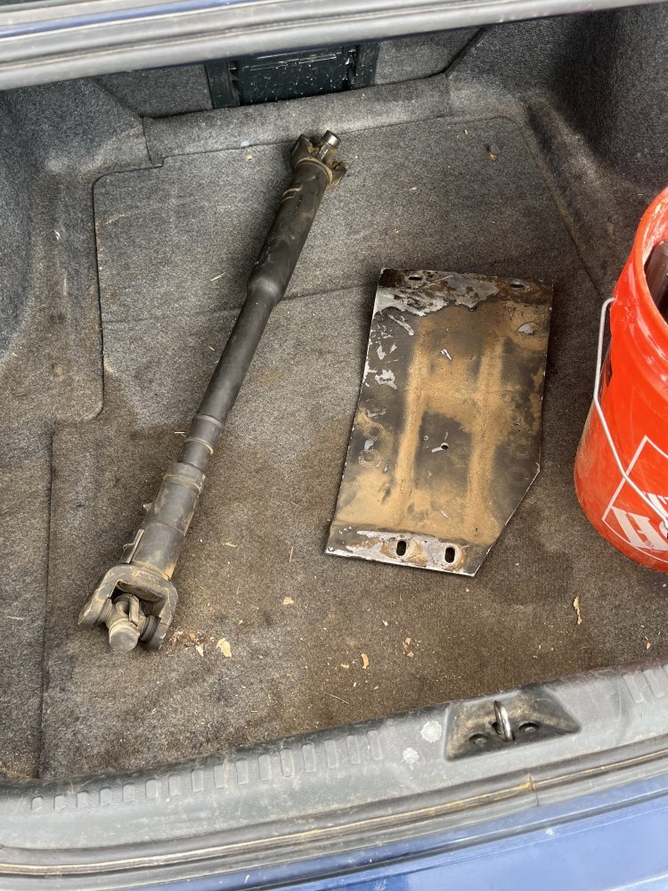

Back from the boneyard with my driveshaft. They had a ‘96 and ‘99 K2500 out in Hesperia. A quick look at the ‘99 and the yoke on the transfer case has a boot behind, so it different. The yoke on the ‘96 was the same and I harvested the driveshaft from it. It also had a skid plate under the front differential and my ‘99 does not, so I took that too.

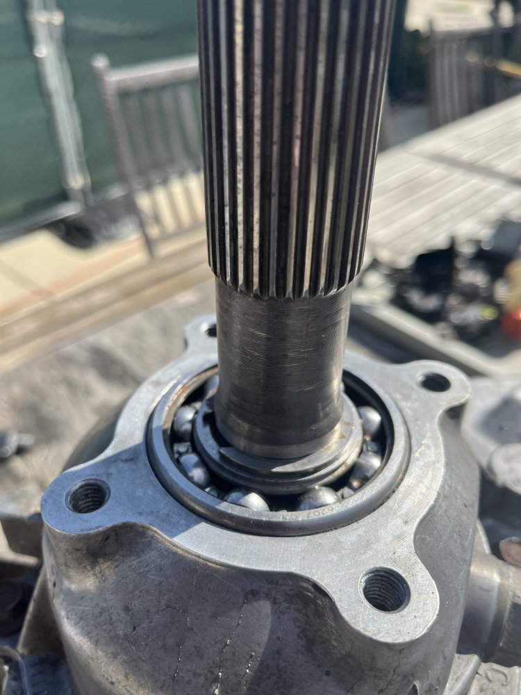

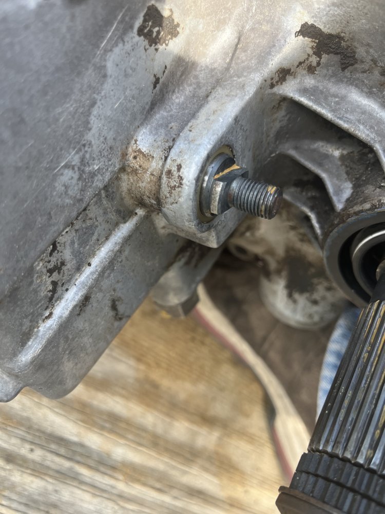

Thought about it, went back out and checked and I did not have the linkage bar on the flats of the shift shaft.
Pic of the flats on the shift shaft of the ‘94 transfer case:
Test drove in the backyard and I now can shift it into all gears. I’m just tired.
