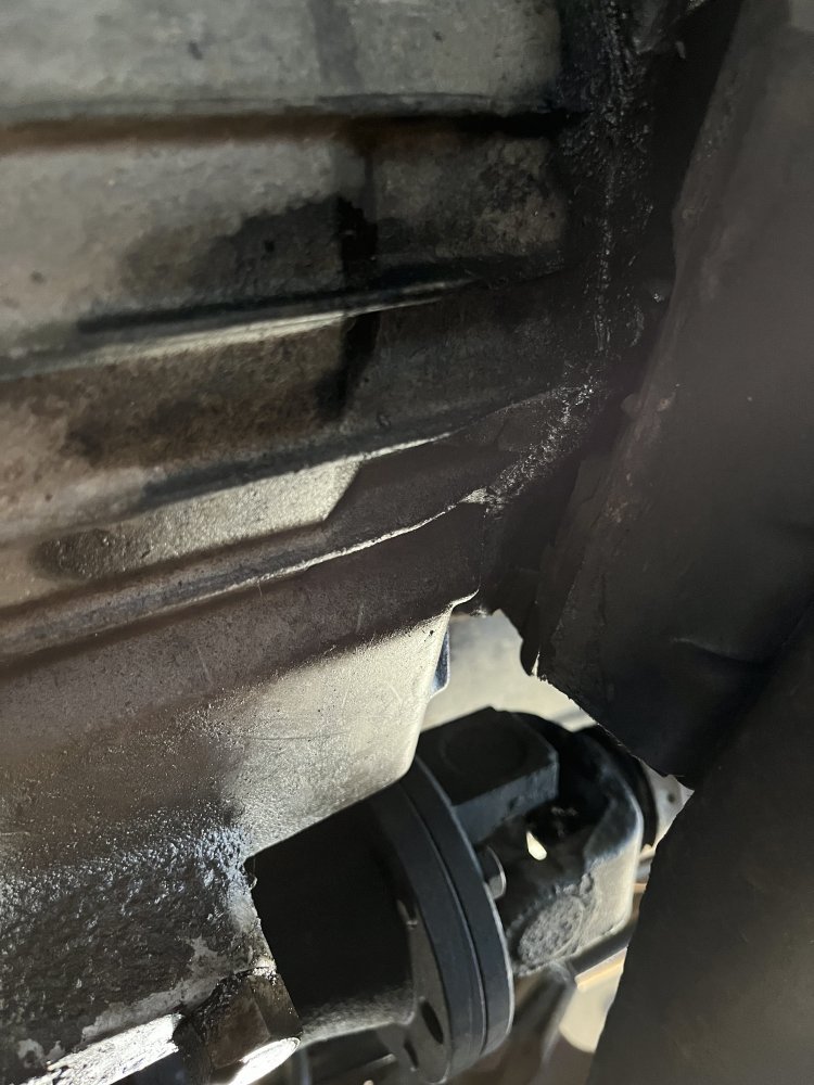

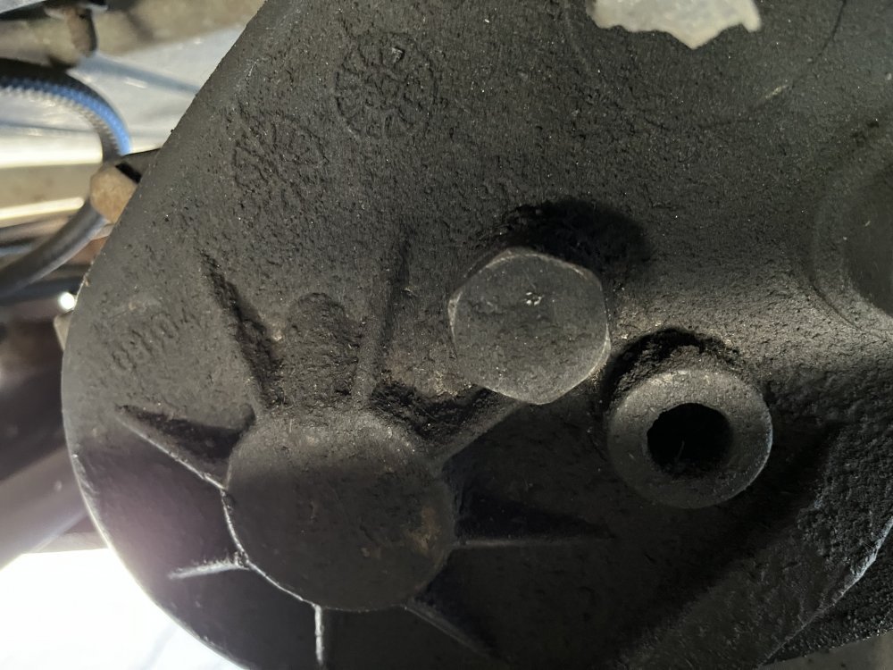

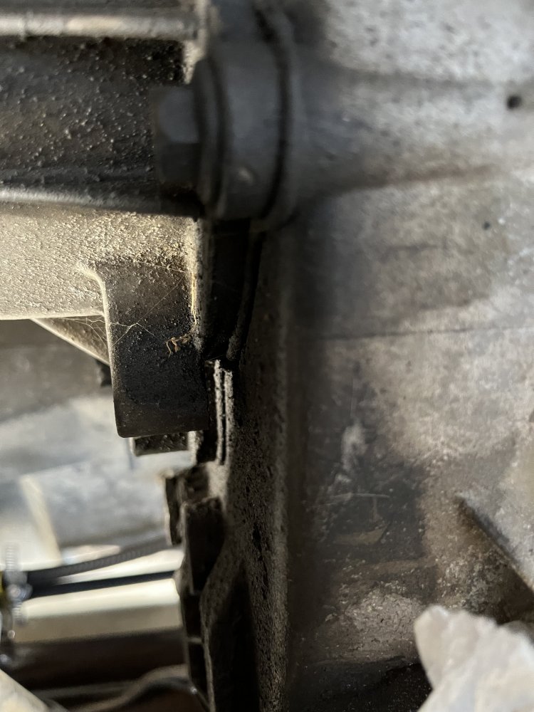

Got under the ‘94 Suburban to check for leaks. Found the drain plug loose on the front differential. Tightened that up and topped off the diff with about 8 oz of oil.
Checked transmission fluid and it’s not only full, but also very clear/clean.
Went under it to take some pics of the leak plumes, which are not all bad. Save for one plug under the front, it’s mostly dry:
4A782721-1C5D-4D4F-A7FE-13482FE6D097.jpeg401B4445-3FAC-46B2-B527-708044A4633D.jpeg043AD0F1-71D7-4162-8FEE-D3CF22892AF8.jpeg
It doesn't look like you have taken the fill plug out in awhile to check the level or condition of it's oil. Have a drain pan under it in case it's overfull. The seal between the transmission and the transfer case gives up and fills the transfer case up.
Depending on how fast it's leaking you may have low transmission fluid shortly after removing the excess oil. It may quit moving low transmission oil level.
I would check the bolts are tight to the transmission from the transfer case.
I pulled the upper fill plug tonight and……it was over full such that it dumped a heavy enough flow that it got into my hair :-(
So I have a leaking seal. Need to get a view of the tag on it to confirm the model. I will order up gasket, plus the seals for each driveshaft. This won’t get done until I’m back down from Montana in February.
Might check your adapter for cracks and/or wallored out mounting holes. I had that between my 4l80e and 246 autotrac that had a leaking trans/transfer case seal.
I will when I pull the transfer case.
Again, this will be addressed in February. Not a primary driver, so we have the luxury of parking it. Told him to park it in front of the garage at my place to make it looked lived in.
