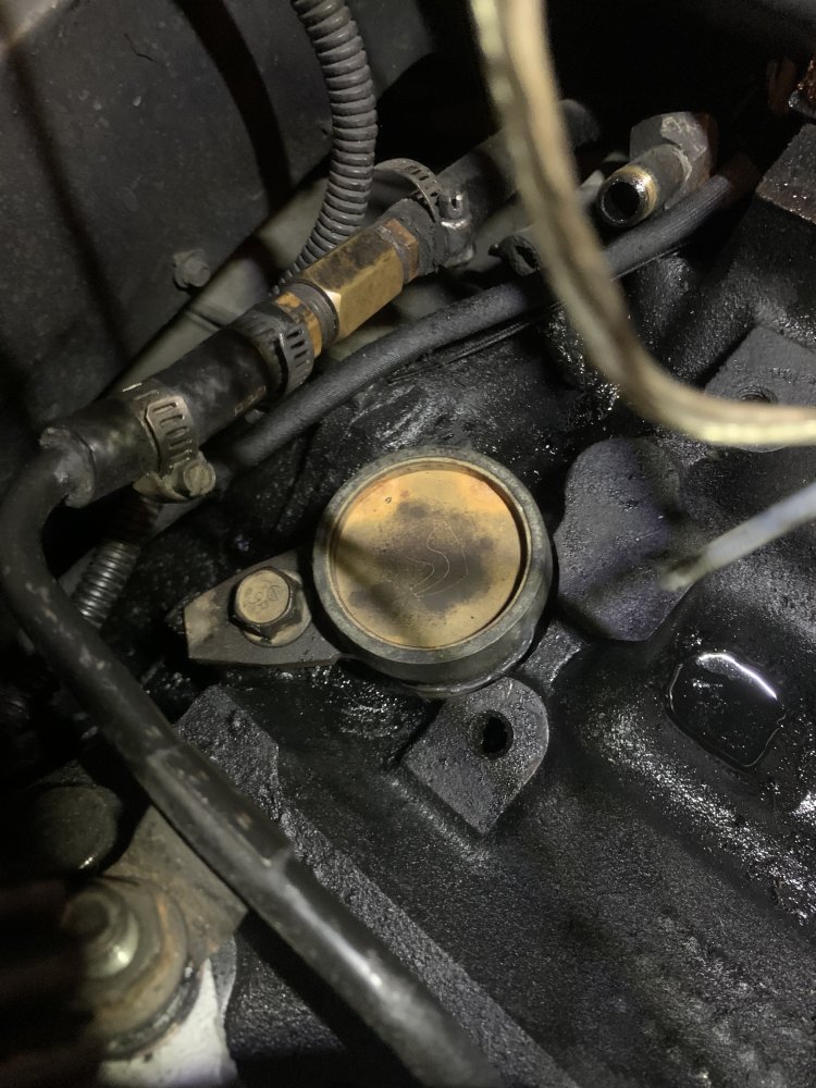

How would I overcome this? I can barely lift it enough to get my fingernail under the face where it mates to the block. What happens if it is stuck? or what can of worms am I opening here!
there is no chance I will end up having to pull the motor over this right? if the shaft it stuck in the top, it won't end up breaking the plastic retainer joining it to the oil pump forcing me to pull the engine? this is what I'm afraid of getting into.
Here is the current state of affairs... Maybe @Will L. or @ak diesel driver has some tips on what to do here. the top of the oil pump drive rotates easy and smooth, I can lift and feel something down lower in the block seem like it's stuck, that or the lower section is broken? I can't seem to find a good way to get a pry bar in there to get a bite on it trying to lift. all I'm doing is swapping this out for the one off the 6.2 block to stop the oil leak.
Do you have a small gap under the oil pump drive?I was thinking you could use one of those cv axle puller tools that’s shaped like a C that guys use to pull stubborn cv axles.Thread on the slide hammer and it might do the job your looking for.
EDIT:Looks like you already have it out…lol.I was late with my response.Good job👍
Ok Now I did it! here come the worms out of the can.... Help me understand this....
I got the rod off t he drive only to find how worn it is. is this a problem?
Looks like the hex is indeed worn.New sealed power shafts are available from
Rockauto.You’ll also need the nylon retainer that clips upon the oil pump.It prevents the shaft from being pulled upwards when removing the oil pump drive or vacuum pump units on older 6.2 engines.
Is that plastic retainer needed once I get the rod back in with the top part of the drive ? I pulled the rod from the other engine easily and it doesn’t have any wear
I’m working to find something to hold the rod into the upper drive so I can reinstall using the drive without the ESS sensor to fix the oil leak
The retainer in my opinion is only needed when you remove the oil pump drive so the oil pump shaft wont lift and fall into the oil pan or get lodged someplace where it should not be.
You could try using some heavy grease on the end of the shaft before you insert it into the oil pump drive unit.That should hold the shaft in place until you get it down into place.
Got it in! Me sweating bullets hoping to get it nailed while my wife was sitting in the background giggling and laughing as I said “gotta get the shaft in the hole “ and “gotta rotate the engine to get the tip in”. lol her mind was in the gutter
Went in smooth with no issues. I had a ratchet on the alternator pulley turning the crank slightly and it felt like it dropped right in.
you read my mind, I almost did! standing over the engine looking at it I almost forgot I had pulled it off to gain access. put it all back on and buttoned up the harness I had moved out of the way. test fired watching the gauges, oil pressure went up, checked for leaks pouring out. all seems good.

it was funny because that slop was what was holding the rod in the gear. the last maybe 1/4" of the rod had no wear so when it was cocked in that direction it kinda wedged its self into the oil pump drive gear! when I removed it from the drive, I had to lock the rod in my bench vice and tap on the gear with a hammer to jar it loose. it was wedged in there real good at first kinda like a bolt head about to get rounded off in a socket and getting stuck.
I could only imagine what would have happened if it did start rounding off inside the engine! oil pressure lost and you'd be hearing about another locked up engine carnage thread, don't even know if I would have found this at the culprit!
