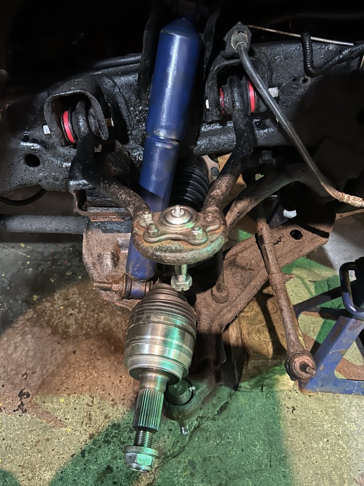

I have the passenger side half completed to some degree on my 96 Chevy truck.Heres how it looks with the red prothane control arm bushings in place.It does have a new eccentric bolt kit in place too.
Both sides will get new cv axles as well along with tie rods,pitman arm,etc.Still waiting on FedEx to arrive with the dust seals so I can install the steering knuckle.I’ve had a lot of these types of trucks apart in the past and many of them have those seals missing altogether.
I also have new rotors that are slotted and drilled for the same truck.Those came from Amazon $155 delivered.
So question.... with the prothane bushings, once they are tightened up does the a-arm flop around like the bushings are a bearing of sorts or is it like the rubber ones where they have to be in a loaded position before tightened?
Right now the bolts are somewhat tight and when I attempt to move the control arm up and down the bushings remain stationary with a smooth movement of the control arm.I greased the bushings on the outside before pushing them into position.They went into place pretty easily.You do have to reuse the inner steel sleeves that the bolt kit passes through along with the thin washers on either side of both bushings.
So you are right.This right now is acting like a roller bearing.
