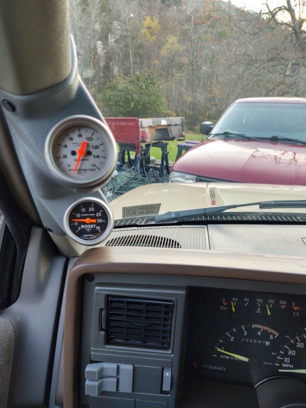

I thinks my gauges on the pillar are having issues! Both of them were along for the ride when I drove into an apple tree. Boost gauge bezel was bent from my hand flying off the wheel. Had to take it apart to rezero it. Pyrometer started getting wonky- usually fixed with a sharp rap. Last time I must have overdone it! It's mostly dead and the boost gauge shows 7psi with the engine off. New units on the way!
I was able to zero my boost gauge by pulling the bulb out and sticking a pick in there tweaking it a tiny bit. but mine was only off by about 1 psi. the boost gauge I have is a bosch one that shows -15 to +15lb. would be nice to be able to pull the face without destroying it and change the face. with a gauge isolator, one if these can be used as a fuel pressure gauge.
