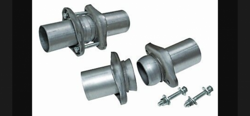

The end of down pipe and the one end of the intermediate pipe have what I call a ball flange. The rest are slip fit all the way to the end. It came like that from diamond eye
Then I guess you can't have the Intermediate pipe in backwards in that case, just rotated wrong! My Heartthrob is swedged end slip fit all the way back. What was cool, is I could order and pay for it a piece at a time, as I couldn't afford the whole kit at the time. So I bought just the down, Intermediate, a 45 elbow and two 4" clamps for about $135 and because I live in Lincoln, they were able to ship via Speedee for like $15. A couple of years later I ordered the muffler, axle pipe, tailpipe two more 4" and a 5" pipe clamp (to make the muffler body hanger with), but haven't installed those for two reasons. One, the Burb isn't roadable and two, I like the sound of my straight-piped side-dump exhaust, you can hear the GM-8 spool nicely with the topless K-47 airbox on it!
