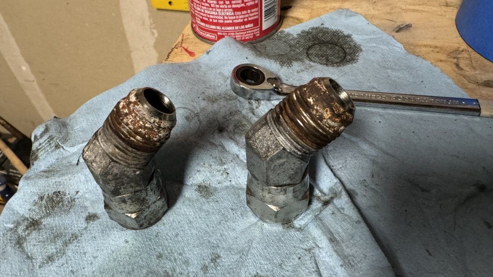

Removed the oil cooler and lines back to the block. Removed old 90* fitting from the feed or push side. 10-AN threads were corroded but not as bad as the 45* swivel ones on the front. At least the front ones were clean where they seated against the lines.
Seperating the lines from the connection with all that corrosion was a PIA. But, got it done.
Return side connector’s threads are clean so I left that in place for re-use.

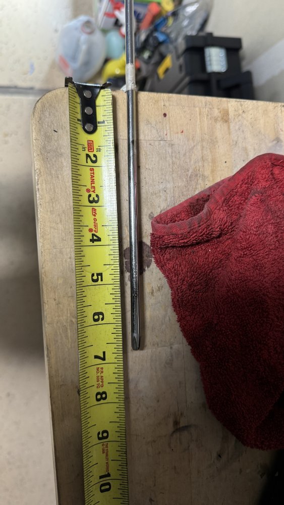

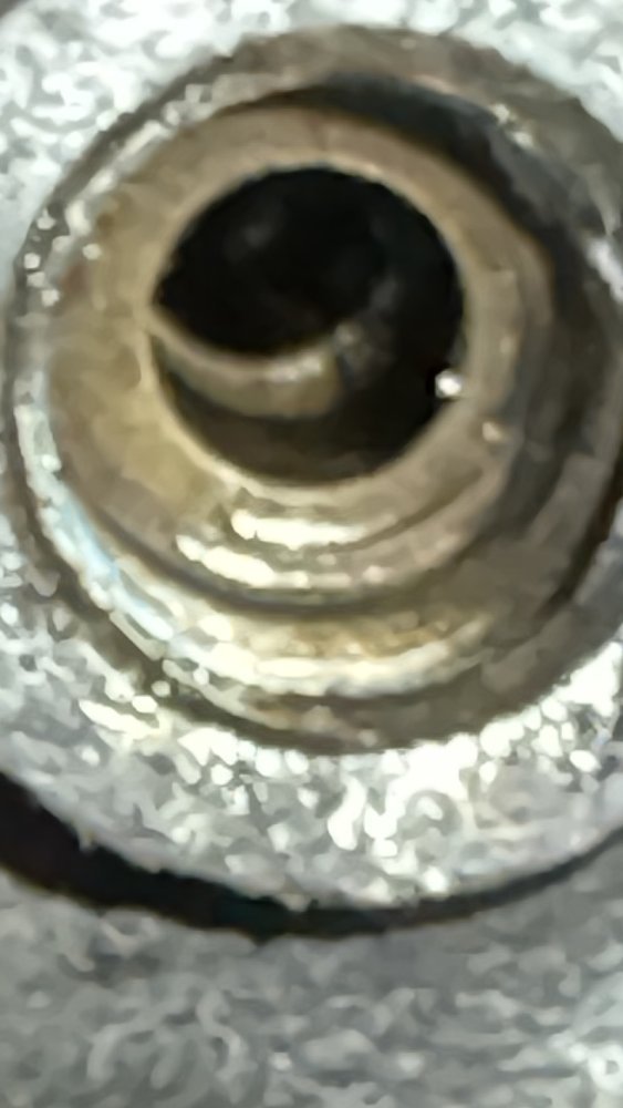

For my own education, I learned the feed / output side comes up from the pump, makes a 90* turn for 6.5” before exiting the block. What it ‘up the down staircase’ looks like…kinda.
No, the truck didn’t jump when I checked the output depth with the Phillips.
