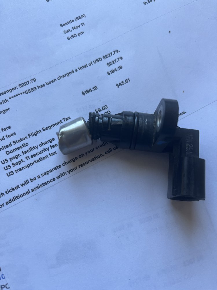

Yup. Suckfest.
‘Member that comment I had about the shop verifying stuff after building…
Let them give you the new sensor, and shims, and have them get you the instructions on proper shimming since they were supposed to have done it all.
Now also is the question about draining the oil to get out pieces parts of the sensor
Yup. Suckfest.
It came out intact, there are no pieces in transmission.

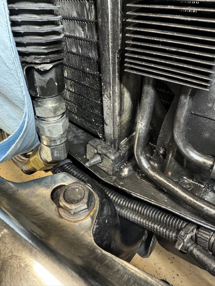

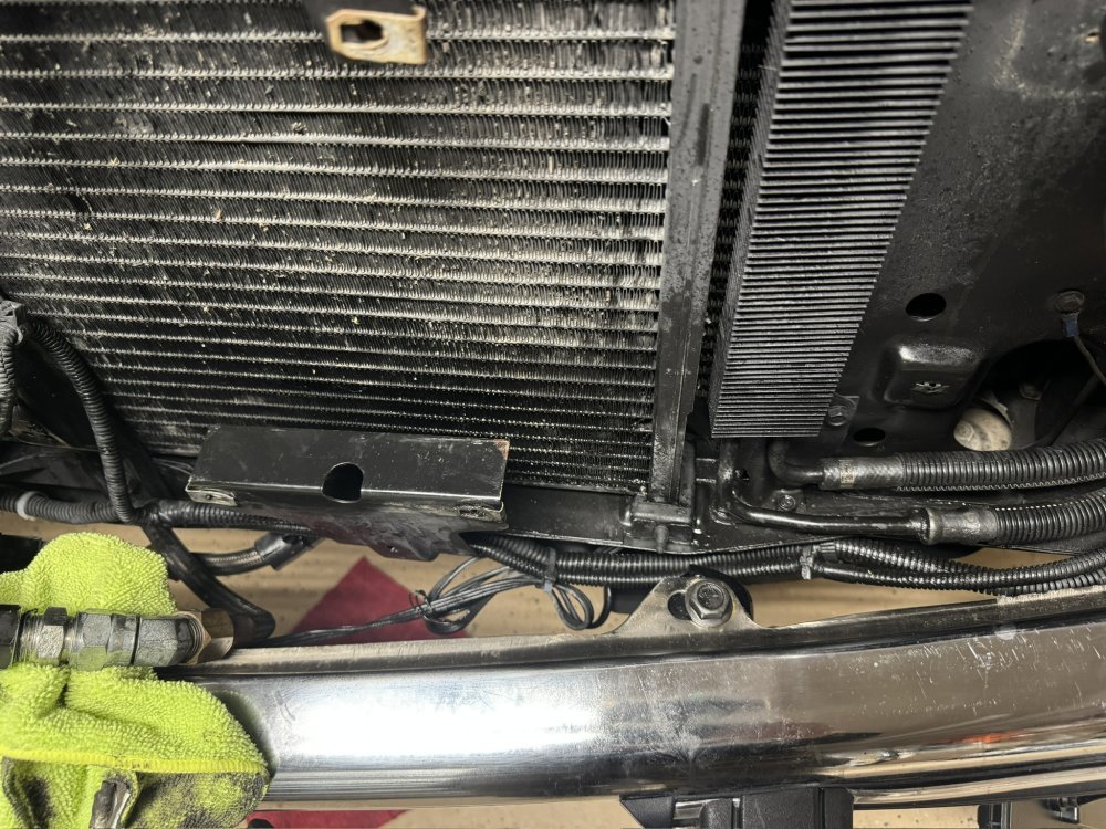

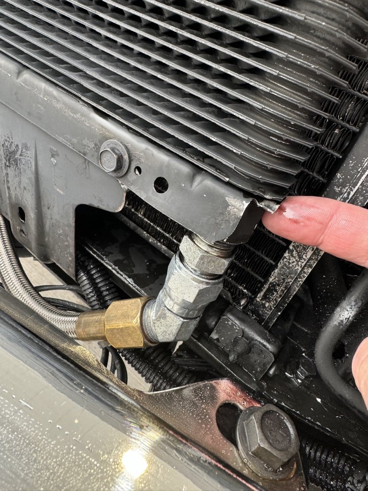

Oil Cooler unit is leaking. Got home and there was oil dripping off the bumper and core support. Huh?
Radiator was wet behind the cooler too.
IMG_8540.JPG I cleaned everything up as best I could with rags, brake cleaner and let the engine idle for about 20 min.
Of course, nothing leaked or even weeped. Thought it might be one of the 45* swivel fittings.
This morning I took the truck to the self-squirt-em-up car wash and finished cleaning with a heavy layer of Oven Cleaner and a good rinse. Still nothing but, by the time I got home I had evidence from above the 1/2" Female connection on the cooler.
Bought this set from Lubrication Specialists in 2007 and it has always had oil residue on that side. Out with the old, completely, and in with a new kit.

if you need to drive while waiting on the new cooler, you can get you a union and join the two hoses but drive cautiously. good catch while it's in the slow leak stage and it didn't just burst on you. that could have been an "Oh-Shi#" moment !!
