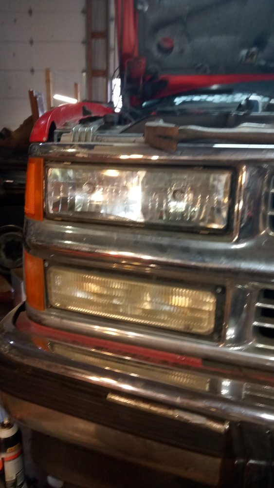

I got the quad rectangle, side by side system from a 1988 that had been taken to scrap for obummers cash for klunkers propaganda.Those 6x8" sealed beams shown are the Cheyenne trim level in '94. The Silverado trim level had the side by side individual sealed beams.
You used to be able to buy aftermarket replacements that used the replaceable H1 or H3 halogen capsules (as well as for the dual and quad sized round sealed beams) that could now easily be substituted with HID H1/H3 or LED H1/3 units for even higher lumen output than the 55W halogen capsule.
That system matched perfectly to the grill on the truck.
I sure do like this quad system over that rectangle single unit.
Dims are adjusted where an oncoming vehicle dont reauest to dim. The dims are hooked through a relay switch to stay on with the brights.
The brights are set for about ten miles and shows everything from fence line to fence line.
