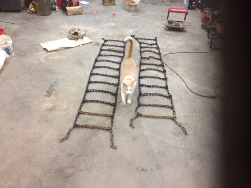

Two sets of heavy duty chains, both sets to short for the 185 tires, took the old set apart and added some cross links and some side links. Waiting for daylight to see if they are still too short. LOL
Aint going to try and pull the camper into some of those ponds without a good set of chains.
The inspector general is making sure they are right and proper. LOL
