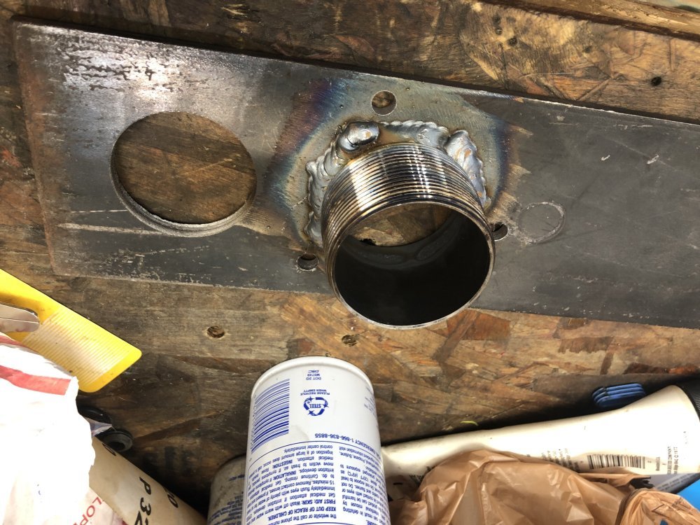

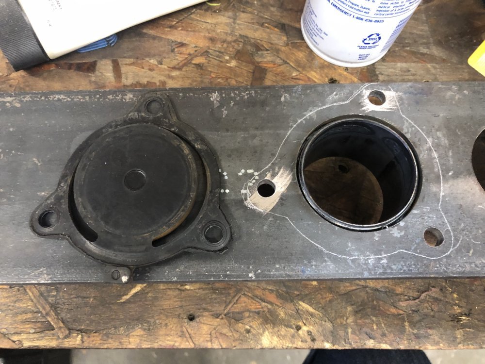

Someone before my son and I got reckless with the suction side hose and busted the fitting flange on the pump. The foot valve fits under this fitting. Someone packed off the flange to get it welded, shop said they couldnt weld it so he tossed the flange.
I took the foot valve and hope it is not distorted so that the home made flange wont fit.
Got it all put together but then the torch is out of oxygen so today will be another reason for the wife to bitch me out some more. An exchange bottle of oxygen onto the CC.
The flange drawn out on the flat, bolt holes drilled and the pipe nipple welded to it.

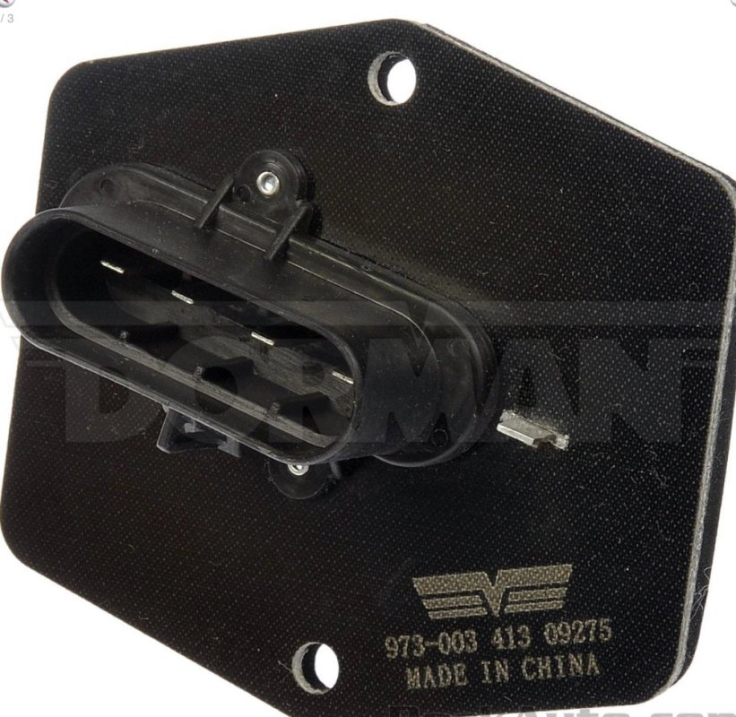

I went for the resistor. Schematics indicate that the HIGH setting circuit doesn't go through the resistor. Nope, with the new resistor the High function was dead too. I swapped out the HVAC Control Unit in the dash and that didn't solve things either.

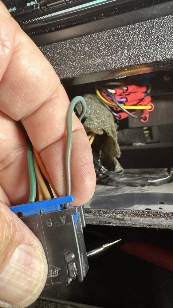

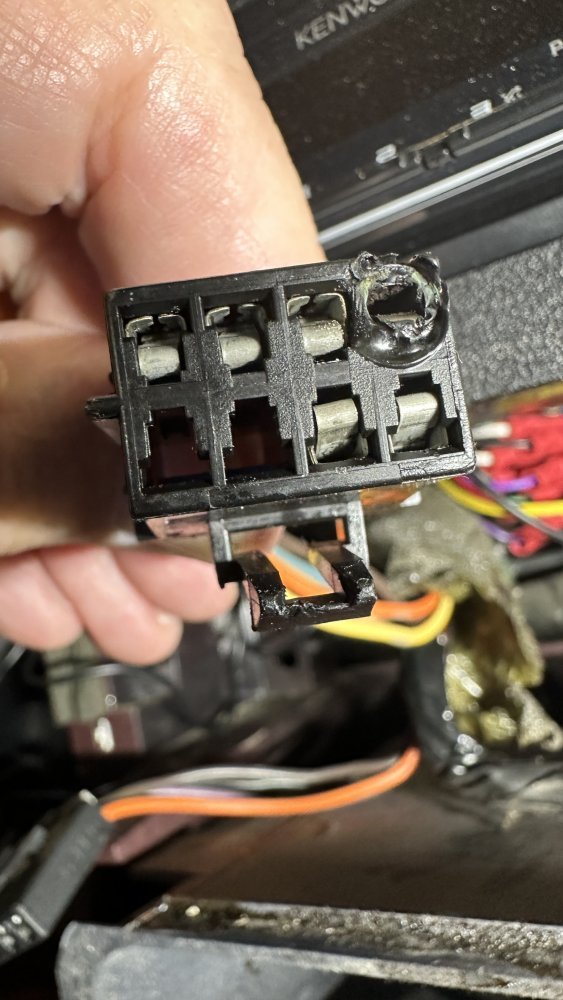

There is a insulated single spade connector inline from the blower motors main power lead up in the harness by the back side of the glove box. mine had melted. I ended up just cutting it out and soldering the wires together. not long after that my blower motor burned up. I guess all the years of not getting it's full power through crappy GM connections made it give up the ghost.
Blower switch connector is a bit cooked. The "Light Blue" wire isn't so much for a bit back from the connector.
Still, there’s no short between the A and B connections so that’s good news.
Checking continuity of the wires between the Blower Switch (Lt Bl, Yel, Tan) and the Resistor Connection test good despite the burned Switch connector.

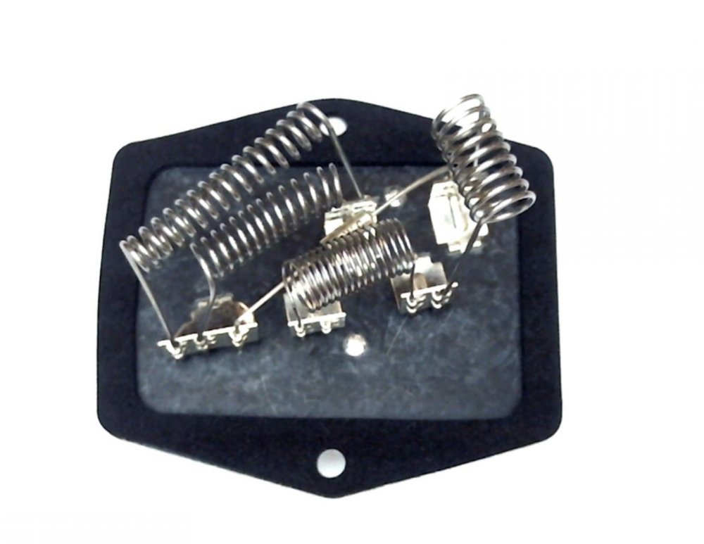

Checking the resistor’s resistance values and connectivity for both the old and new gave me mixed results and had a bit confused because connectivity at the pins on the front and resistance values for the coils were different. Which one correct? Not knowing (photo’s courtesy of RockAuto).
So I set the new resistor in place and hooked things up just for grins and giggles. Confidence was not high and I wasn’t disappointed because just as I remembered from before, there was absolutely no voltage getting to the blower motor. FWIW, my new resistor was out of the box from AC Delco.
I put the old one on and it was as before, only low and high. I did some further inspection of the old unit which is original to the truck and, honestly, looked cheaper. I noticed that it appeared two of the resistance coils were in contact which, given the nature of construction, didn’t seem like a big deal but, I separated them and tried things again.
SUCCESS! All speeds work. Even after reassembly everything is working fine. So, my original diagnostics were correct, I just had a bad out of the box part. I’m not even going to speculate how the OEM resistor went south with two coils coming in contact unless it was during the repair of the leaking Heater Coil and I bumped the resistor which is about 1/2. I don’t recall the blower motor’s issues showing up at that time but, who the $%^&* knows.

that melted connector is the reason I want to add additional relays for each fan speed. with only the high speed relay, the high speed is the only speed setting at which the current the blower is drawing is not being pulled through the fan switch. all the other speeds get loaded through the fan switch. the resistor is like a heating element that only reduces the current at the blower but together still pull a great deal through the contacts of the switch. I'm not positive but I think that one melted contact is the power in to the switch supplied from the ignition.
