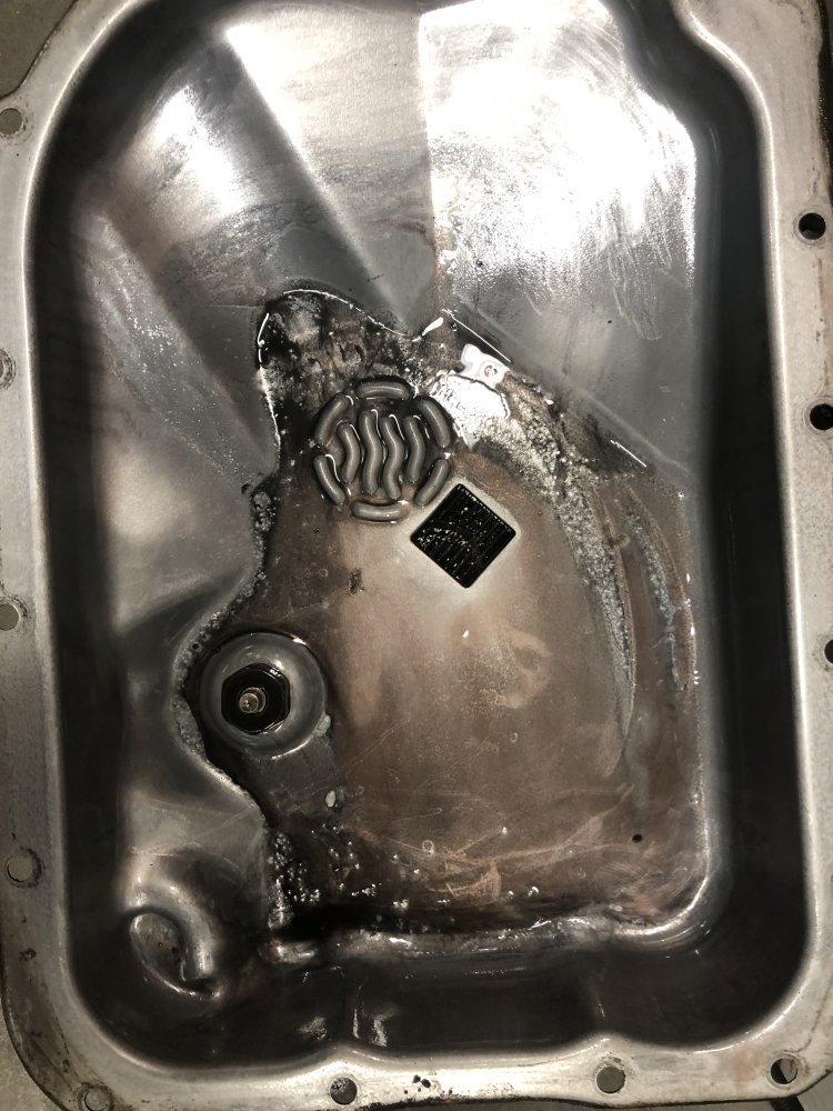

About 6000 miles on this fluid and filter change.
From the smell and color of the fluid, and the looks of the disk material, I’d say this transmission is getting close to needing a kit. 🤷‍♂️😧😹😹😹
No big buildup, just a kind of an even coating of black material.

How many miles on the transmission overall?
If it is original to the truck, it is next to 270,000.
I have not hauled any real heavy loads with it but I dont know about its previous owners.
It's close to being done. You'll know the pump is going when it has delayed movement in reverse, especially in really cold weather. My '99 was done at 235K miles, but it has done some heavy towing. Are you going to pull and rebuild it yourself?

Last winter it seemed to be a little slow to gather movement. I then thought, HHHHHhhhhhmmmm, this could be a sign of the times. 😖😧😢
Most likely will do that, rebuild. Cant afford to let someone else do it for Me.
What I dont have for tools I’ll buy or improvise.
Been a very long time since I rebuilt a transmission. That was a 700R4.
I was looking at kits yesterday evening. Seems a can delve into the next to $5,000.00 range depending on how good and how much for hard parts they want.
Mine looked something similar to that but the fluid was still nice n red. no known issues as of yet and I know the previous owner has done some towing with a 28' travel trailer. about to hit 294k and still seems fine. I would say start adding to your truck fund piggy bank and drive it till it gives up the ghost.
