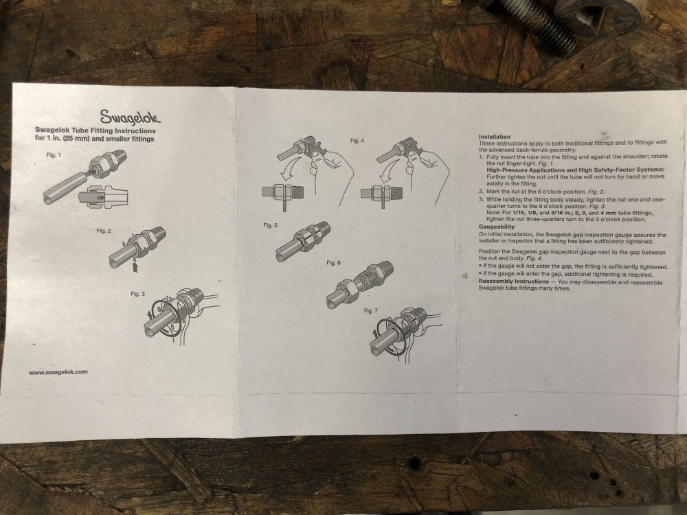

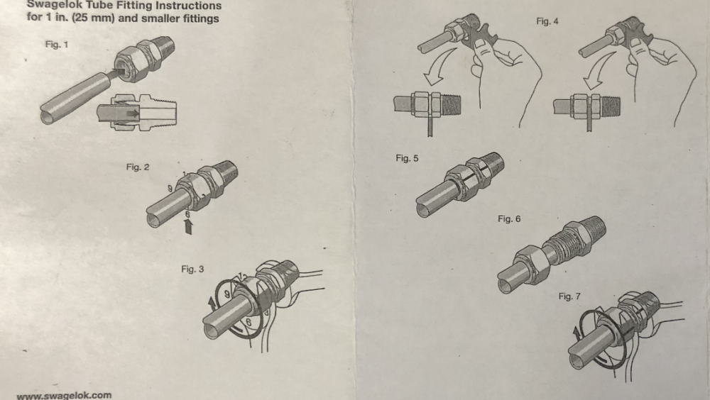

I got a swagelok 5/16ths ferrel to 1/4” pipe adapter.
When the fitting arrived, looked at the ferrel end and the hole is big enough for about a 3/8ths inch tube. I thought, WT Crap, they sent me the wrong fitting.
Then I look deeper into the ferrel end, ahhhh, the guide hole in deeper fits the 5/16ths inch tube.
These high pressure fittings has a heck of a mechanical ferrel system.

be careful with some of these type of fittings. they are all dependent on the OD of the tube to lock and hold the tube into the fitting. we have several of these types here at work all are classified on the OD of the tube but several tubes have different thicknesses for the ID to OD. this might throw a monkey wrench in the works of building an adapter for the tester.
Okay, I will be very careful. If it aint right, then it will be weld time. 😹😹😹
I was thinking in the rehlm of the factory injector line being a metric tube size. Naw GM wouldn't do that would they !! HAHA.
OD is 5/16ths. Not sure of ID, a lot smaller than standard tube. Injector tubes is thick walled, stainless steel too I think. I cut one with a Ridgid brand tubing cutter, going at it slow and gentle like, took quite a while to get cut through it.
I did fit the end of the cut tube into that ferrel adapter fitting and it was a nice fit. Guess I’ll find out when I start compressing it down.
