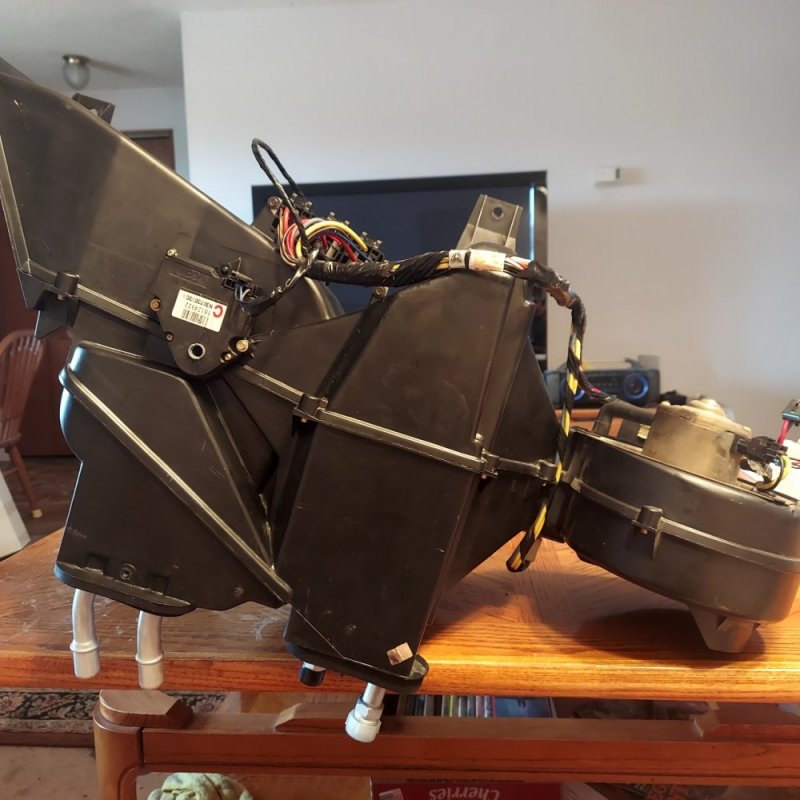

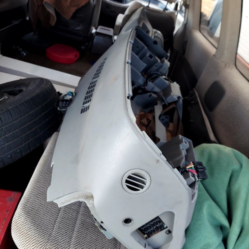

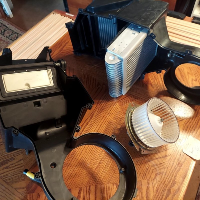

Pulled a nice crack free dash from junkyard yesterday. Day before, I got my rear HVAC box all cleaned up and ready to go back in the burb with new hearer core and ac evaporator. Picked AC manifold gauges from harbor freight - on sale.
Will be working on the front HVAC tonight.

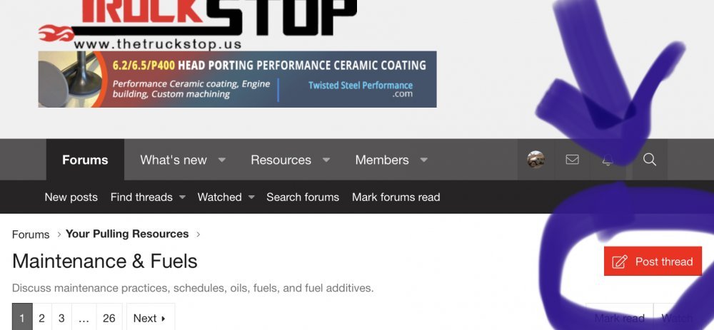

I know that what I have been posting about injectors should be in a thread of its own. I wanted to create a thread but for some reason could not find a create new thread link while searching from My phone.
My computer completely died and so posting a new thread from there is not an option.
If one of the moderators wants to take all the posts and replies and put those in its own thread it would be appreciated, GREATLY.
@MrMarty51
Under heading “Your pulling resources” is “Maintenance & Fuels”. Click that and you will see on the right side in a red box that says “post thread”
I circled it with purple to make it stand out in picture.
Just click it and you’re good.
If a moderator can’t actually move your posts, you can “quote” them and add one at a time, or use copy/paste.
That’s a unicorn in the junkyards of Southern California as most die of front end wrecks.

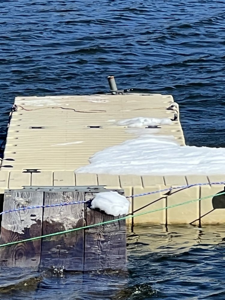

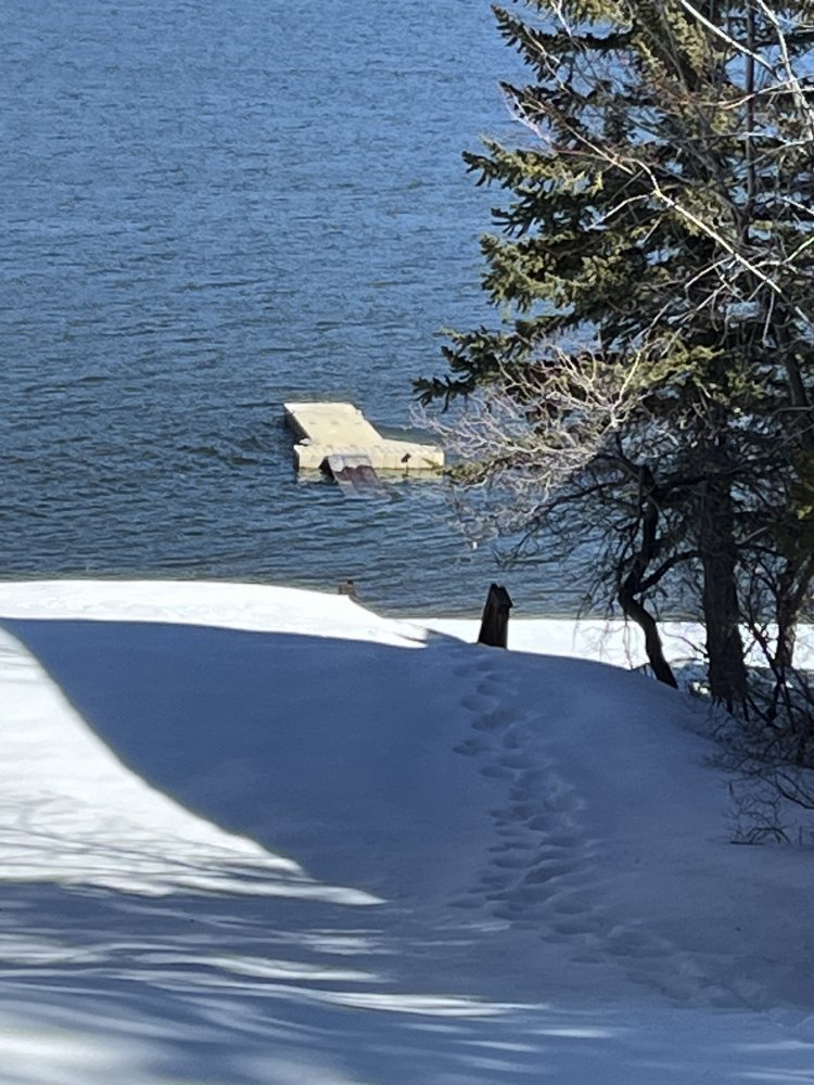

Drove the ‘94 Suburban up to Big Bear Lake and back to check on the dock. Clocked 198 miles roundtrip with no issues. Took the front route 330 up. On the steep stretch from the Ranger Station to Running Springs, the temp stayed on the cold side of the 210 tick and would drop back down after I got out of it. Overall, the truck runs pretty damn good. It needs a new set of tires as they are dated 2014 and the side walls are cracking. This was due to it sitting for 3+ years. Looks like there’s about 15K miles left on the tread.
Was up there to move the dock but was unable to do so as it’s still being held by the pole. Top of pole is now in line with the top of the dock. Looks like the water rose about 8” from last Tuesday (first pic). It should clear the top of the pole in a little over a week. I purchased two 1.5” OD x 10’ galvanized pipes, plus two dock augers that attached to the poles and screw down into the lake bed. I set one pole to the east and tied off a dock line to it. Now it will be trapped between the neighbor’s dock and that pole. I’ll keep an eye on the water level as they measure and post it on Mondays. Can’t get down to the bottom of the drive with the truck as it’s not cleared. Upper part is cleared to one lane and the berms are overhead in spots.195B9165-AC84-4641-993B-D064EDC8CA60.jpeg30C5FA50-97ED-4987-9A31-702E00ED56B2.jpegon Mondays.
