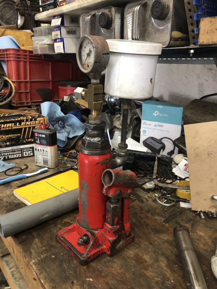

I would not install any injectors without being testing and balanced.Not sure what to do about injectors. Leroy said to install and run them.
I know that one of them is popping at about 2500 PSI so that means I would need to go get the tester back and go through them, grab out that one and reshim it so it pops in that 2300 PSI range like the rest of them.![]()
Agreed. maybe contact Rockabillyrat about it or send the set to him. is there a local diesel shop in your area you could stop in to chat with one of the techs?I would not install any injectors without being testing and balanced.
I would think installing that injector would be asking for trouble.
It might not show up for a while.

I mailed mine off to a place in Michigan. Somebody here recommended them years ago.Agreed. maybe contact Rockabillyrat about it or send the set to him. is there a local diesel shop in your area you could stop in to chat with one of the techs?
Can you do a video of how you are testing?
When you pump the handle it should be fast like a punch from Sugar Ray Leonard.
If you are easing into it- that will give you false results.

Was easing into it. Probably wrong.Can you do a video of how you are testing?
Pretty sure Mercedes Source had some good videos of “how to”

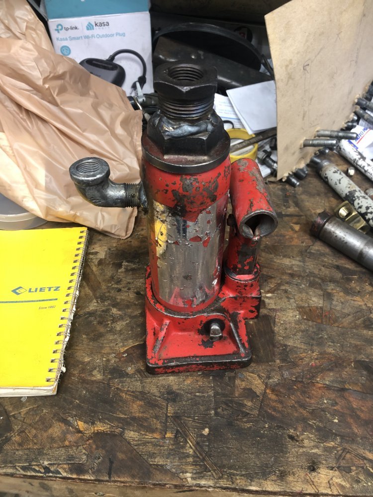

good ideas. After the weld cooled I did seal it inside with JB weld.@MrMarty51 me careful welding a reducer to the top of the jack without it being threaded some into the hole. I have been told one can use a 1" pipe tap to lay some threads into the top of the bottle jack to help secure the reducer into it before welding. last thing you want is that thing blowing off while under high pressure.
I'd also wrap the welded area with some sort of covering like heavy rags so that if a pin hole develops it won't spray inject diesel into your skin or eyes.
Is it possible to move it all over to there ?We should have all this conversation in the “fuel section”
Oh yes they are. That I shall do.@MrMarty51 are those brass fittings at the top of your newely build tester? if so, that will not hold up to the pressures! get you some schedule 80 steel fittings. we have seen them explode under pressures below 3k.
