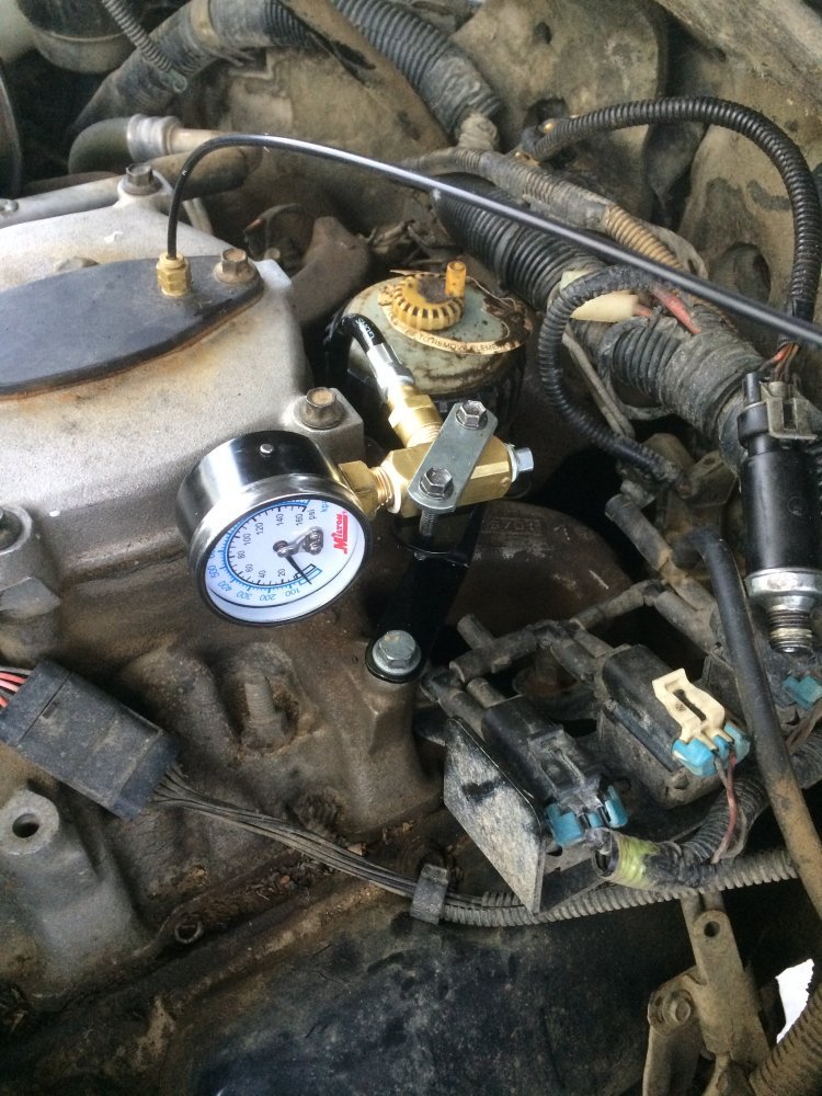

My engine in my truck doesn't have that oil port in the valley, only the boss. iirc there isn't the two burn-out marks ether, only the dotted round mark.
interestingly the 6.2 I have on the stand only has one oil port in the same location as my engine. it has a tee where the sensor and a line is connected that reaches over to the turbo too
