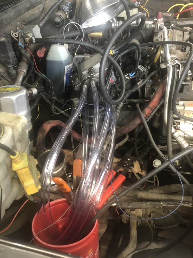

Setting up to pump some jack oil through the reman injection pump. Long as I have the intake manifold off the engine it gives more room for a place to rest the spare IP, hook all the wires to it. Using a spare lift pump, poke a hose into a jug of jack oil, hook the out end of the hose to the IP, when I get it all set, turn on the ignition switch then spin the IP shaft by hand until jack oil emits from all 8 outlets on the pressure feed fittings.

He left and I cut two footer pieces of clear tube and shoved them over the nipples. Next step is I’ll disconnect the lift pump, dont want unwanted fuel running out the return hoses thats all disconnected.
Then stuff the hose of the spare pump into the jug of JO then on with the ignition switch, oh no, forgot to hook up the battery cables. 😹😹😹😹
Okay, that all will take place tomorrow.
A pic of how it all sets for now.
All is hooked up.
Cranking the injection pump shaft in a counter clock wise direction, ignition switch on. Temporary lift pump connected to the battery. It has oil to the IP and nothing coming through. Not even the by pass fitting/hose.
Probably going to have to plug the oil sender bore, hook the oil sender to the air pressure, plug the turbo feed hose and then with the ign switch in run, crank over the engine.
With the injectors and GPs removed, should not be much of a strain on the starter. Give it its 30 seconds of crank time then a real nice cool down spell. Repeat until oil flows from the IP.
While I am at it and have the intake removed, going to have NAPA build me a 1/4” hydraulic hose and remote fit the oil pressure sending unit.
