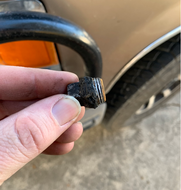

Finally got out there today and installed the temp gauge in the rear passenger side head port.   found out the threads were galded up, the plug was just barely in there.   didn't have a 3/8" pipe tap nor did anyone in town have one.   ended up finessing a brass 3/8 to 1/8 reducer in the block and made it work for now.   I will have to get back in there and re-thread the port in the head sometime soon.
