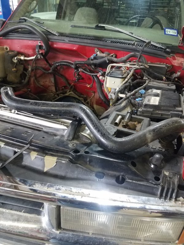

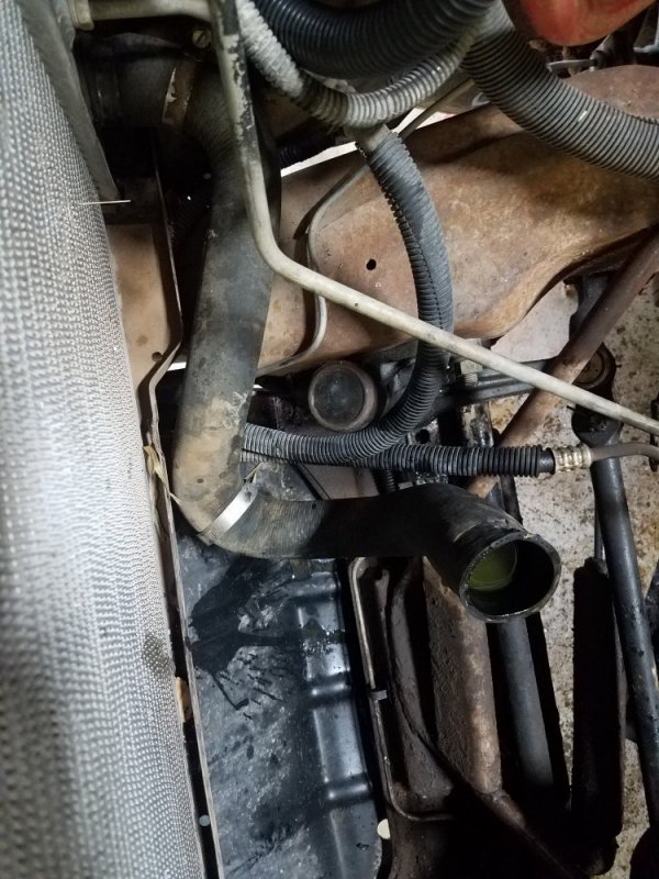

There is not a factory oil cooler on this truck, how hard would it be to add? There is an ac pusher fan and trans cooler so there is not the same space a 6.5 has for the cooler to mount

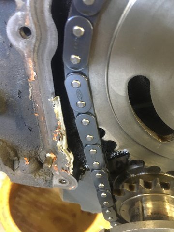

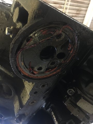

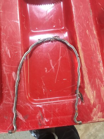

Dang man. Don’t people understand- if it squishes out the outside, that means it is squishing to the inside. And if they don’t know how much to use- assemble and take apart to see what it did and adjust the quantity. Doesn’t seem like a hard concept to me...
Or better yet.... Buy a new seal kit so you aren't having to fill the gap from the original 150k mile 20yr old seal.
And what kind of so called professional uses that orange/red junk. Right stuff is cheap and easy to use.

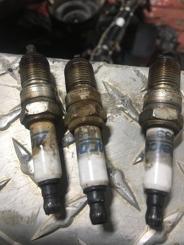

I ended up inspecting my distributor and just going with a cap and rotor. The mechanic told me there was rust in the "distibutor". After I showed up to look he said it was just in the ports on the cap where the plug wires hooked up, he also showed me where the plug wire connection had been pulled on and off enough times to not have any seals or clips in 6 of the 8. The plugs weren't "fouled" but they were pretty dirty with alot of carbon for a 7k mile motor.
I actually ordered the marine cap and rotor kit, 8.5mm wires, and new plugs.
It's your engine/money, but there is no way in HE!! I would put a plastic distributor back in a new engine. Those things should be replaced with age because of the plastic getting brittle. Lost track of how many misfires I've seen on those from the cap screws coming loose because the plastic breaks.
I am putting a marine cap and rotor on a distributor the shop had laying around, said it had been sitting a couple years with around 5k on it before the guy wanted an ls swap.
