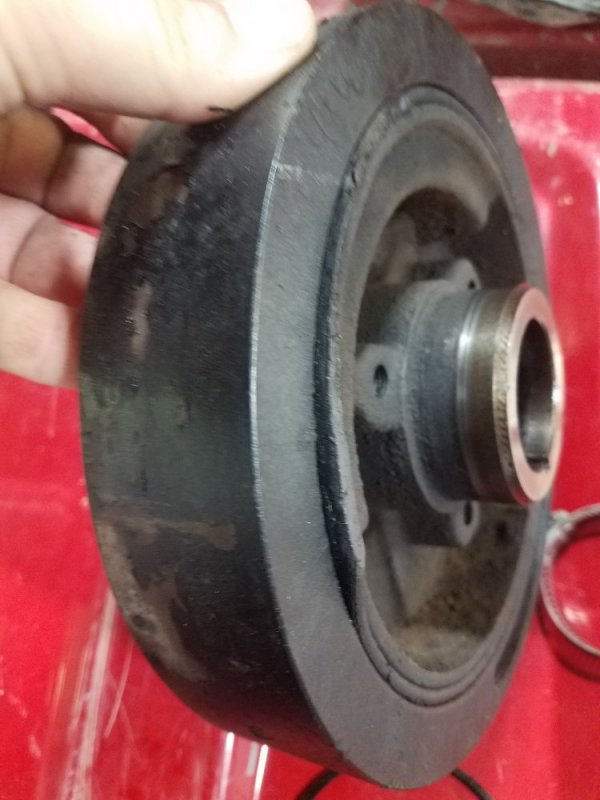

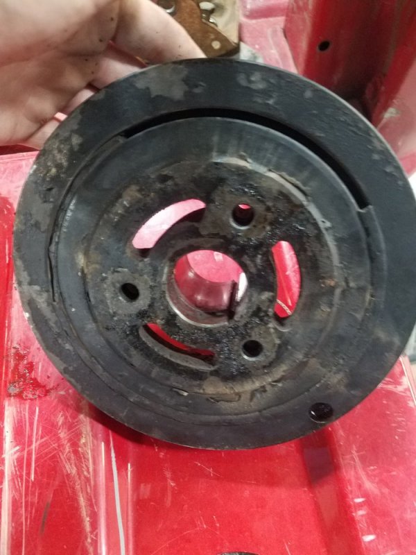

Looking at my harmonic balancer it is for sure trash. Should I go ac delco or is there something like a fluid dampner that would smooth the big beast out?
Having the rotating assembly —crank rods pistons, rings, with balancer and flywheel, bearings: this is usually $250-$300. There are few engines it doesn’t help and the heavier the components the more it helps.
Many people choose machine cost and do a stock balancer over the cost of something like fluidampr, ati, etc. then later if money butns hole in yer pocket, upgrade.
The cheapy balancers like doorman suck across the board, not just the 6.5 so avoid them.
A balnced assembly and stock balancer beats stock assemby and upgraded balancer 90% of the time.

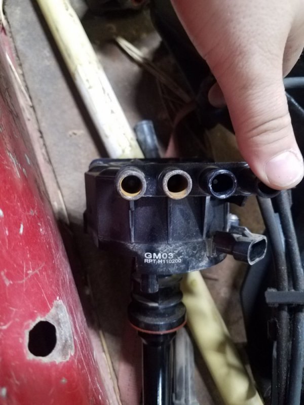

Avoid the plastic distributors at all cost. Rockauto has a couple of aluminum replacement options, ebay has dozens of them, and eficonnection sells a nice billet piece. For plug wires, ac delco is normally good, just try and find a set of 8mm. As to cap and rotor, I normally picked up the marine caps with brass inserts. They were made of a very dark blue material.
I ended up inspecting my distributor and just going with a cap and rotor. The mechanic told me there was rust in the "distibutor". After I showed up to look he said it was just in the ports on the cap where the plug wires hooked up, he also showed me where the plug wire connection had been pulled on and off enough times to not have any seals or clips in 6 of the 8. The plugs weren't "fouled" but they were pretty dirty with alot of carbon for a 7k mile motor.
I actually ordered the marine cap and rotor kit, 8.5mm wires, and new plugs.
Also found out that all the "new" hoses, sensors, and water pump were all oem GM marked and likely original. Called the PO who had the receipt in hand, he had to "make a call" after a brief description of what I had found.
