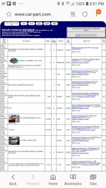

I found a 95 tbi 454 with 78k miles forsale, would that bottom end work with my vortec heads and a cam?
If you get a low mileage drop in maybe it has a good intake that you need. As you are going to swap cams a reman isn't a good value as it could be. Warranty concerns for major mods like that on a reman.

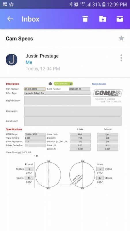

I just want a stock engine with upgraded springs, cam, new injectors, headers, and a tuned 411 ecm.

You can upgrade the cam and increase fueling without porting heads. Didn’t mean to make it like you have to, it just helps and is usually a good diy for 1 days work and under $100 for extra torque and hp.
I'm out of the loop on 454 stuff. I've never messed with one and honestly know little to nothing about them. As to cams, COMP CAMS has never steered me wrong. Call em up, tell them exactly what you have, what you want, and they've normally got something that will work. I would be cafefull picking a cam. If the big block is anything like the vortec sbc, cam swaps almost always require head work to accomodate the added lift.

Here is a neat article the justify your plan that touches on the ugh retard cam used...
http://www.trucktrend.com/how-to/engine/0512st-1996-chevy-dually-cylinder-heads-roller-cam/
