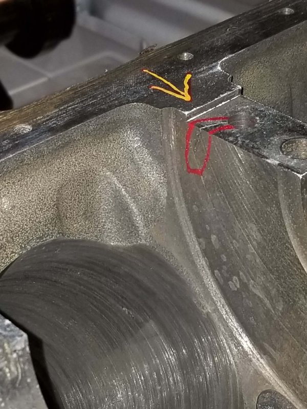

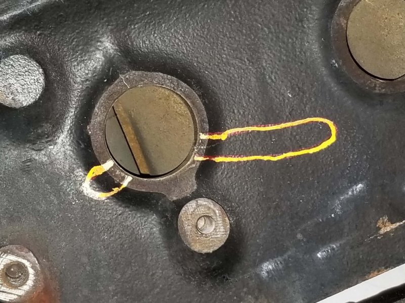

When it rains it pours. I just got the block back from the machine shop and they found 3 cracks. The dismantler that I bought it from gave me a 6 month warranty. Here is where the fun begins.
Hate to hear that man. Hopefully the supplier won’t give you a hard time on a replacement
Curious as to where the cracks were?
Welcome to ZombieLand where 6.5 engines don't know they are scrap till someone goes looking for cracks.
Be interesting to see the next engine torn down.

Have y’all seen many of these 6.x’s crack near the freeze plugs? I believe that’s the first for me.
Well obviously would hope they just get you a new one.
Or a couple bandaids, and it’ll be fine!
Or take it back. I talked to someone there yesterday but kept getting cut off since he was out in the yard. I'm going there this morning. We'll see. Luckily I bought it with my Visa so if they won't honor it I will put in a claim with them and let them go after them. Hopefully it wont come to that.
Cracking around a freeze plug indicates freezing coolant...
Yup. 100% agree that is what happend here.
