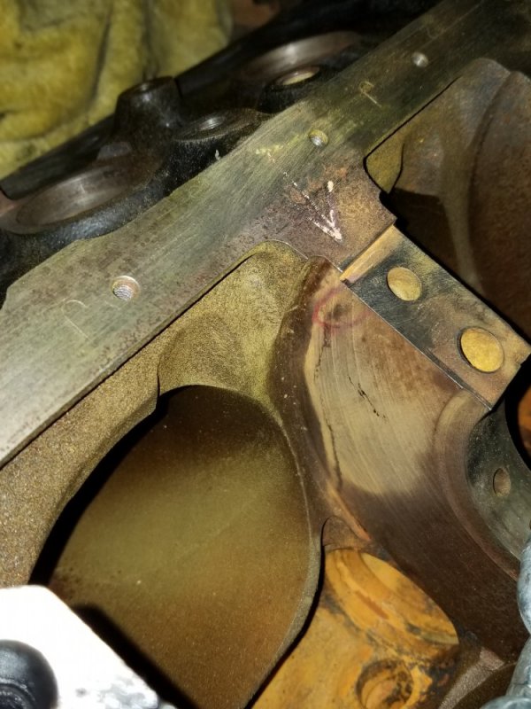

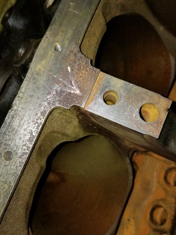

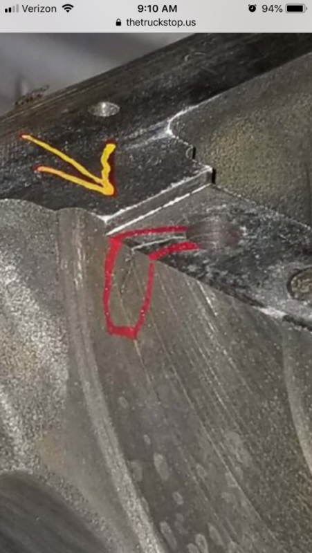

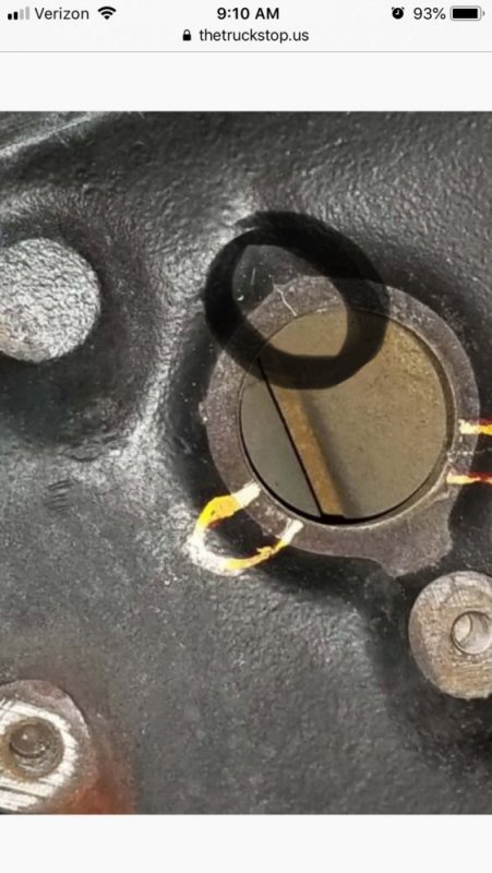

They should have fixed the main- it is into the bolt hole! I zoomed in on your picture.
Also did they fix the crack above the 2 you had circled or is that a picture anomaly? Circled in black-
Full stud kit for ALL the mains. The tie together girdles are a ‘may’ help. All stud DO help.
So does balancing the rotating assembly.
Post pics of what they did...

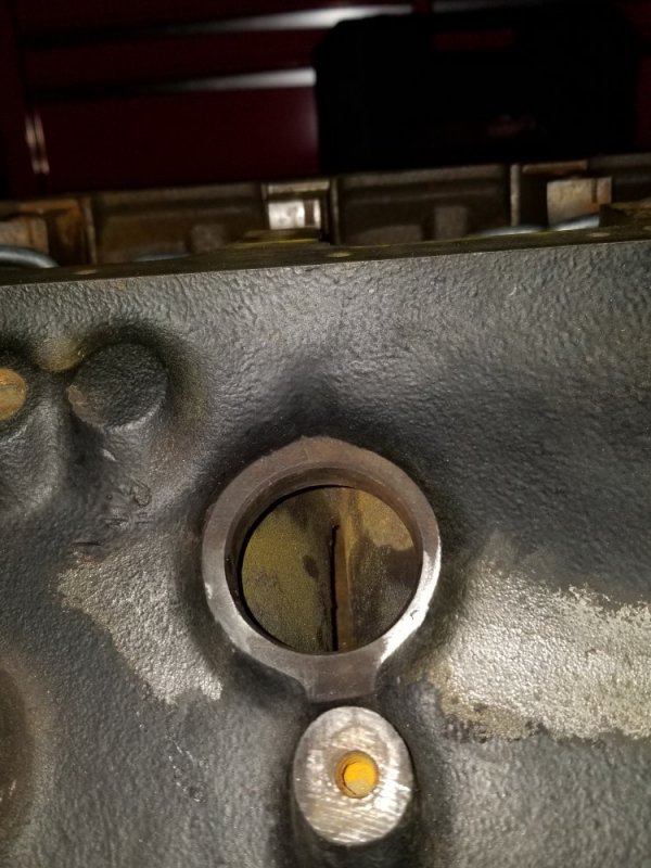

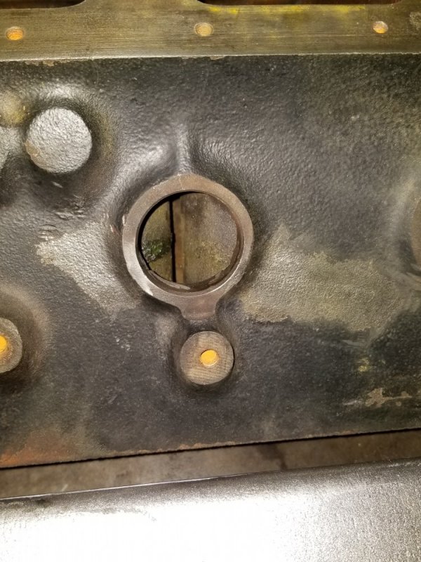

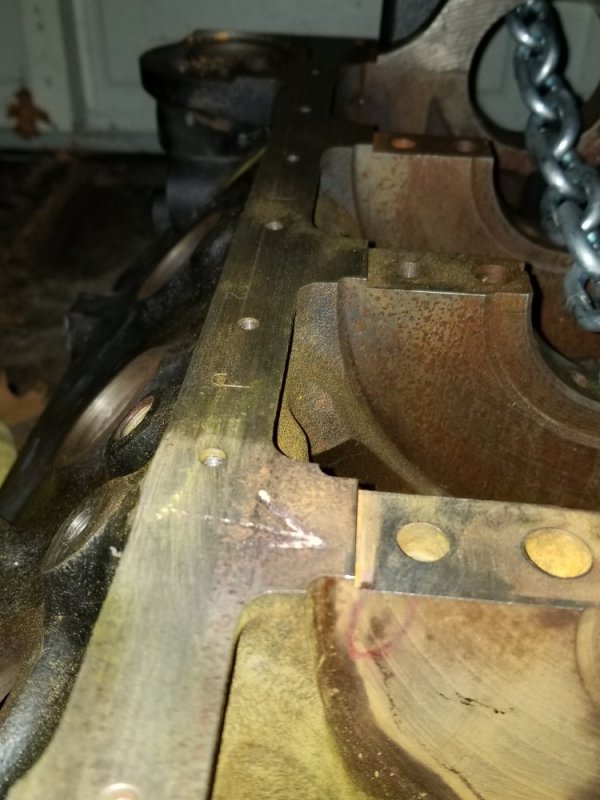

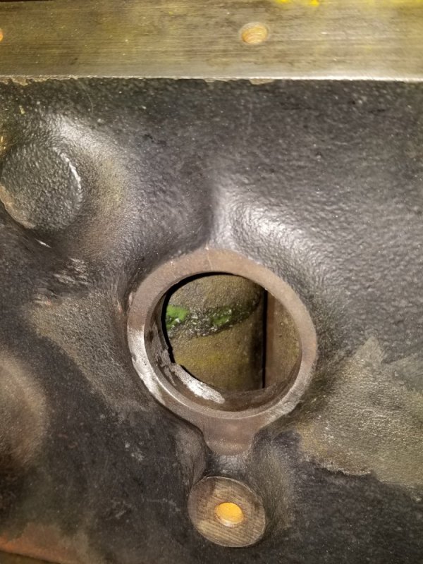

Here are the after pics. The rust is from the idiot auto recycler. They left it in the rain when I left it for inspection. The crack at the 12 o'clock position doesn't appear to be a crack but a scratch. It is on the surface and doesn't go down into the hole.
