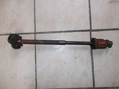

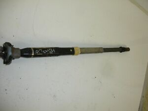

The rag joint on my 93 is sloppy and in need of some TLC. I have a good one I took out of my 95 but I found it was different. on the 93 there is another joint of some sort further up on the column under the hood, not sure what it's about, but on the 95 there is only a slip fit tubing with a bolt through to attach the shaft.
What is this other joint on the 93?

I guess the difference on my two trucks is the 93 would use the two joints where the 95 only has one. here is what the two factory ones look like
1993
1995

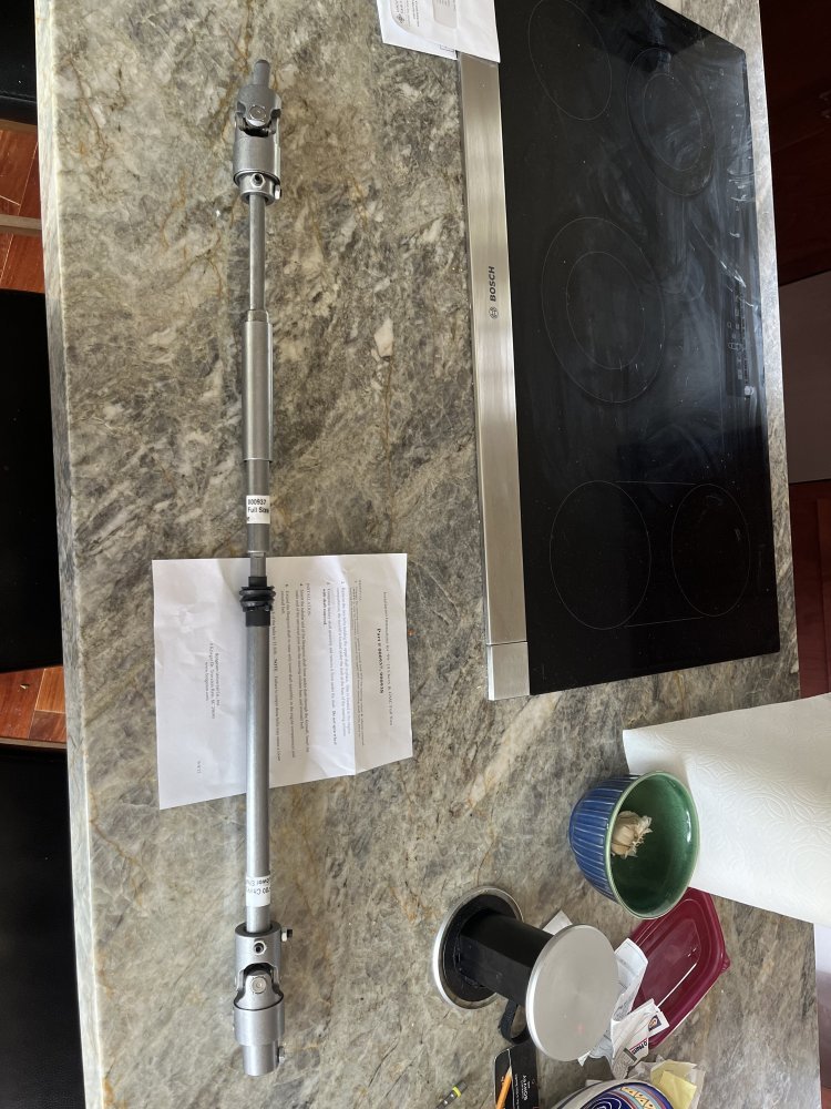

Today I'm installing a new edelmann box, a new pitman arm, a new inner tie rod end as the TTX one failed after just a few thousand miles,and a new power steering pump, and a new hose. Need to have it all done by Monday morning.
I would have thought those would last forever as long as they didn't get rusted up from sitting.
It's not like it's spinning like a cv joint.
It should last just as many revolutions

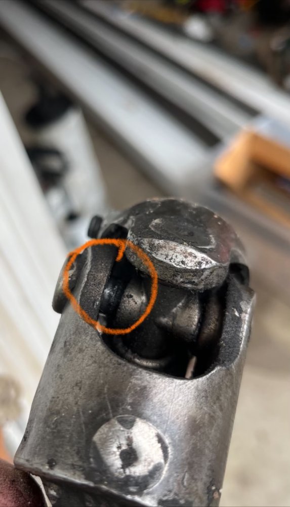

I put that steering shaft in September 2021 (post #1286):
Clearly did not last. Now I know what the clunking sound was when I turned the wheels full in either direction. At least the Borgeson unit I just installed has a 5 year warranty.
So the ujoint failed, not the shaft. Ok.
Yes- normally a ujoint not getting lubed there would run for half dozen years before giving up in steering shafts. Unjoint manufacturer most likely had a assembly line error in bearing production or something.
Like when sealed ujoints fail in pickups during warranty period- it happens but usually in a batch from bad needle bearings.
Can you see the new one? Is a brand of that ujoint visible? Is it greaseable? To bad the first one wasn’t- I’m sure it would have made it longer than the truck.
