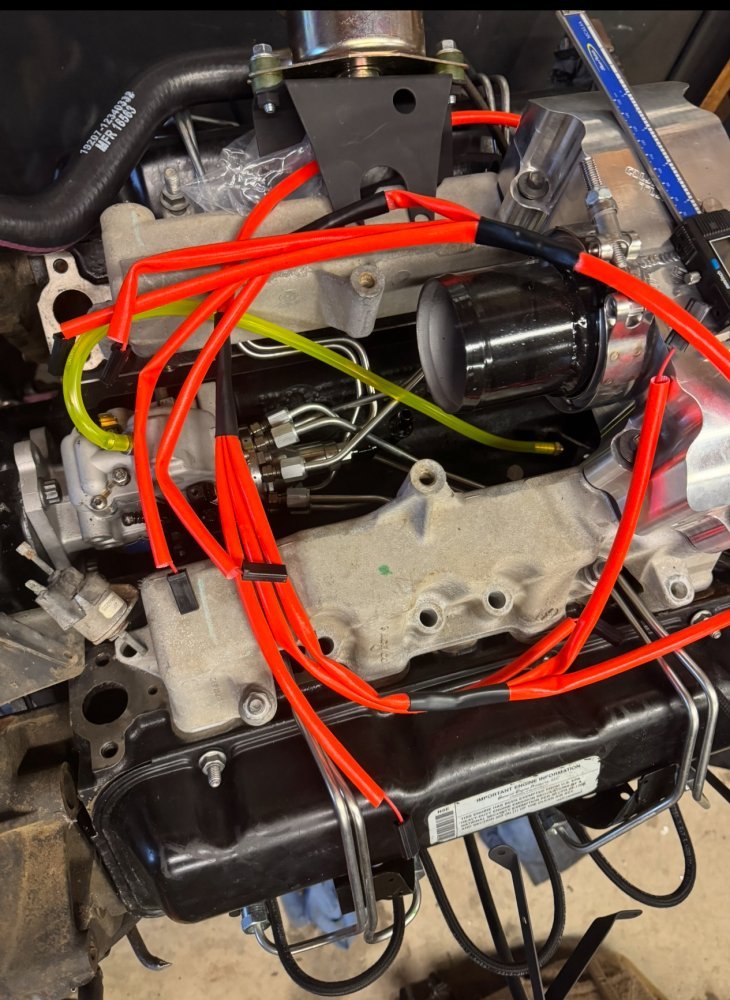

Although on my 93, there is a lot of room directly behind the intake, kind of a recessed area in the firewall. anyone have any pics of a center mount setup in a truck?
Here’s a pic of my motor with center mount intake manifolds Quadstar custom intake. Going to use a side mount turbo with twin scroll exhaust flange and t4 turbo. Hopefully I can get the custom exhaust manifolds built by the end of next weekend. It will be left and right bank divided all the way. 1-3/4” primaries to 3” log and 3” crossover.
3" crossover is HUGE. gonna loose a lot of velocity. I wouldn't go over 2.5 personally.
On the van/hummer/hmmwv intake: Did he flow bench it to correct the bad cylinder? I can’t remember which it is off hand but one flows horribly less than the others. The center piece he made looks nice. Normally I would agree with Rockabillyrat on the size- but the center section is insanely bad and small for the gm6 turbo. The opening to the logs and actual log size in these intakes is huge so getting volume flowing from the beginning is probably better to try keeping from having a major pressure differential.
After sending mine in for flow testing and hearing the numbers, I eliminated the option of using it. Either a set of “header” style intake or true log is the only way I was gonna run that design. I went with the truck style heads and intake instead. But if he figured out fixing the flow issue - that’s great news for everyone else still running that intake that starts pushing for bigger power.
If he didn’t look into that or address it- just know that there is some
Power left on the table you can work on. If you are happy with how it runs then don’t worry- every van, turbo hummer and turbo hmmwv are dealing with it. And bumping to a better turbo will help tremendously.
Please post more pics and use the full size instead of thumbnail. That piece looks awesome!

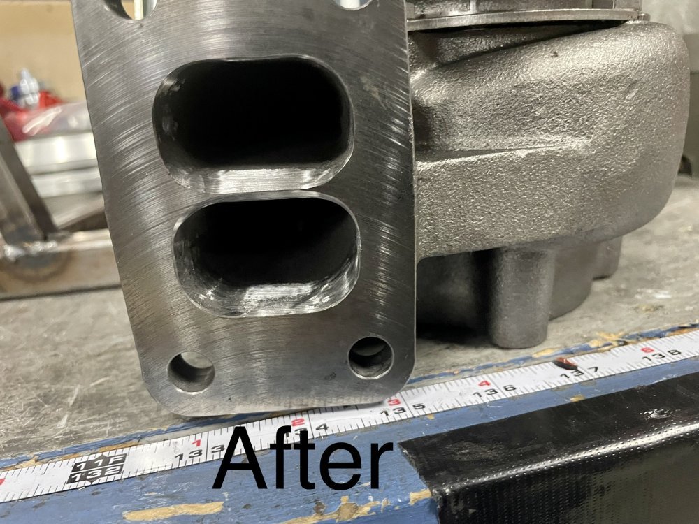

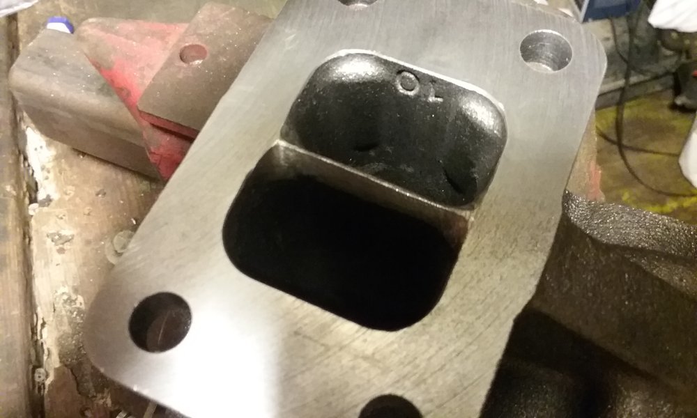

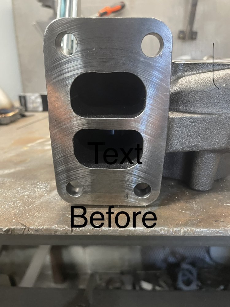

I do quite a bit of work on the divider on my turbos and it increases flow on top quite a bit
