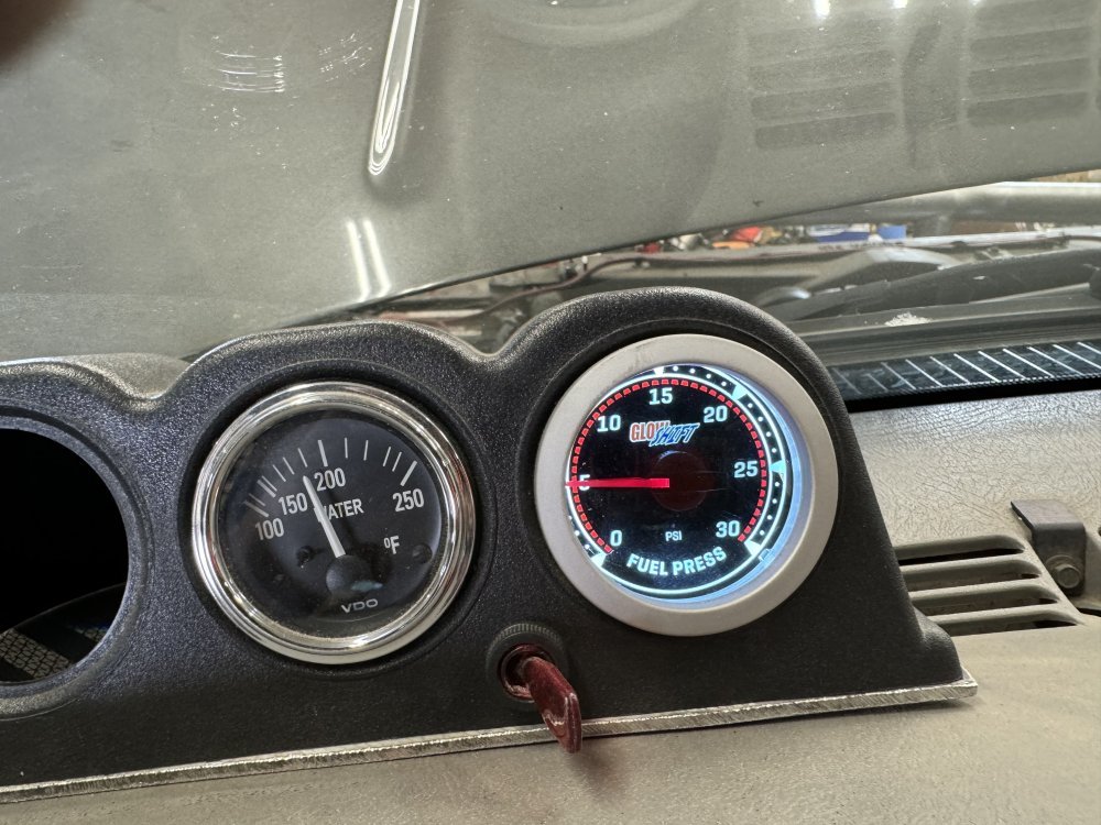

First ten minutes the fuel pressure gauge was steady at 6 PSI.
When I first installed this pump/relay system pressure was at 9’under a load.

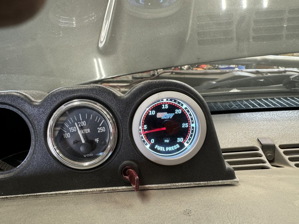

Pretty soon the gauge began to fluctuate, between five and six. A little more time and the gauge began to swing even more radically and falling off.
And then dropping lower.

When the switch lights up is when the AC is turned on, when the pressure goes way low is when the HVAC blower gets engaged.
Turn it all off and the FP goes back up to five or above.

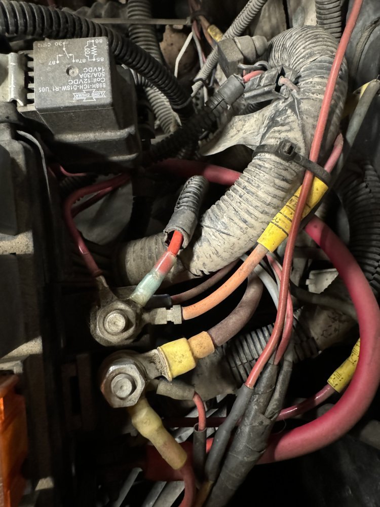

Power for the pump relay is direct off one of the battery terminal lugs on the rearward side of the underhood fuse/relay box.
I’ll getta pic of that tomorrow.

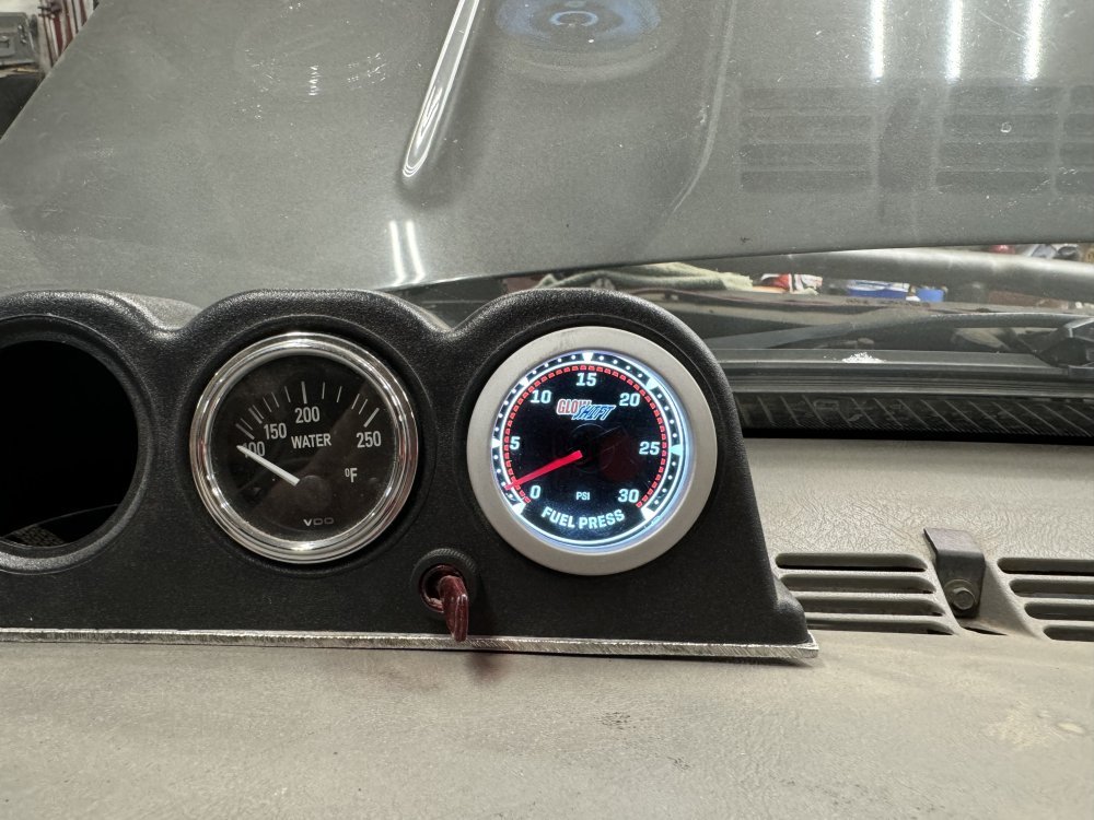

Carter lift pump is making pretty loud noises.
Engine not running, key on to activate gauge, everything turned off except the LP bypass air bleed switch.
I’m not certain that the LP is the problem but when it was initially installed it was running right at, or about ten or more pounds.

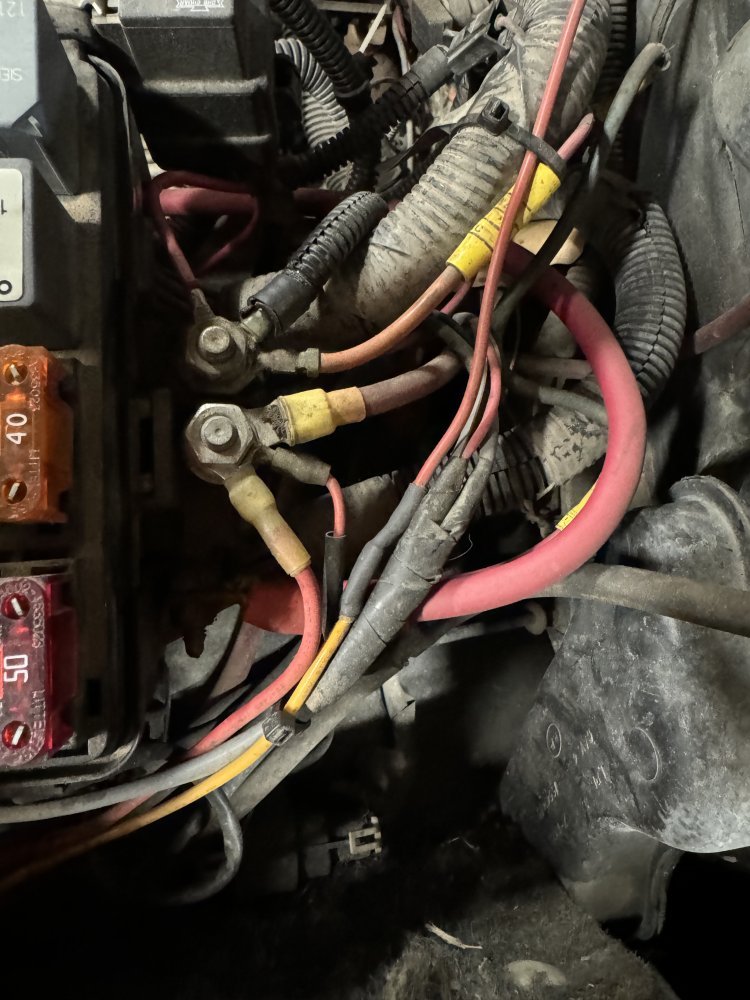

Brightest red wire is the LP relay system main feed wire. It must be a ten or at least a twelve gauge.
Large red wire is the feed from the battery posts.
Marty, am I looking at the two posts that reside on the back side of the under hood fuse box? those two posts provide power from the two MAXI fuses in the box. they are both on separate fuses that should be labeled AUX1 and 2.
this might be your issue. this fuse box is supplied power from a 10gwg wire that comes from the captains side battery which is barely enough to run the existing items it supplies. adding a wire from the battery to one of these posts and using a 60a fuse might help some but the contact pins within the under side of this box are also thin and small. It looks like there is too much connected to both of the aux studs.
on my 95 truck I have used a amp clamp on the wire that supplies power to this entire box and when the engine is running with the AC there was a 40+ amp draw on this wire! adding the fuel pump would increase this to around 50amps. there should be a fusable link within the wire at the battery that goes to this box. on mine it was getting quite warm with everything running. I did run an extra wire from the back of my alternator to one of the aux posts and installed a 50 amp fuse there which did help but not much.
What you need is a bus bar like the older trucks used that was mounted up on the firewall. use a 6 or 8awg wire and a re-settable breaker like is used for running a hot wire to a car stereo amp to this bus bar. Then move all those extra wires from those two studs over to the new bus bar.
