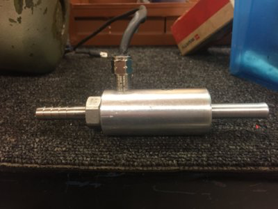

The first and most important mission was to install this beauty that my multi talented welder friend made for me in order to get both a temperature probe and a pressure sensor into the fuel line:

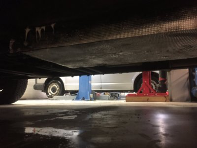

Since the car was staying inside, I also took my time to insulate the wvo tank hoping that it will have a happier life in the winter. I just used a 8mm foam sheet made to sit on in the snow, but I´m hoping it will do me something good:

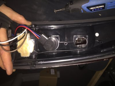

The last project I finished was to swap out my tail lights. I wanted darker tail lights as I´m planning for the car to become black, and at the same time I could do some modifications to the lighting setup and get rid of the extra turn signal lights added by the Norwegian dealer 20 years ago.
I ended up just ordering tail light housings from eBay and some bulb holders. The turn signal/reverse bulb holder fit the hole in the plastic perfectly, and then I did some minor plastic cutting with a Dremel to be able to add the tail/break light bulbs in the two upper holes:

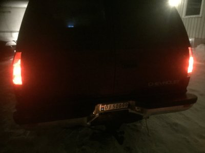

At last, the sub back home with all 4 tail light bulbs live for the first time in its life! I´ll do more photos of the tail lights once I have some daylight again. ;)

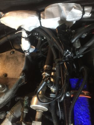

Progress on the wvo system today..or at least so I thought.
Collected the new walbros, and the fittings had arrived, so I was eager to get them mounted!
Got the old pumps out of the car, and measured for the new bracket and made holes to mount it. I was a bit to quick - I´ve mirrored the holes. Luckily I could just turn the bracket upside down and make new holes!
56172
Got the bracket mounted. It will be just two M6 bolts holding the two walbros, but only one of them will run at a time, so I hope it will work out:
56173
The WVO walbro is in place and coolant line zipped to it:
56175
The coolant lines are still running parallel with the wvo from the tank thru the LP prefilter:
56174
Went for a disappointing test-drive after I´d mounted the diesel side pump as well. Only 3-4psi output from the walbros. Slightly higher when I started running veg oil, but it went down as well to around 4psi, and down to 2-3 on WOT. I´m debating where to look for improvements now, and I am really questioning the new hose barbs on the walbros. I´ve put so much work into getting the wvo system running now, so I will have to find a solution! Not giving up! ;)
