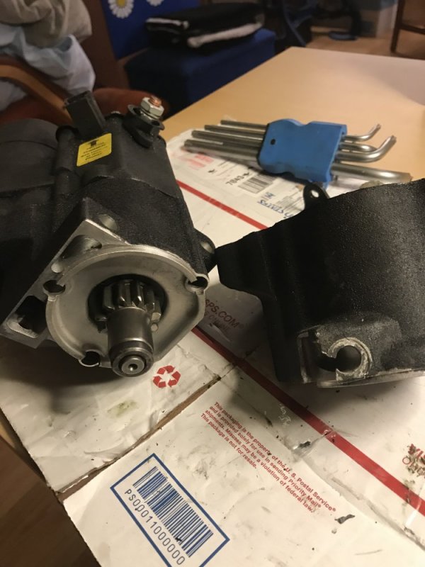

First I had a look at the new front casting for the starter. After consulting a bit with @MrMarty51 on how to get the gear out and back in, I got it going. The solution was to put it in a vice and use a piece of wood and a hammer to drive the gear out of the old casting and in to the new.
New starter with new housing, and the old housing at the side:

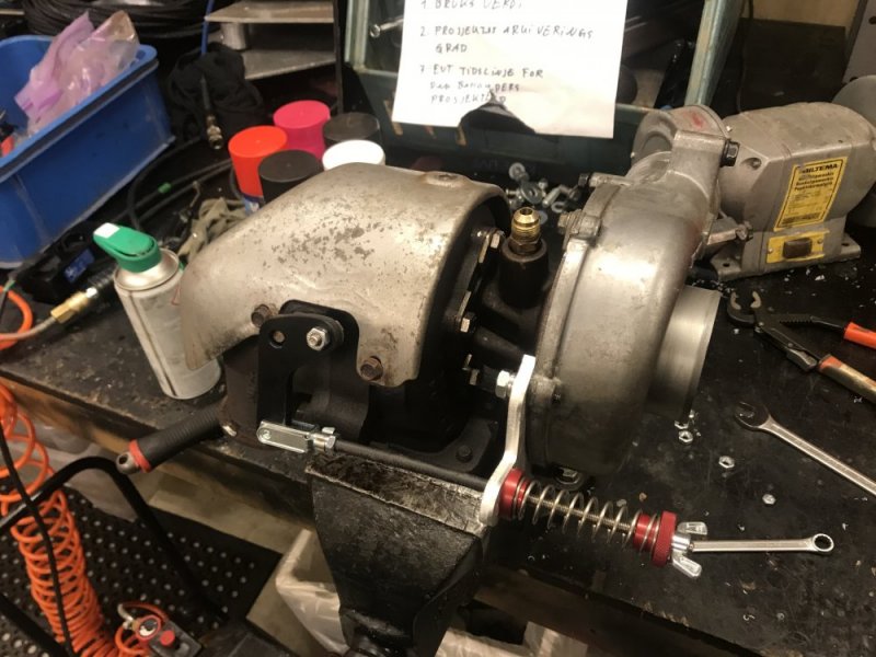

Then I went to my old companys warehouse, and had a go at the turbo and the new shaft. I took my time, and it took some hours, but at last I could drive home with a overhauled gm8 with new exhaust wheel, shaft, wicked wheel 2, and a mech. waste gate controller:
A big thanks to @bison who has written a great thread on "Rebuilding a GM8 turbo,show and tell". It was a great help to me. I shot a lot of pictures during the rebuild, so I will make a post or two to show what I did. Maybe someone finds it useful, maybe someone can spot my mistakes! haha!

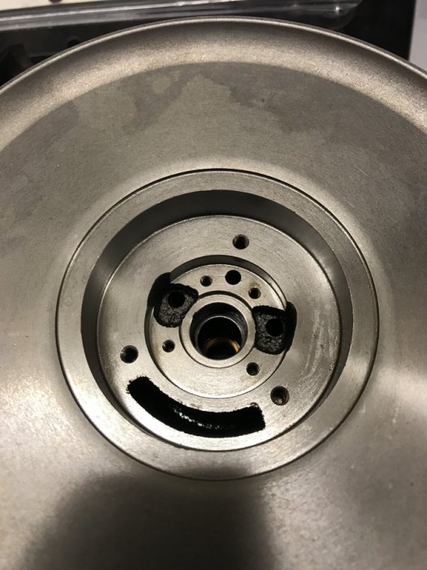

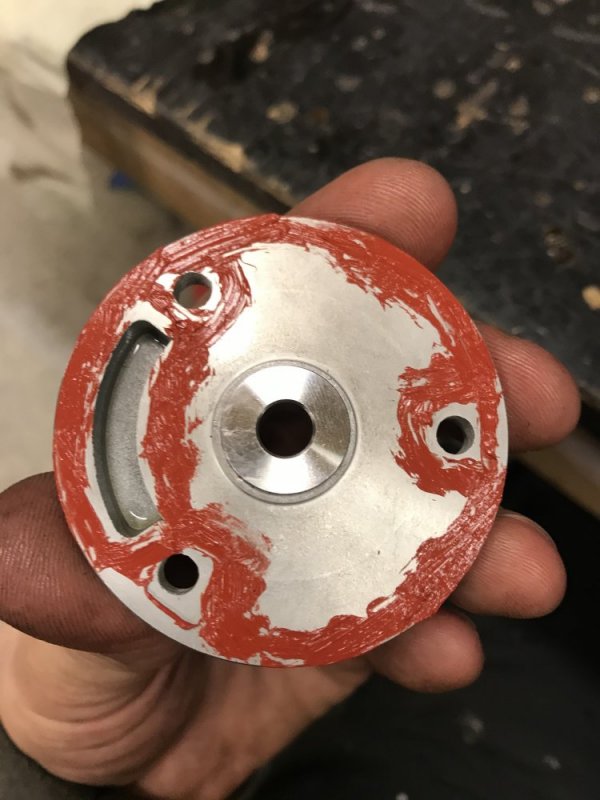

I wrote that I´d share the pictures from my gm8 turbo rebuild, so here goes....

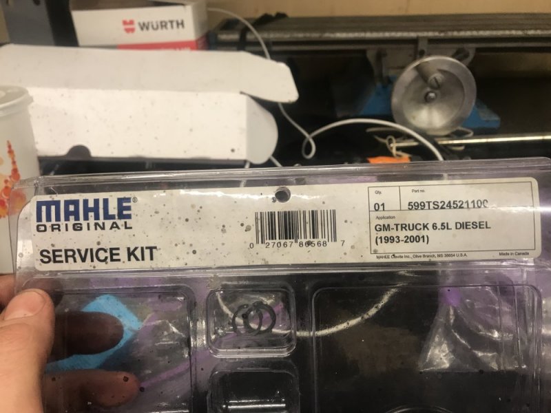

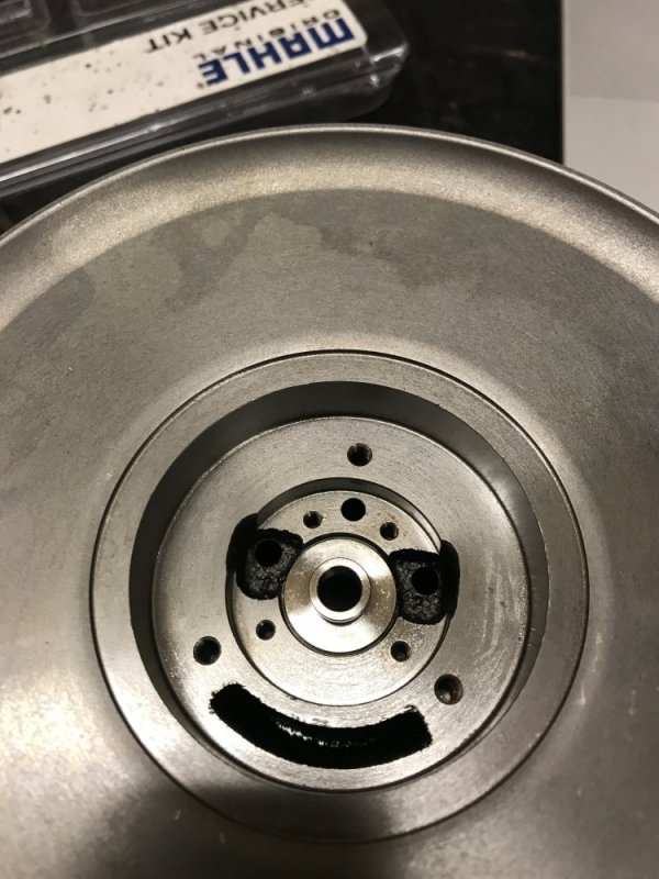

This is the service kit I got from quaestor tuning:

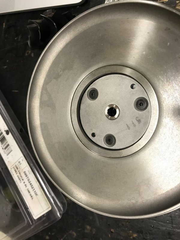

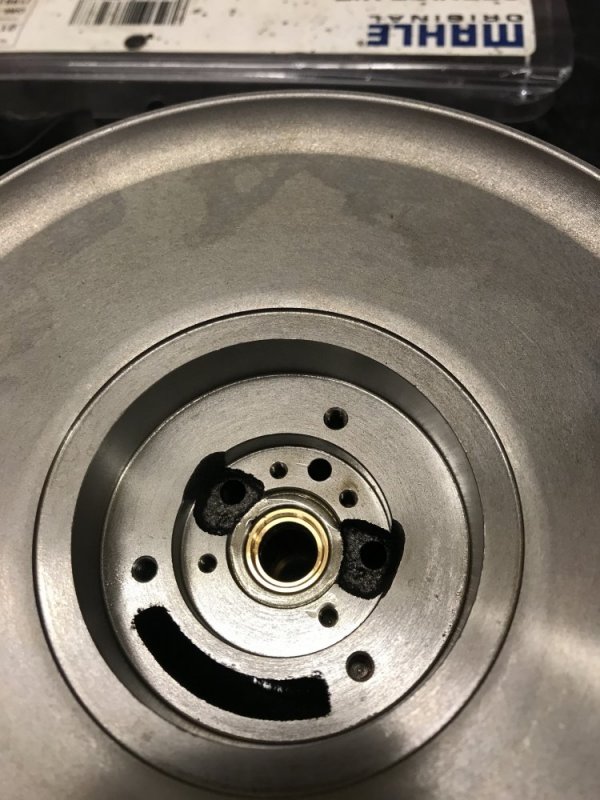

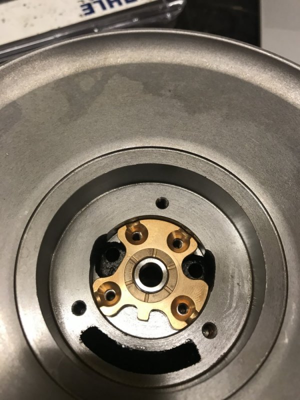

Part by part going into the turbo:
2020-01-24 23.48.57.jpg2020-01-24 23.50.01.jpg2020-01-24 23.51.30.jpg2020-01-24 23.51.35.jpg2020-01-24 23.53.15.jpg2020-01-25 00.03.19.jpg2020-01-25 00.05.48.jpg

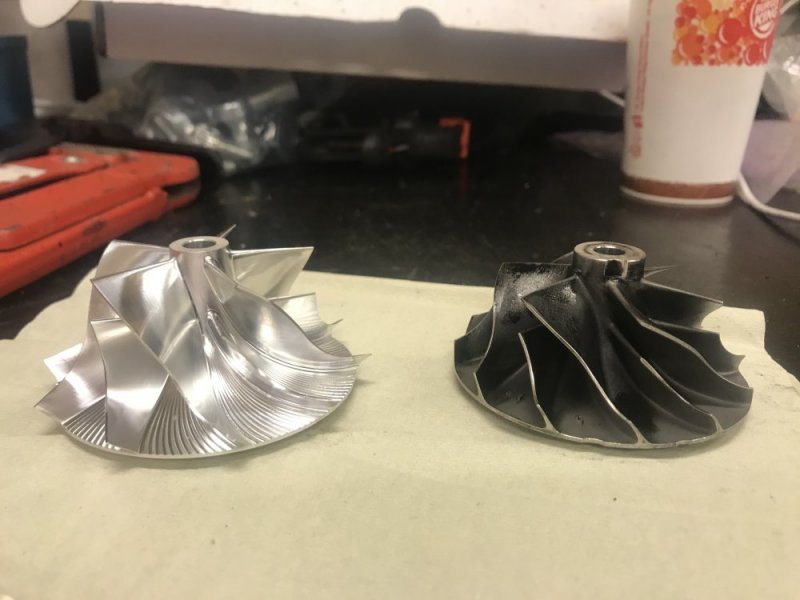

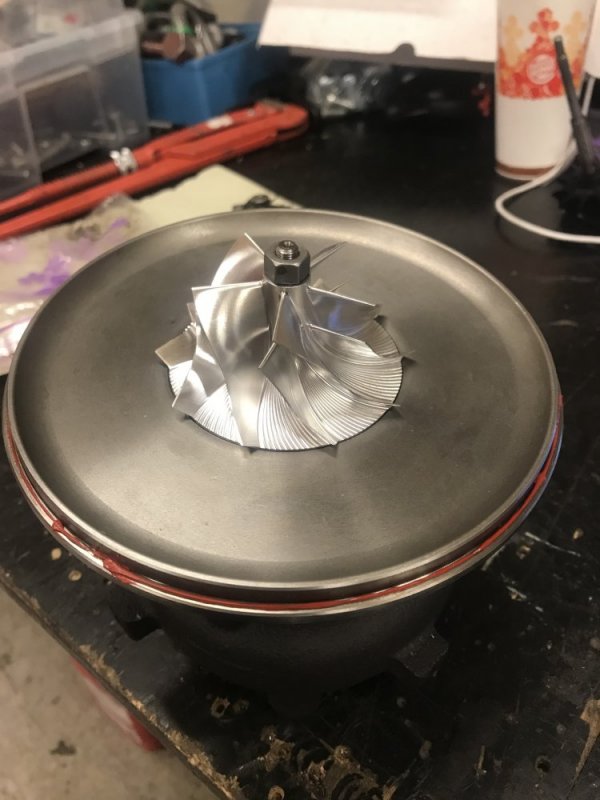

The new wicked wheel compared to the stock wheel:
All ready for the housing:

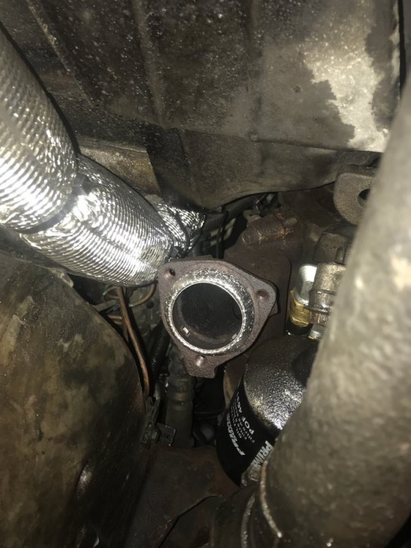

The story continued with getting the diamond eye exhaust and the new starter in place. I was very worried about breaking the bolts when trying to get the old crossover removed. A friend of mine recommended soaking the bolts in 50/50 ATF and acetone, and it worked like a charm! I gave it a couple of days, and the bolts came off like they were new!! :D
Installing the 4" exhaust itself was quite straight forward - having a friend helping hold it helped enormously though!

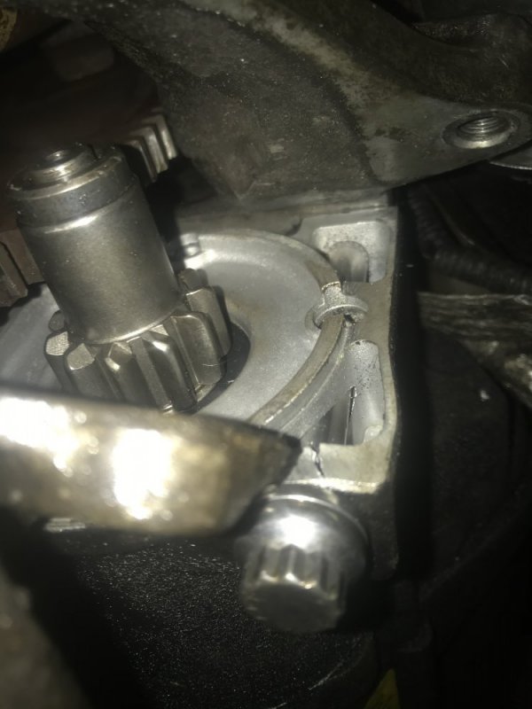

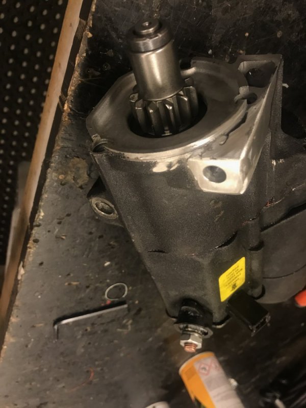

The starter however, was a different chapter. With the new housing on, I carefully torqued it in place, but look at that...
I couldn't believe I had ripped another housing, I had been so careful. But wait...I had a look at my torque wrench...and stupid me had read the scale completely wrong, so It was all my fault all the way. So embarrassing, and still with no new starter. Luckily, my multi genius welding friend helped me out yet again and repaired a housing so I could get the new starter in place, this time with the CORRECT torque...

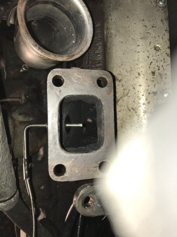

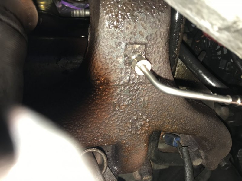

Before putting the turbo in, I also drilled and tapped for an EGT sensor....

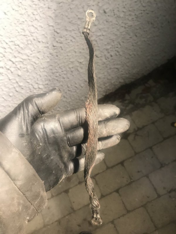

....and replaced the ground strap behind there. I think this one had done its job:
