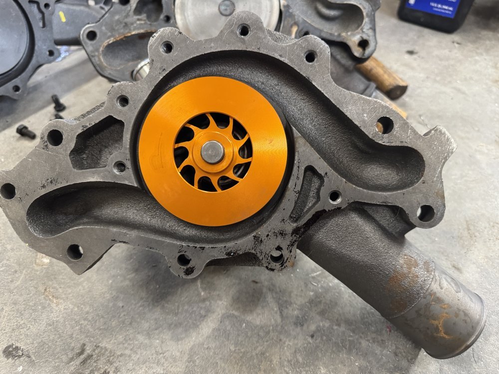

We don't need to see the backing plate, we need to see the pump impeller, that's where the flow originates...
I thought the blockage of the pump to the backing plate would affect the flow.We don't need to see the backing plate, we need to see the pump impeller, that's where the flow originates...

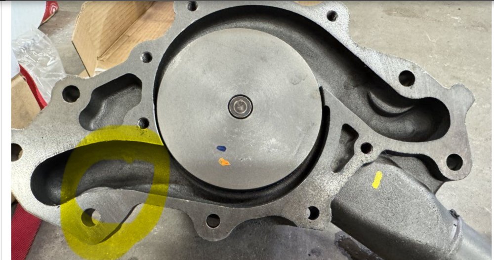

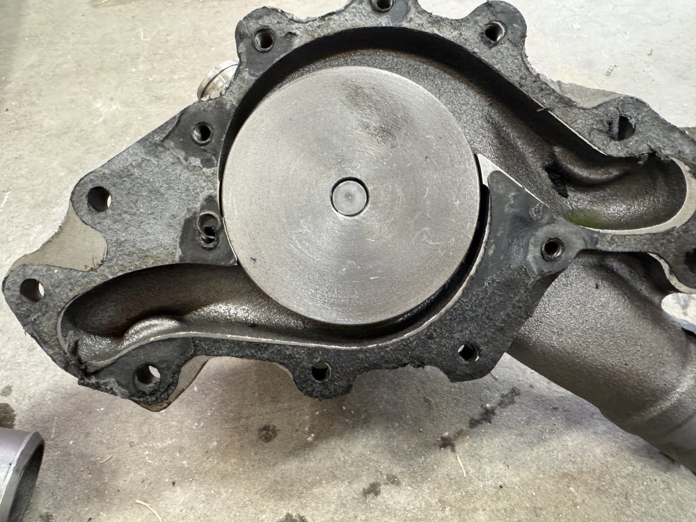

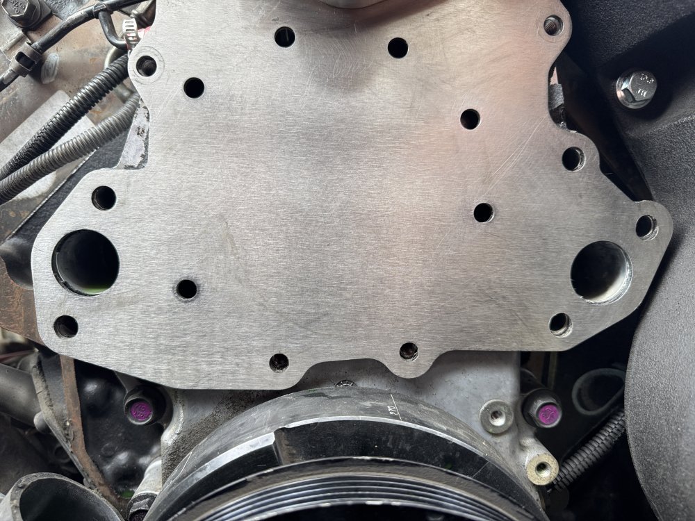

What do You think about doing some die grinding on the new AC Delco coolant pump so that the backing plate and the channels in the pump align a little better ?That orange one is the “flow kooler” brand. I caught them in lie about the volume it flows. Leroy accepted it was doing the volume the manufacturer says it does, like all their victims. Last I heard from that outfit they were going to go back to testing to get the volume up and verify it putting out balanced volumes- but they never got back to me and when I contacted them about a year later- the new guy knew nothing about the guy I spoke to who quit and the company wasn’t doing any testing…

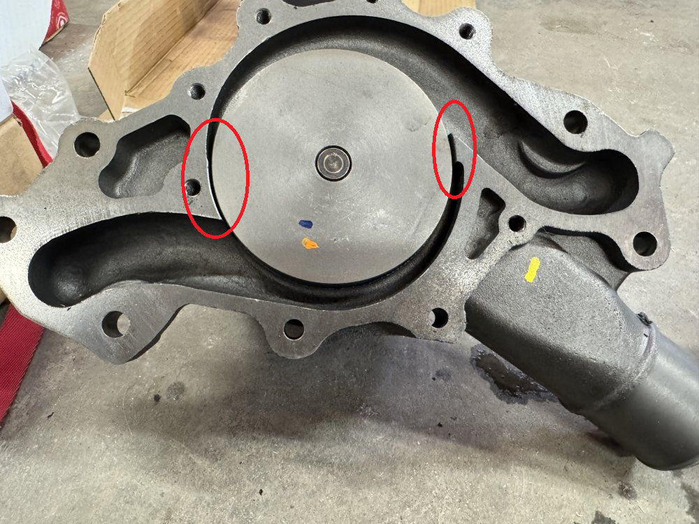

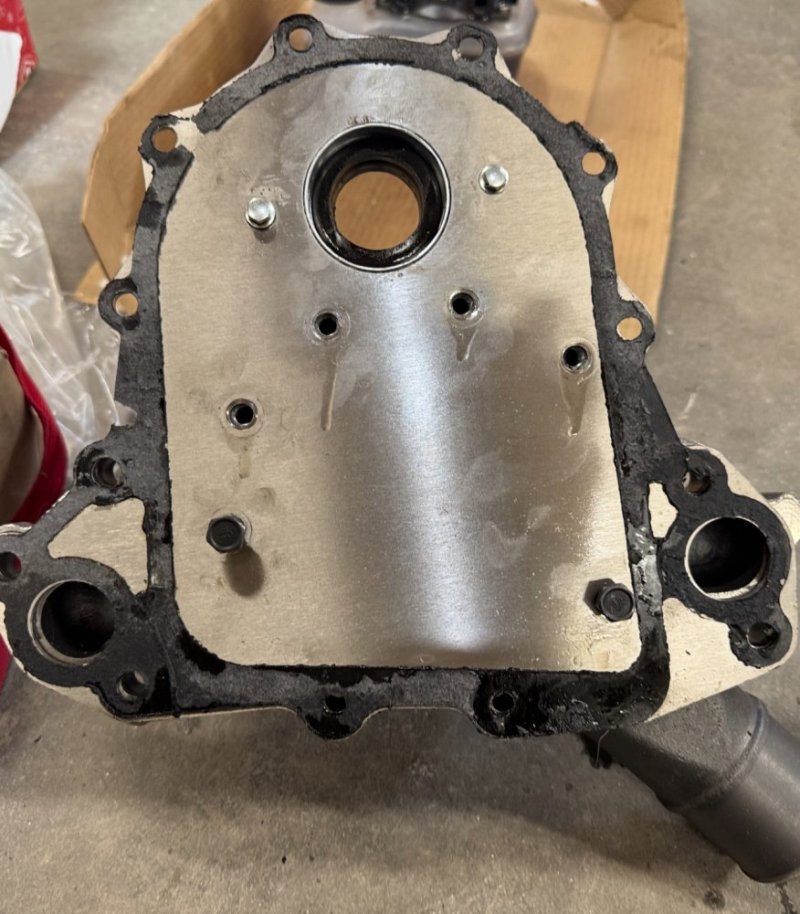

Not sure what you’re getting at. It looks like flashing is present on the hole to the right and to the left the backing plate is misaligned. If that’s the case, I would grind the flashing off on the right and grind the plate on the left. Before I’d do any of that, I’d pull all the bolts to see if the plate will align with the water ports, then adjust/grind the bolt hole holes.What do You think about doing some die grinding on the new AC Delco coolant pump so that the backing plate and the channels in the pump align a little better ?
Kind of like grinding heads to intake manifold ports for a more undisturbed flow.
Would that help on the flow from the pump to the block ?
Its not much of a misalignment but it might have a slight affect on the flow.

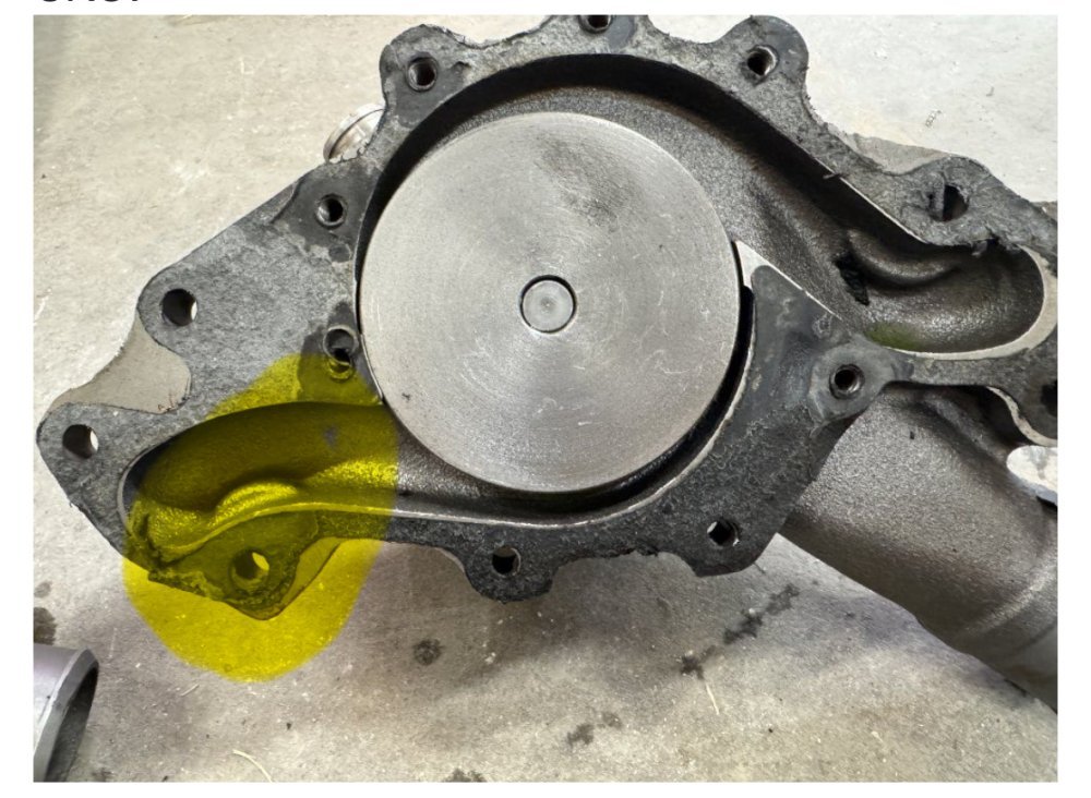

These were all tested on the 6.5 Optimizer? If so, I would stick with the new AC Delco. I also commend your efforts to swap these in and out so quickly.Engine was cooling real nice with this pump.
Engine was not cooling good with this pump.
Temperature gauge before I got home was running on the 220 peg.
This AC Delco pump is closer to the pump that was cooling good.
I think.
Thank You @Big TThese were all tested on the 6.5 Optimizer? If so, I would stick with the new AC Delco. I also commend your efforts to swap these in and out so quickly.

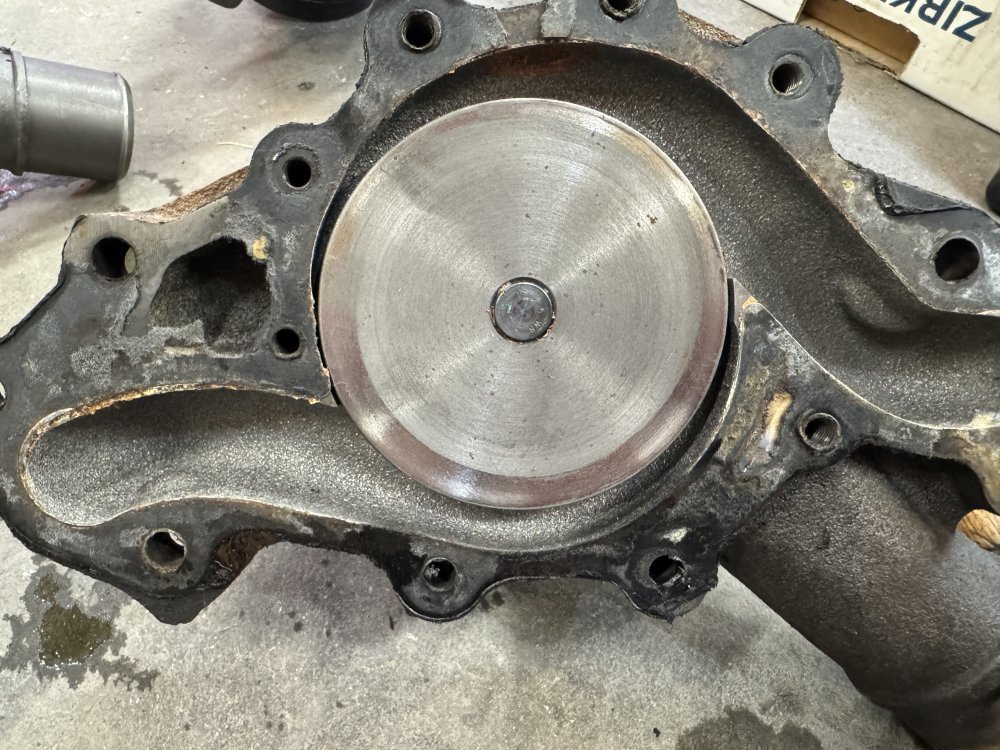

On the bad Chinesium, the pump vane does not look like it’s attached solidly to the shaft. Could it be spinning on the shaft while under load?
I was thinking that.That’s a good way to get all the life from a tire right there!
It is not just the pump… how the heater hoses tie in affect it also. This is why there is all the warnings about bypassing a bad heater not just blocking the lines and why in Hummers they have to reroute one hose down into the lower hose.on the pics you posted I could not tell where you ground out on the pump to match the ports of the backing plate. can you post were you ground into?
on that one that you said wasn't cooling well it kinda looks like the impeller is slightly out on the shaft where the others look like the shaft is protruding out slightly further than the impeller. if there is a larger gap under the impeller to the pump body, that might explain why it's not pushing as much coolant flow as the others. I would think it's not just the gap on the sides of the impeller but also the gap behind it to the body too.
