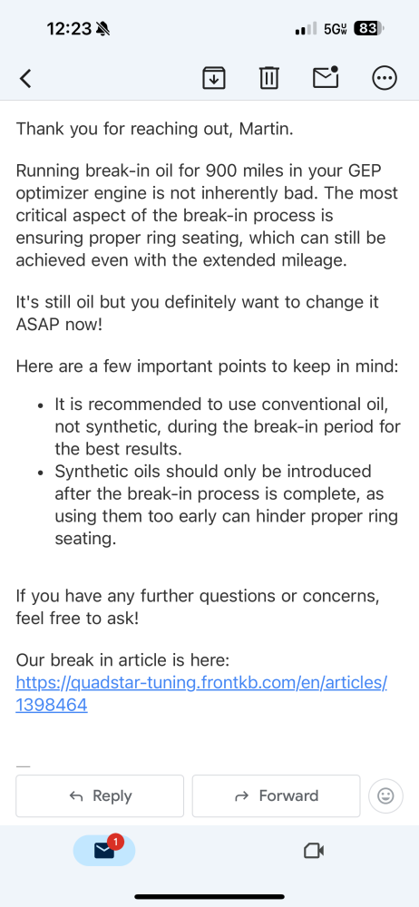

I reached out to QS Tuning and asked their opinion.

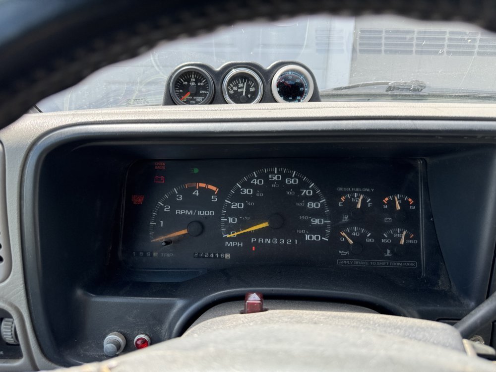

Maybe I panicked, about the temperature going to 205*f then to 210*F at an idle.
I thought sure that the 190 stats should cool it down some.

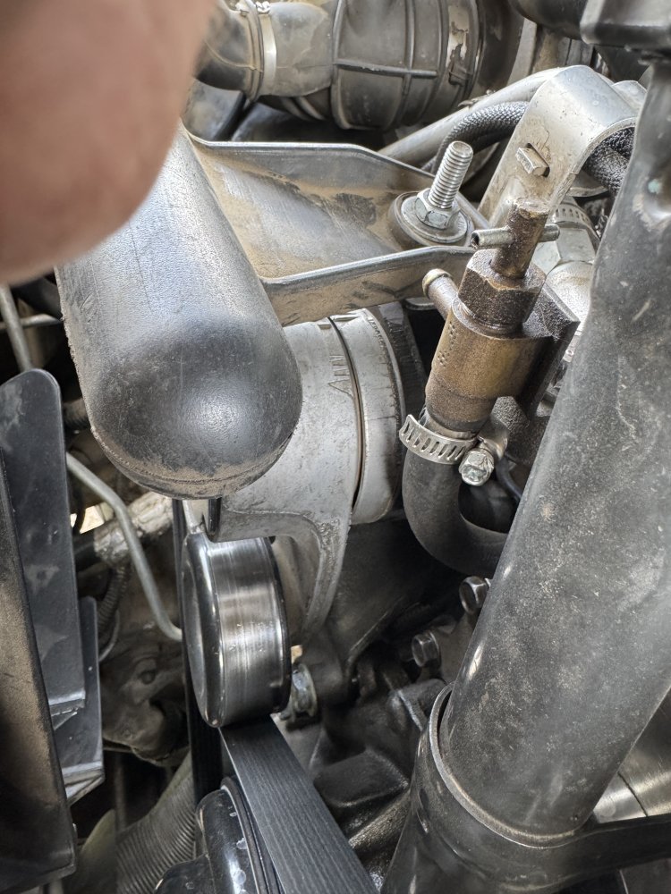

Belt tensioner.
Before deciding on a proper belt to eliminate the vacuum pump, tried about five different belts. As soon as the engine was started it seemed the tensioner would adjust to the maximum stretch limit according to the indicators.
I finally selected the shortest belt that could still stretch over the pulleys.
I checked the tensioner just in case the belt had stretched enough to create slippage.
Belt is still plenty tight.

Was not happy with these numbers.
A/C is on IIRC.

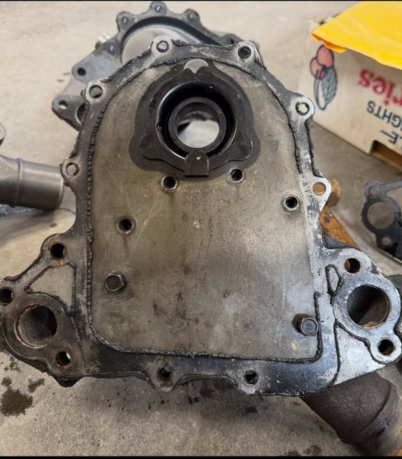

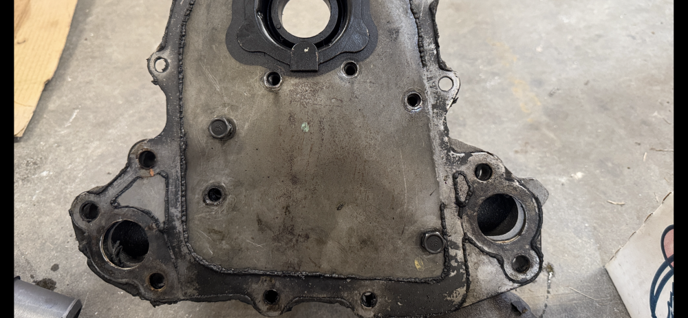

Coolant pump removed.
Old NAPA pump with original equipment backing plate. This pump with this plate did an excellent job of cooling.
Old NAPA pump with original backing plate.
Chinesium KO pump from Rock Auto.

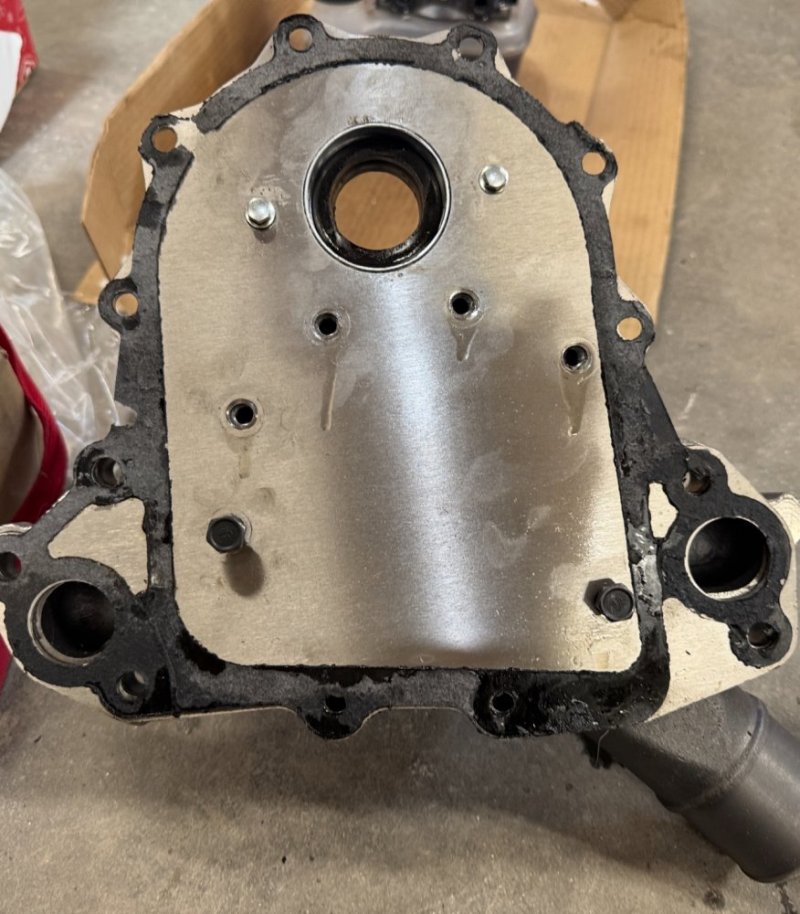

Remember, I had ordered by the AC Delco part numbers but is what I was sent was this POS that had a GM original tag attached with the original GM part no.
The new AC Delco pump with the Quadstar Tuning backing plate.
The old backing plate fits this new pump exactly the same as the one from Quad Star tuning.
I’m thinking of doing a little die grinding on this new pump so there is no pump blocking the backing plate.
Would that be advisable ?
