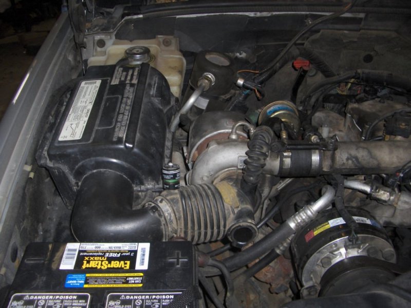

Who know's what my son was trying to do when it failed. He was on a road with speed bumps when it happened, because I went to tow him home.
Sometimes a fairly low mileage engine can be found fairly reasonably in a used vehicle, You never know how the vehicle has been taken care of. If they have maintenance records it's plus. If I look at a vehicle and the fluids aren't topped off and it is in need of being serviced, I passnow comes the search. I am going to call teds in the morning to see what they have. I think I asked this before are the heads the same on the center mount turbo as they are on the trucks?
So If I were to find a motor with a center mount turbo will my truck intake bolt up to it or will I need to change the heads?No they are 60* intake bolts trucks use 90*
Did you find the bolt for the busted connecting rod in the pan? What exactly is the history of this engine as it looks fresh rebuilt or new?
Keep in mind the oil cooler is trash now as it's full of debris from the engine failure.
I would have the turbo rebuilt as well in case it ate anything (bearings and or wheels). Also in case it was the source of oil that ran this engine away.

Oh yeah, rain. Kid's got more talent at breaking things than I do. We don't get that much out here and then when we do it's hydro lock from crossing flooded washes...
Grab the engine oil cooler off the truck. If they have the K47 air filter boxes with duct to the turbo get them too as members here will buy them from you.
