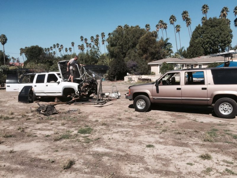

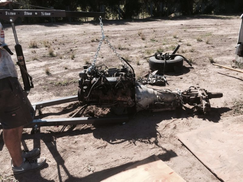

Just for reference here is how you pull the whole damn thing at once. I do not recall if we dropped the transfer case off the trans or not. This is actually going in in these pics.

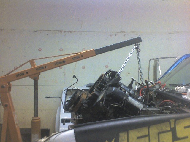

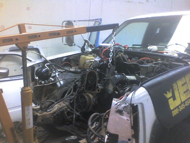

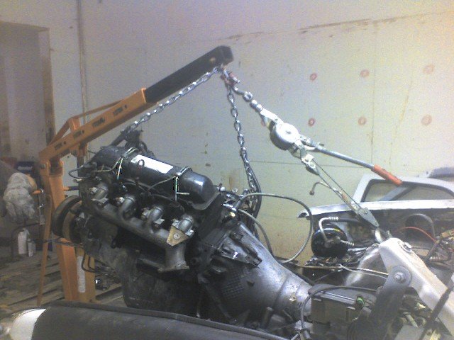

I pulled the engine with the TC. It wasn't that difficult, but it did take 3 of us (2 would have worked). We didn't even have to take off the front clip. Here is how to do it if you ever have to. We jacked the motor up with the crane/hoist and a floor jack and block of wood under the tranny for support just enough to unbolt the engine mounts from the engine. There are 3 per side. We then lowered it back down to take pressure off the tranny and used a pry bar to pry and bell housing away from the motor. Basically jack and pry, jack and pry until the TC is free. Then it is lift and pull until the oil pan is clear.
The only thing that was weird was all the bolts connecting the bell housing to the engine were all studs. One of them had a ground on it. My friend who helped me has pulled motors from big rigs and gassers and said that normally the studs are mounted to the engine so the bell housing lines up and you use nuts to tighten it. There were some dowels in the engine that were used to line it up. The tranny was rebuilt by a local shop and I think they would have done it correctly.
