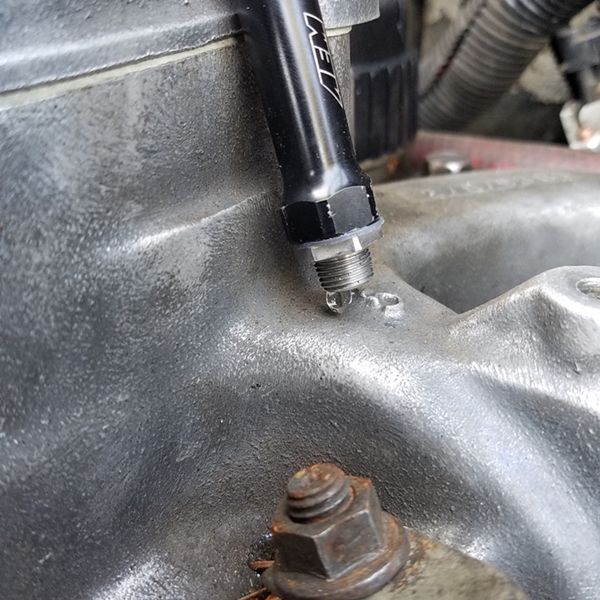

So, I changed the oil and filter. When it drained, I did see a bunch of water come out. Maybe a 1/4 cup, maybe 1/8, no way to tell but not much, which is too much.
I drove the five minutes to town to get more oil and such from NAPA and she started slow (I'll get to that) but ran great. When I came out of NAPA, I looked underneath to do my normal check for any leaks that I do after any work.
What the heck is that dripping? I slide underneath to check what's coming from the rear of the engine. Water, ok. Clear water. Again he says hmmmm...
The night before I had gotten everything together and running, fell asleep exhausted from dealing with all this and at 3am, my eyes went doink! Wide open. I was hearing Wills booming, godly voice saying "Wmi system failure more likely you silly Jack-ass!" And he looked just like Morgan Freeman wearing a Popeye the sailor man onesy and holding a giant Ar-15 which was strangely comforting and disturbing all at the same time.
I had bolted everything back up the way it was which meant that the WMI was probably leaking into the engine at that very moment and would put me right back where I was before with a locked engine. Maybe that jack-ass part was my own voice.
I got up, put some pants on and went out into the dark with nothing to protect me but a 15mm genuine Gear Wrench made in Taiwan to take the WMI injector that we think caused all of this out of the intake.
Thinking of all this (while trying to block the Will looking like Morgan Freeman part), I climbed back up to the engine bay and looked at the WMI injector. Gee, I don't know... you think it might be leaking?
I went over to the hardware store for a plug until I can get the Devils Own solenoid that sctrailrider suggested.
Oh yeah, the slow start thing...
One lesson that I am qualified to teach others is this... While troubleshooting and fixing one problem, you can and will be thoroughly confused by something else, completely unrelated that will go wrong at the same time.
After getting everything running, when I heard the slow start, I thought of WarWagons warning (say that 3 times fast) about a bent rod. Having never heard an engine run with a bent rod, would it slow start, I wondered? Fear set in.
But I also remembered that I had the charger on it for the last three days or so and they never really got up to full charge. Another hmmm... Sure enough, after a few starts, it wouldn't turn over any more. While a buddy was giving me a jump, he says "hey, this battery terminal is smoking!".
The day is positively chock full of hmmm...
I got her started, went up to the shop to swap out smoky with a good battery and she starts fine now. It still looks like it's not completely up to snuff so I'll probly get a pair of good yellow tops to solve that problem.
