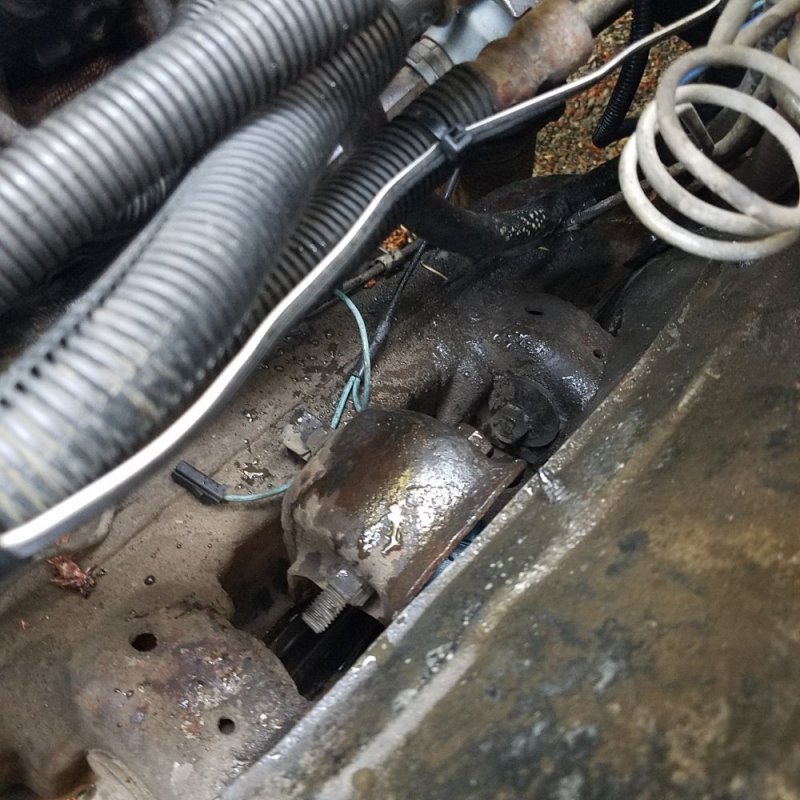

Even though the push-start experience does lean toward the motor, personally I would still check out the starter to see if it seized.
When I suspect one locked up, ill pull glow plugs to loose compression, bump the key. Hydro lock will let it push out coolant if present. If it does start turning over a compression test is in order anyways bfore starting regardless of hydro.
No crank then i pulll the starter and fly wheel cover. If the starter bench tests ok, the use a fly wheel turner and rotate engine via flywheel. You can also crank backwards in case something like a push rod bent and is locking up. loosening or overtightening a certian bolt up front has bit me and a couple friends when i was a teenager- i try to avoid it now.
Nothing to add really, Will hit the nail on the head. Pull the glow plugs 1st thing, and go from there. Pretty sure most big parts stores will rent the tool to turn it by the flywheel, if not they're fairly cheap to buy. Then see if it moves with the compression released.

Hopefully it's a bad starter as mentioned above. And if so new starter bolts are in order as well as a flexplate gear inspection.
That was my first thought, I hope that's all it is!
I'll try to do that today.

3,5,6,7 and 8 full of water.
Starter is turning the engine over nicely with glow plugs removed. Water shot all over the damn place.
It's all clear water, not coolant. I'll shoot some WD-40 in to help disperse the water and put her back together.
