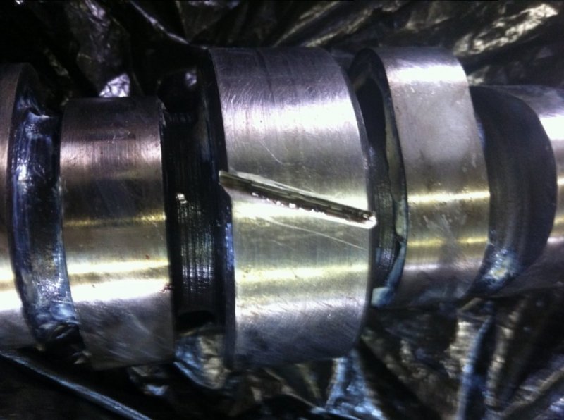

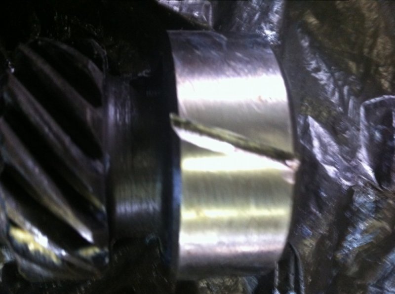

I installed new cam bearings and the cam would not fit. I had a second set as the Chinese block from the previous build already had new bearings. I measured the O.D., I,D and thickness of the spare set. They are all over the place. I was wishing I had left it alone. O.D's were more than .010" different as well as I.D's, That is taking into account for out of round.
I went online to look into reamers and found everything from fancy machine shops to several mentions of using a spare cam and making a reamer out of it. That is what I did and the cam fits fine. I forgot to take pics but will tomorrow.

Here are a couple pics of the cam
A zip disc on an angle grinder, I laid it over at an angle and then made a relief on the leading edge.
I used a ratchet on the bolt, oiled it up and slowly turned it. It only removed a few thou on the high spots. I polished the bearings with super fine steel wool, they looked like new.
That's really cool! Dare I say that it's even groovy? :rolleyes: Nice work and thanks for sharing that...a nice little idea to keep in the back pocket. :D
