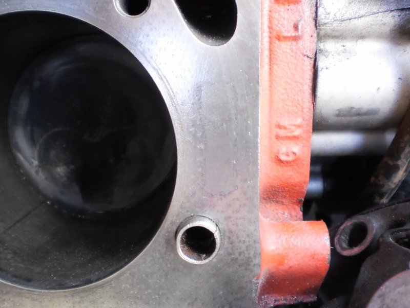

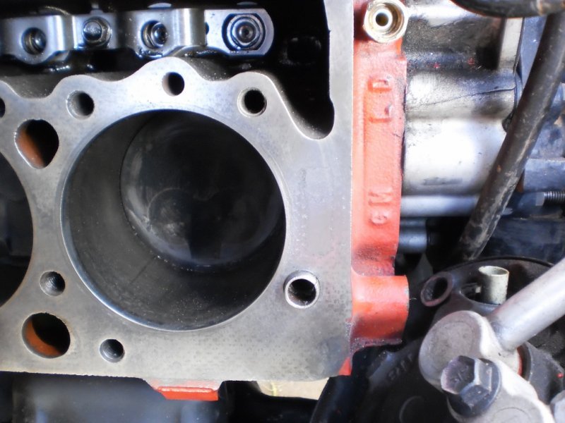

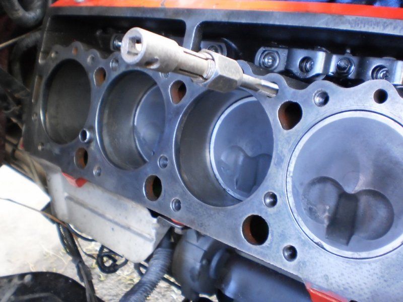

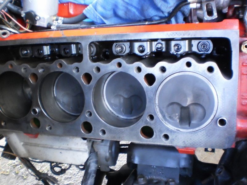

Cleaned up the decks on the block today, and chased all the head bolt threads. I inspected the block closely, particularly in the area the gasket blew. It has very slight imperfections, but nothing like what the head had in the pics I posted earlier. Here are a couple pics.
Matt

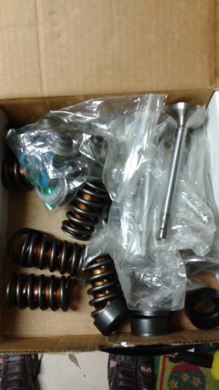

I was less than thrilled when I wire brushed them and seen the hairline cracks in them. If i had seen the cracks, I would have scrapped them years ago. I've got all the valve train pieces still as well as the valves, springs, retainers, and keepers. Need to get off my duff and check the block out and see if it's gone or not, getting tired of storing this stuff, and if it's junk it might as well go to the scrap pile.
