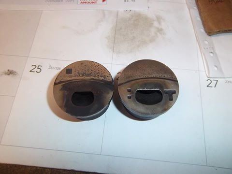

Not meaning do derail your thread but? Could you tell me how the T precups compare to the diamond cups. I thought the diamonds where the latest and greatest but those T precups look pretty big in your pictures.
The T turbo cups came out on the 6.5TD's before the Diamonds. The Diamonds are just a little bigger than the T cups, but I'm quite sure they're more than adequate.

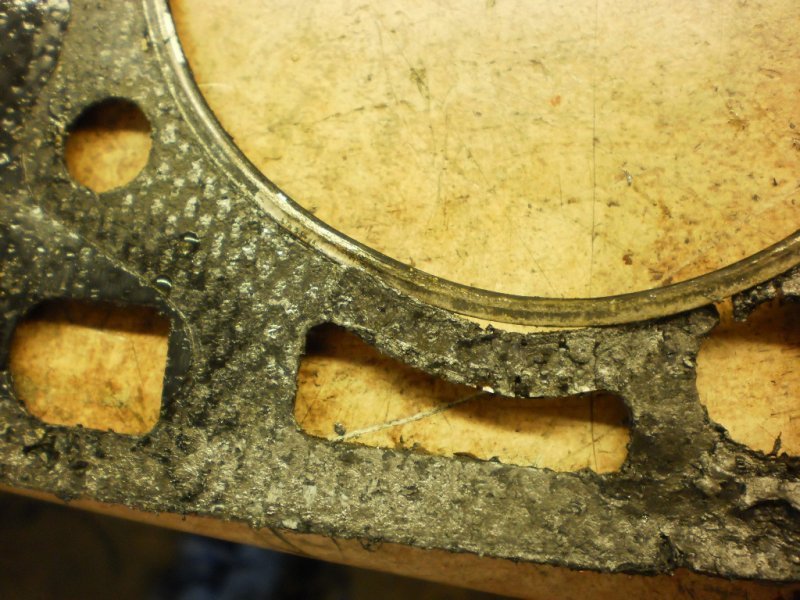

Yea, I'm thinking the drive pressure was way up there, any shots of the gaskets were the sealing rings elongated or were they still round?

You can see the gasket below, and yess it would be great if these heads from Fermanator ended up working out. :)

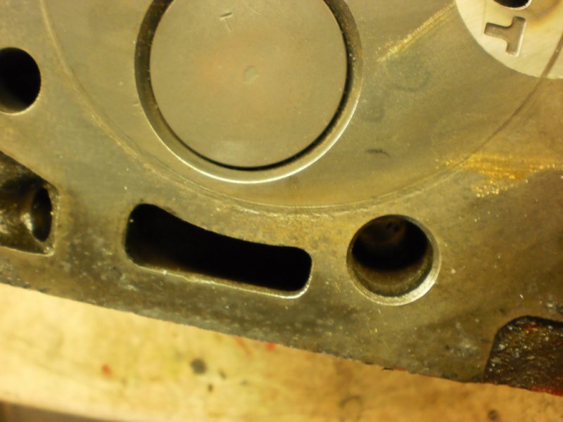

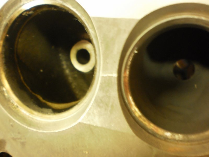

Well, i won't be using my heads! I pulled the valves from the head with the worst cracks, and the crack goes through the seat, and continues past! :eek: You can see the condition of the head gasket, as well as the pitting in the head in the area where it blew. :confused: I've made up my mind, I'n not putting cracked heads back on this truck! I would rather use crack free OE if the ones Ferm has turn out to be good, but if not, I'll be getting the "improved":D China castings.
Matt

The T-Stamp's are basically the same thing as diamonds. I have both and measured with a caliper, and although I can't remember exact numbers, they are pretty much identical. The diamonds are only a tit hair bigger, but not enough I think you could warrant them being different. Now, going from square stamps to T's like I did, GIANT leap haha

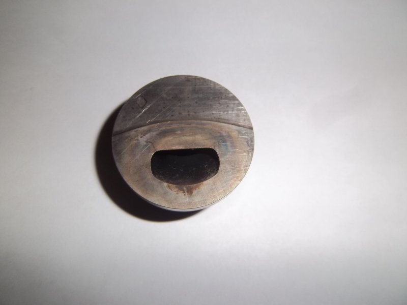

And here is a diamond from a set of 7 I have. Can hardly tell a difference to the T-Stamps

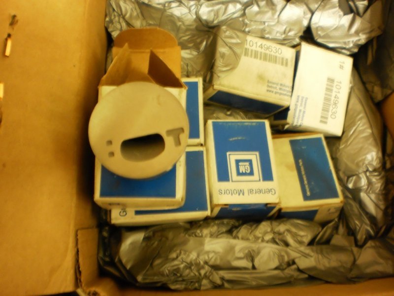

Yep, I have a complete set of 8 OEM T cups still in their boxes. :) See pic below.
