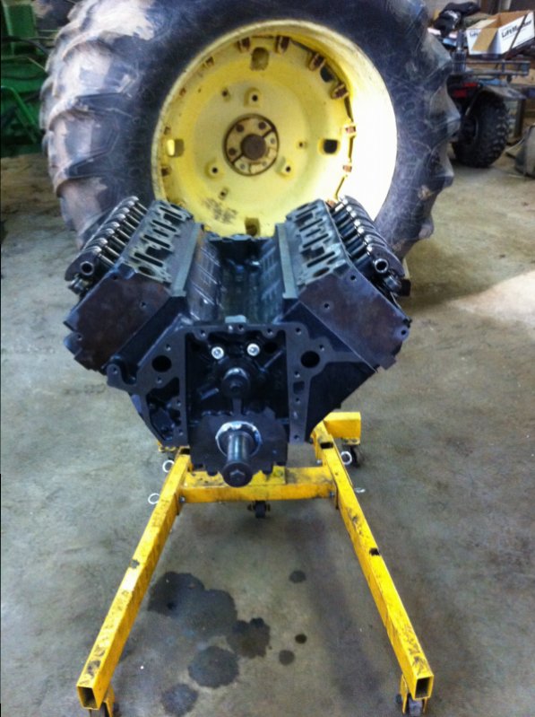

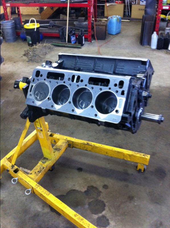

Measured the cylinders and pistons for fit, set the ring gaps for this block and plastigauged the mains. So far so good. Also deglazed the cylinders and generally cleaned up the block.
Crank is in as well as 1-5 pistons, would have done more but had company. Camshaft would not fit, #4 journal would not go through # 2 bearing. Was going to replace bearings but tried the cam from the 98, it fit. Amazing what 2 thou does.

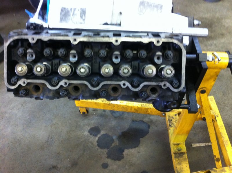

Just put the timing set on and taped for paint, I want to get a new sprayer before I paint.
