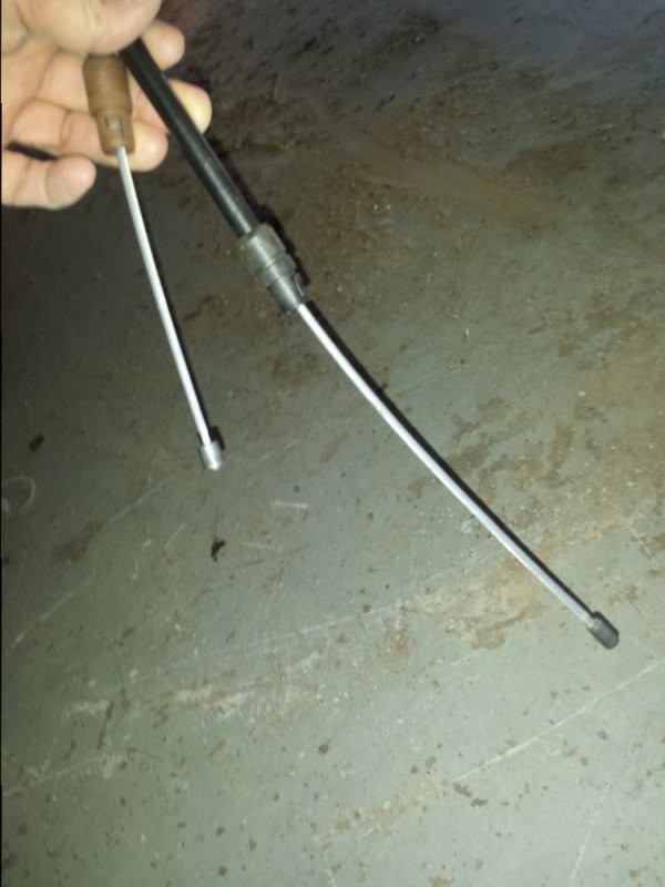

I'm also sorting out mating the parking brake cables. I have regular cab/longbed GMT800 rear right & left cables (the cables off each brake may be a standard length & all the different body configurations get adjusted in the intermediate cable?
Either way, I'm wondering if anybody might have easy access to a GMT800 to get a picture of the pbrake equalizer setup? The one's I've found so far use cable ends similar to stock GMT400 with one of the rear cables ending in threaded rod (the other side terminating in a barrel plug). And these two come together in the equalizer. The cables I have both terminate with barrel plugs.

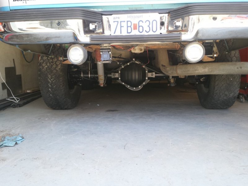

Both SmithvilleD and I have been distracted by other life issues. I believe SmithvilleD got his axle swapped (see attached pic), while we currently have the axle out with a friend to have the spring perches welded on. When not distracted by work, or end of life matters with my mother, I have been working on reaming the GMT 800 steering knuckles to fit both my son's '94 and my '99 Suburbans. Those are now done and ready to install. I need a clear weekend to do mine on the '99 and that will include replacing bushings on the lower A-arms.
