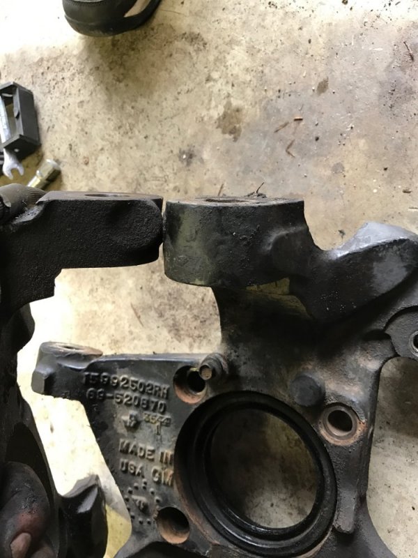

Well I bought a set of 04 GMT 800 knuckles today and it doesn't look like I can just bolt the Trailmaster lift kit spacer onto the top "ear" unless I get a .25" spacer custom machined to make up the thickness between the GMT400 knuckle and the GMT800 knuckle. see pics. So, I have found two lift kit companies that make a 4" taller knuckle for the GMT800. So I have a couple of ways to go,
First buy $600.00 worth of GMT 800 lift kit knuckles
1. install all GMT800 LCAs and parts and just ream the upper and the tie rod holes in the new lift kit knuckles
or
2. Install GMT400 forged LCAs and ream all of the holes
The only thing I like about the GMT 400 LCAs is the larger ball joint that they use. Does it make a difference compared to the GMT 800 lower ball joint?
Another idea I had was to call Moog and see if they may have a upper ball joint that would have the same bolt pattern flange to bolt to the GMT 400 upper CA but with a taper and shaft length/diameter to fit the GMT 800 top knuckle hole. Has anyone tried this? Then it would be all bolt on with the exception of whatever would have to be done for the steering tie rod attachment which I am still a little unclear on which tie rod end to use on the GMT 800 knuckle with the GMT400 inner tie rod assembly.
Anyhow I have a set of 04 GMT 800 knuckles that I will probably trying to get some of my $ back for here soon if anyone is game.
THIS SITUATION IS ONLY BECAUSE I HAVE A LIFT KIT AND DOES NOT APPLY TO A STOCK PARTS APPLICATION!

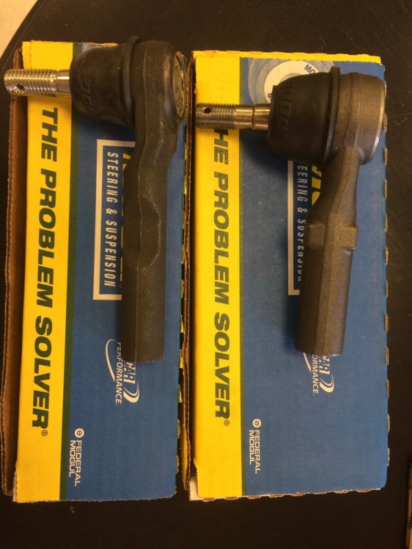

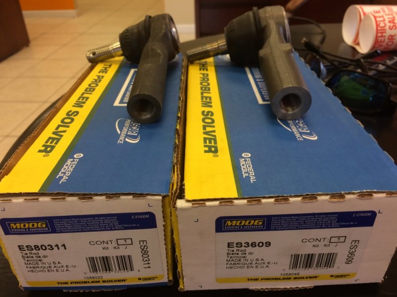

Hey Ferm, what year van tie rods are you saying to use? I went and bought these for a 2004 GM 2500 van, the ES3609 is for a 8600 GVWR and the ES80311 is for the 7400 GVWR van but they both have a female thread. I was going to take one to a Summit Racing store and try and get the sleeves since I will be driving by the Summit store in GA. next week but I was expecting them to be a male thread.

It was the ones in the thread referenced earlier. I want to say they were out of a late 80's G van. You still had to ream the knuckle, but it did away with the double ended shaft to adapt the gmt-800 outer to the gmt-400 inner. I'm still curious if the 99-00 1500hd/2500 knuckles would work with the gmt-400 outer tie rod ends.

You used the stock inner's, the van outerd, and I reccomend going with aftermarket solid sleeves with jamb nuts. You're not changing any of the stock steering except for the connection to the knuckle, so that's the only part that needs changing.
Thank you ferm. Going to order the 1.5" ball joint reamer and try and find pn for tie rod your referencing. Thx again!
