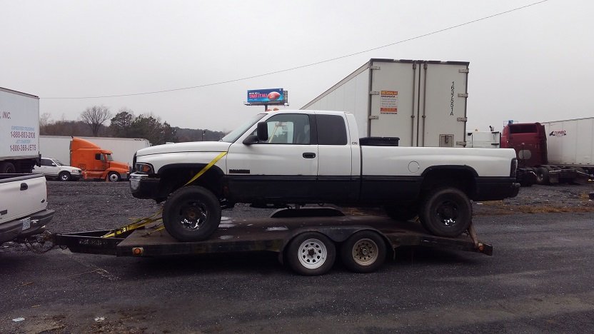

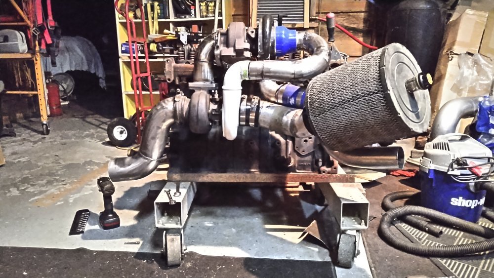

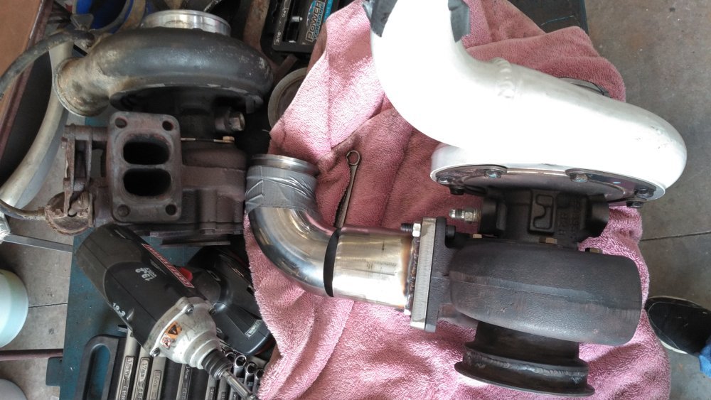

Welcome to the forum @Frankentruck That's a really nice build there. from how it came to you to what you turned it into, lots of blood sweat and tears, nice work!

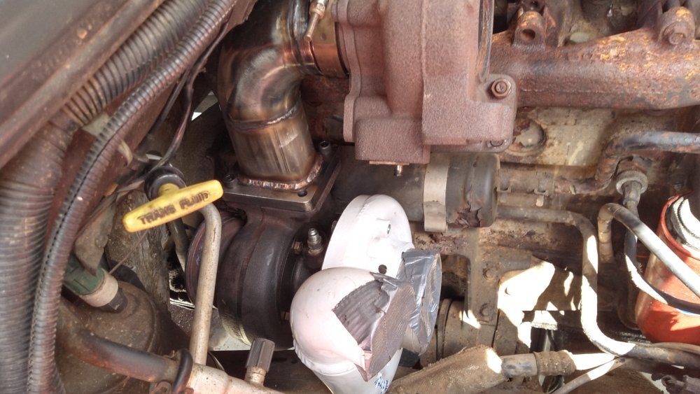

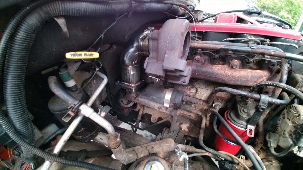

First thing I noticed! I been waiting for those pics.Ok wait, I just saw your other post. HOW (and why) are you running THREE HE351’s?! I need moar pics!
I saw this thread before I saw his post in the frankensquare thread, so I was a bit late on that. In fact was going to suggest an HE351 in place of the HX35 he mentioned dynoing it withFirst thing I noticed! I been waiting for those pics.
The current timing was set for the 5x.013 injectors at 17.5 degrees due to the 155* spray angle. I just installed a set of DDP stage 4's with 145*. They fuel equivalent to 5x.018's. It needs more timing but I'm waiting to make adjustments until i get time to install the Maxed 180 Pump built by Seth Farrell. The current pump is the factory 160.VERY nice, man! That’s a super stubby truck! Lol
How many degrees timing are you running?
Edit: Also, which P pump?
