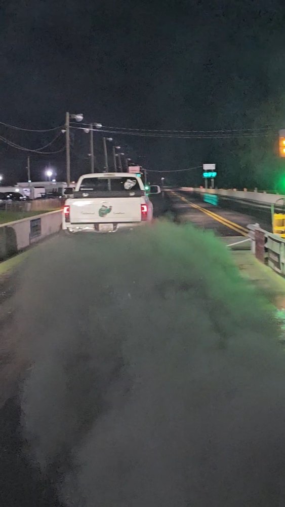

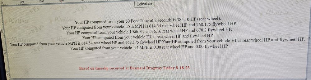

I noticed a little different turbo noise before heading to Rocky Top Diesel Shootout. I pulled the interstage intake pipe off and discovered some traces of oil. Closer inspection revealed the compressor end of the hi pressure turbo had more radial play than it should have. The atmosphere pair were fine, and the axial end play was good on all 3. Instead of pulling it apart, I buttoned it back up. The 3 hour trip each way was uneventful, and I got some more feel on driveability. I then took it to a Drag strip a couple hours from home to make some test & tune passes just to have a feel for where it is before the next series of upgrades. Unfortunately it was a special event, and no hard tires were allowed. Since I had driven there just to test & tune they offered to let me make 1 pass after everything was over. I got on the track at 1:am. I chose not to leave very hard because I didn't want to try finding a ride / tow that far that late. Long story short the time slip read: 2.0sec 60ft / 8.71 1/8 mile @ 80.1 mph. With a now 7000lb truck that started with 160 flywheel hp I wasn't insanely disappointed. My buddy used my phone to video but stood behind the starting line. After 3 seconds everything disappeared behind the smoke from the bigger injectors. My inside video to watch the gauges turned off before I got to the starting line, so no data to report.

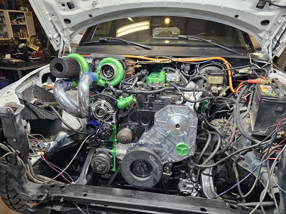

It's getting the new upgrades that I've had in boxes now.... Farrell built 180 P pump, 20* of timing (instead of 17) Tappet Cover, Timing Cover, Adjustable timing gear, street conical valve springs, and better crankcase ventilation.
I also took the time to rebuild the hi pressure turbo and swap in a Mamba 5+5 style 67/76 turbine wheel in place of the normal 10 blade 67/76.
We will see what happens.

Curious, what’s the adjustable timing gear all about?
Cummins engines have fixed timing set by the relationship of the pump orientation to the timing gear. The pump shaft and gear ID are tapered and press fit by the pump gear nut. Changing the timing requires breaking the press fit, Index the engine to the desired timing change, (or remove fuel lines, and #1 Delivery valve on the pump and checking with a dial indicator against a table for your pump), getting the tapers meticulously clean, and pull the gear back on with 144ft lbs without moving anything.
With the adjustable gearm you just remove part of the cover, loosen 6 bolts, and in my case remove a small stop bolt. Then rotate the pump one way or another until a pair of stop bolt holes (that align every 2 degrees), line up at the timing you want. Then torque the 6 bolts back down and replace the cover. The adjustable gear system also uses a woodruff key to the pump shaft preventing it from slipping.
Now that is cool!
Means you have to pull the case cover off though unless one has a sexy billet one like yours eh?
