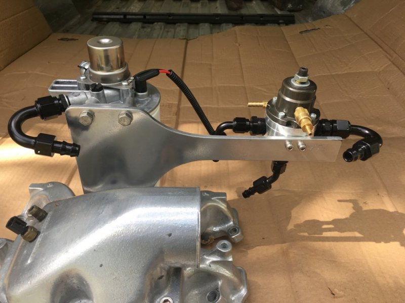

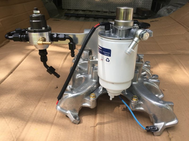

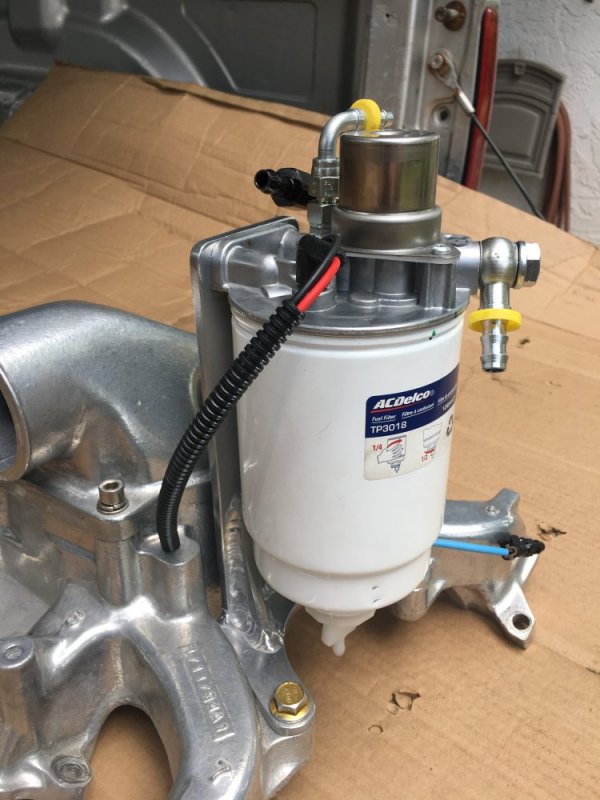

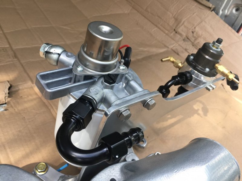

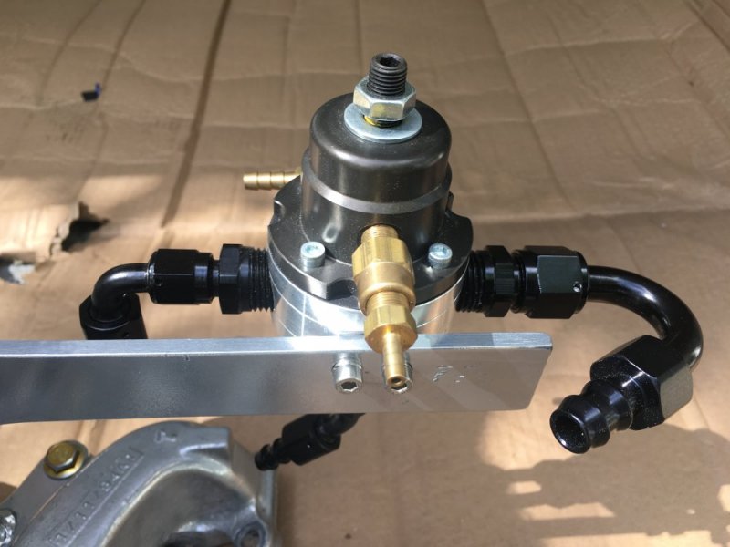

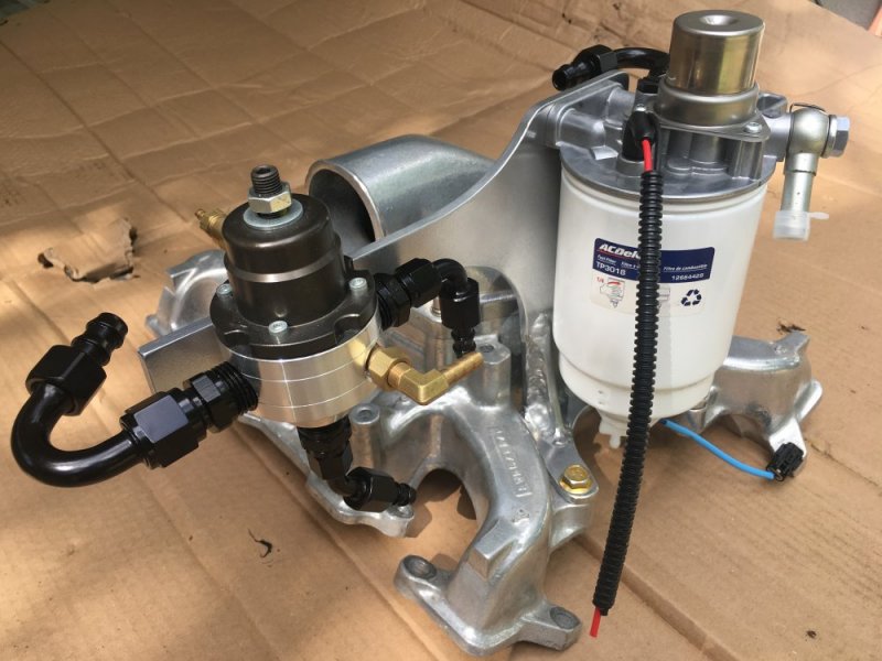

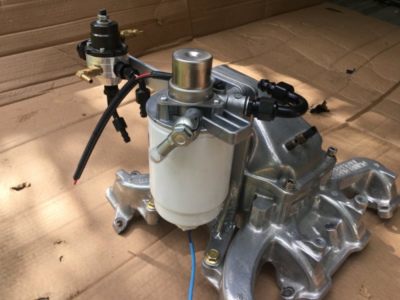

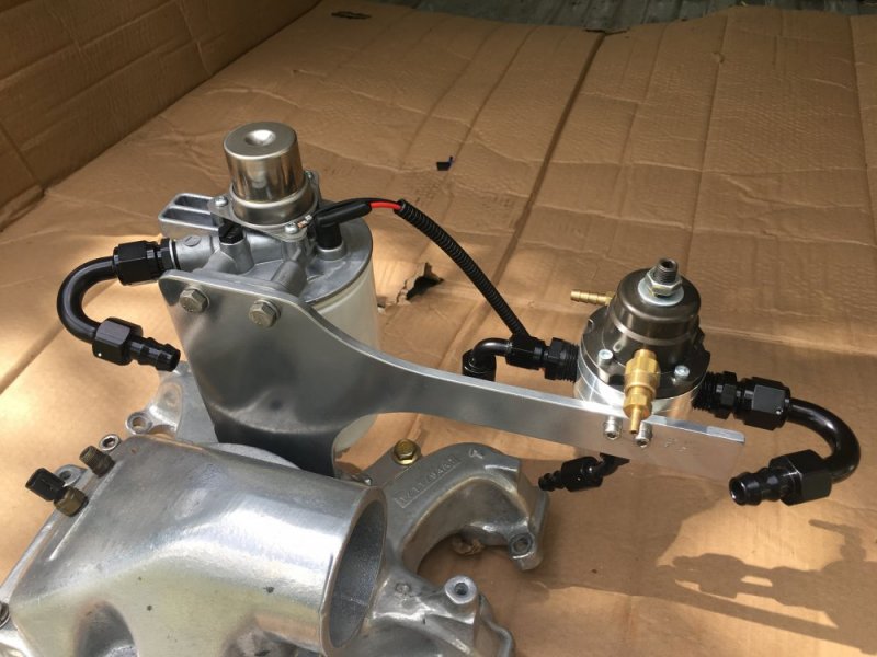

Well I know how everyone loves diesel porn so here are some photo's of one of the fuel system's I've been working on. As stated earlier in this thread there is no DATA to show that there is any advantage to using this system. This system also requires dropping the fuel tank and adding a 1/2 inch pickup tube so I'm not sure if and when I will actually be putting this setup in service

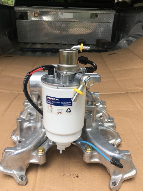

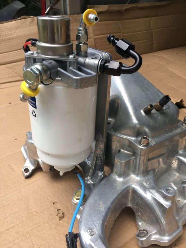

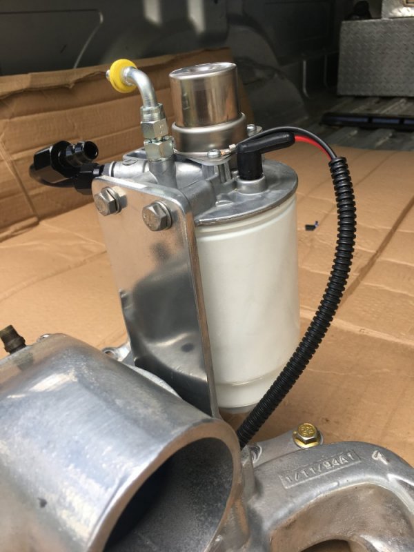

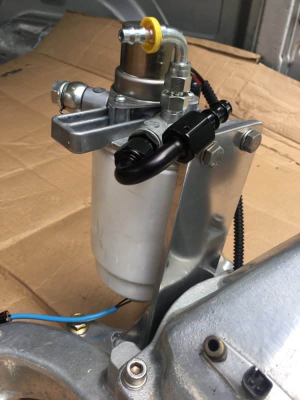

So the previous photo's are for what I will call the "ADVANCED BOOST REFERENCED, DEDICATED RETURN, ADJUSTABLE FPR SYSTEM". Which I will not be using initially due to the fact that it requires a lift pump capable of 30 psi and the the addition of a dedicated return line which requires dropping the fuel tank. So here are some photo's of my "BASIC FUEL SYSTEM" which I will use with my existing Walbro FRB 10 lift pump which put out 14 PSI measured just before the original fuel filter housing previously. The new fuel filter assembly measures the fuel pressure of the fuel exiting the fuel filter.

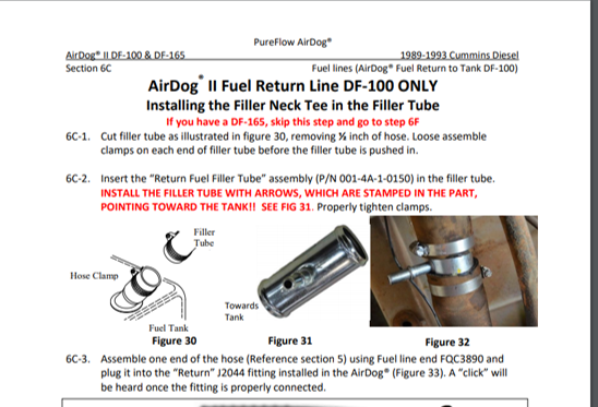

A direct return line to the fuel tank could be plumbed into the fuel filler neck such as the set up Air Dog markets. Save you from a tank drop anyway. Air Dog uses an adapter that requires the rubber fuel neck to be shortened by 1" but, you're talented and a means to make the system work another way could be sorted out.

BAD IDEA!!! The return has to be submerged in fuel or the fuel system will siphon the fuel back to the tank resulting in hard cold starts after a long overnight sit. The fuel system will be full of air every morning and need to be re-primed. This is why GM spent a nickel on the submerged in tank fuel return hose.

Nope, you've got an apples and oranges thing here. Pushing fuel back to the tank from the LP vs the designed fuel return system post IP. I'm late to the thread, but he did say 'from the LP.'
