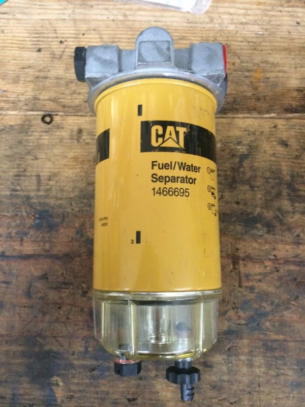

Hey folks, I know I have not posted here in a while, just been posting on the Dplace when posting.. Anyways I'm back at work on the Burb due to a oil leak on the PS valve cover so the next major move is to pull the IP and get it turned up. I also think the OEM fuel filter housing has a minor leak so I was under the truck trying to see where to mount this Catapillar fuel/water separator P/N 1466695 that I bought a while back and I think I've located a good safe spot for it but I wanted to try and find out it's filtration capabilities before I weld a mount for it. So I googled the part number but couldn't find any specs on it, anyone have any idea where I can find this info? As always thanks for the help.
Hey good to see ya!
I have no idea about the filter specs, I would be calling the local Cat dealership and asking, but closed today. Please post if you find out- could be a nice set up with the clear bowl- me likey.

Couldn't find any specs from Cat but the replacement filters seem to have these specs
Hey thanks AK. So doesn't the OEM filter only filter to 12 microns? And the Cat is 15 microns? How many micron filter should I try to get for final filtering? The only place I have to put a filter with the exception of on the DS on the outside of the frame rail is make a bracket to mount a short Racor on the intake where the OEM filter is mounted. I don't like this location for two reasons, heat and fuel in the engine valley when changing filters. I would like to just use one if possible. I'm going to a Racor dealer tomorrow to see what they have available. Also I would like to mount a Amsoil pre lube pump and oil filtration system somewhere.
