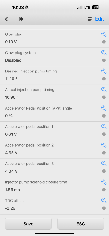

This ^^^. You need to get the Actual IP timing set to 3.50 or less, then you can set the TDCO.
I glanced at the actual IP timing but dont remember what it was.

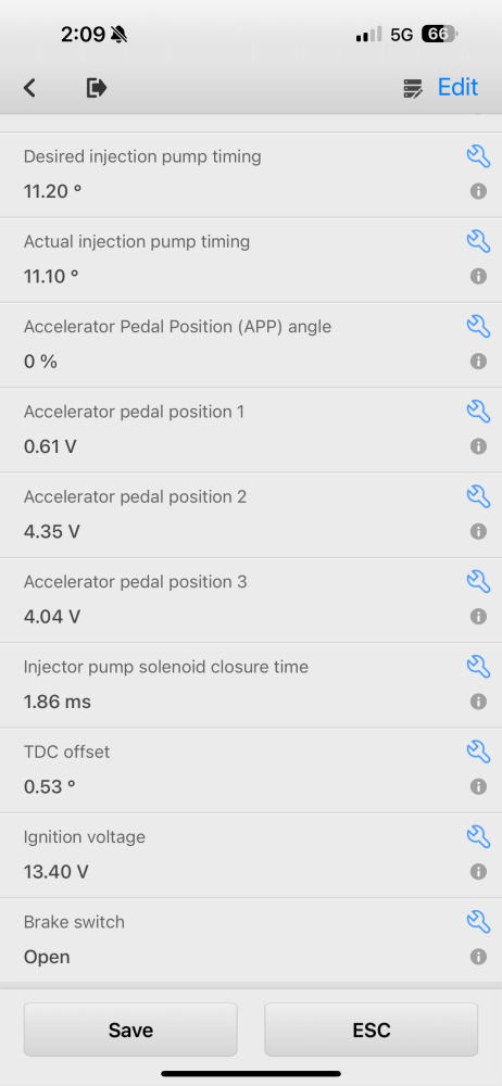

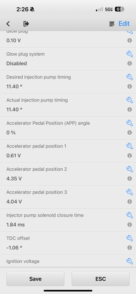

The next thing that has Me going is the IP timing.
I’ll loosen the nutz and rotate the pump more to the passenger side.
But my biggest question is how do I get the IP timing to 3.50.
The last adjustment the IP off set came down to -2.29 but IDK if rotating the pump farther to the right side will change the IP timing.
More help needed please.
