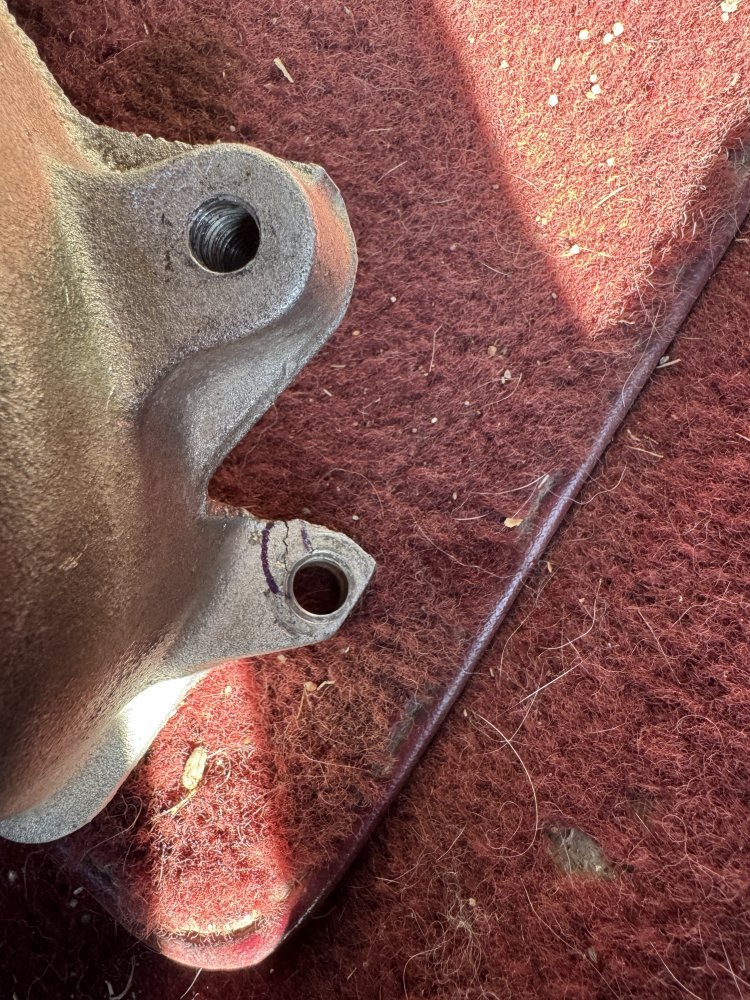

Scrubbed the head bolt holes. Got the intake manifold laid in place.
Feets got to hirting bad so called it and went to the house.
TV is on, feets are up and I’m watching LBZ (Life Below Zero) and thinking it would be grand to get some of @denata weather after I get done pharting with this truck, in the blue sky garage. 🤷😹😹😹
No one in town wants to weld this.
I have aluminum stick rod and have played with aluminum soldering but I think it would be better to grind away on the weaker side so when the bolt is torqued it would apply pressure to the stronger portion of the manifold.
Any suggestions ? ? ? ?
