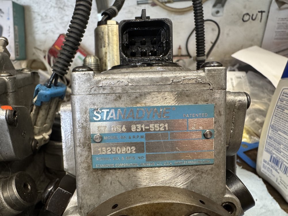

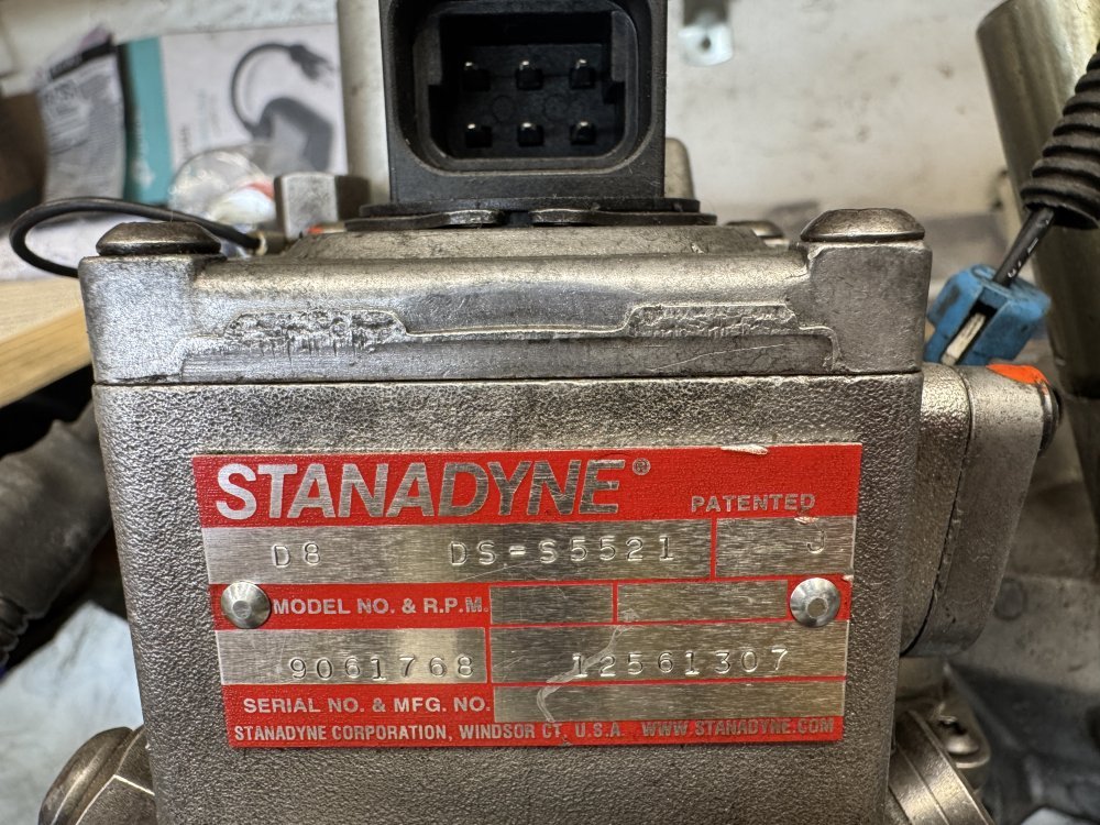

Yeah, IDK the IP thats on the truck.
Odometer is on over 270,000 miles.
It has been dependable up to this point in time.
I dont know enough about the injection pumps to do too much to this one.
The spare unit is one that I loaned out to BIG T so he could determine if His reman pumps were bad.
He said this spare pump of Mine performed as it should and sent it back, determining that his reman pumps were not so good.
The spare pump I have is a reman and came from SS Diesel Suppply from quite a few years ago.
I dont know that I really want to trust it but at this moment I dont really have a choice, unless I would order in a Flight Systems reman from QuadStar tuning and run with that. $875.00, then the $225.00 core charge that would hang on the balance for a while.
They also have a couple of brand new Stanadyen pumps $2,650.00.
Might be worth it to go with the new unit and say, so much for getting this card paid off. 🤷

With the IP on the truck, having that many.miles on.it, I would swap for your spare and run it.
Wise words of advise.
I’m just a bit weary of who rebuilt that spare pump.
That SS Diesel Supply did not have the best of reputation.
I wont have a lot of time to test run that spare pump, so, probably pack along the original pump and the extra couple of wrenches and tools to change out a IP and if this reman pump fails then dismantle and stick the original back on. 🤷
I do have AAA and if the truck stalls along the way then that service could load the truck and get it to a safe location.

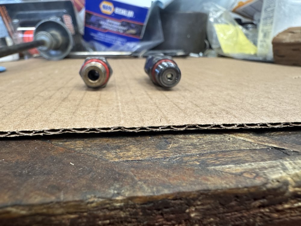

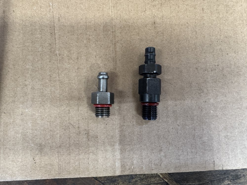

Return line fittings.
The fitting on the left is the one that came on the red tag pump, the one I am using.
The fitting on the right was on the original pump.
The fitting that was with the red tag pump is shorter and full flow return.
Now I am in question if I should use the shorter fitting that was with the red tag pump, or, the fitting that has a restriction in it that came on the blue tag pump.
Only reason I checked them fittings is that the one from the old pump was longer, removed it and discovered it has some restrictor sort of a device within its orfice.

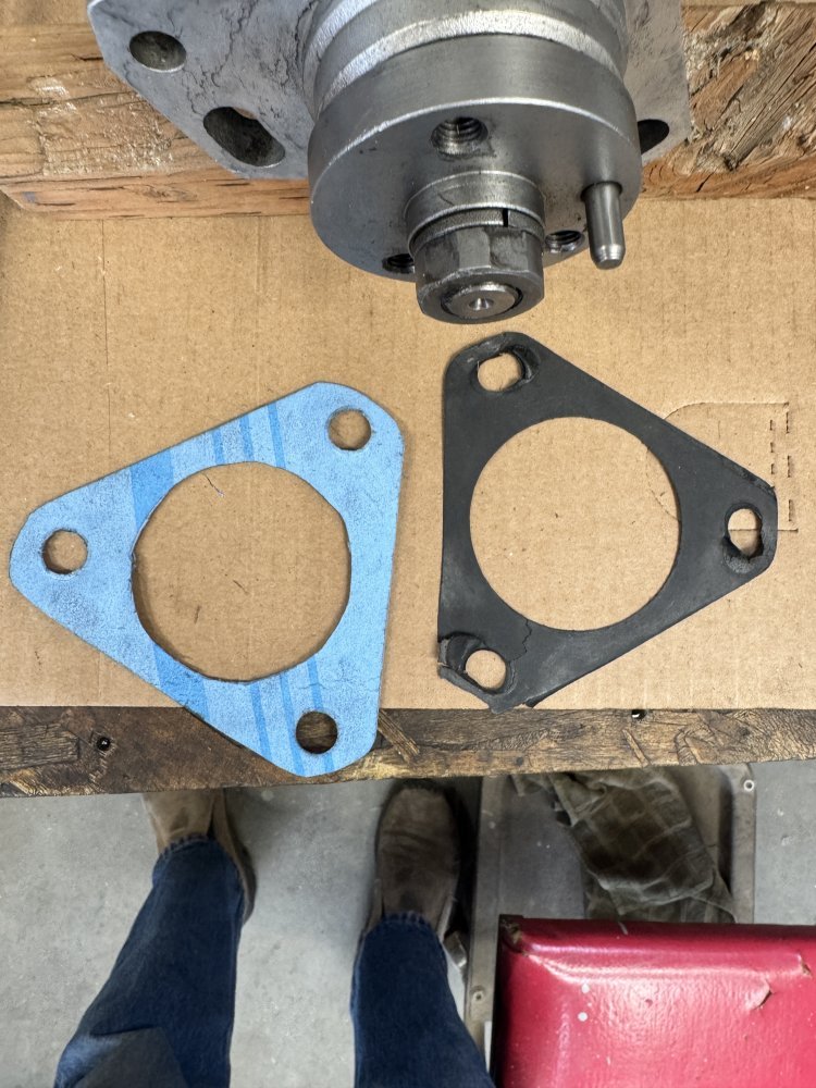

Anyhow, pump is bolted down and drive bolts torqued.

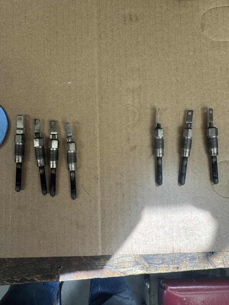

Pulled the glow plugs.
They all have the appearance that the cylinders must be fueling evenly. No GP with more soot collection than any other one.
Left to right.
1-3-5-7 2-4-8.
Six is fairly well hid behind the down pipe so I left it alone.
