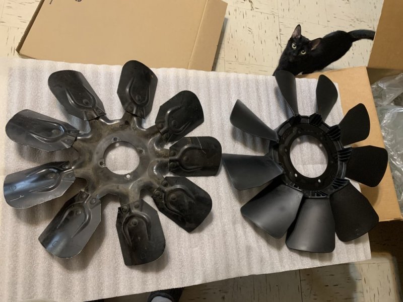

I suppose the thing I need to do is make the decision of using the 9 blade fan I already have from AK going with a thermal clutch or spending a little more and going to the electro style and another fan. being I don't really tow much, the only benefit I can see with the electro style is commanding it on with the AC. as my truck is now with the 6 blade fan and the modified clutch ( on at 180 deg ) it does fine for the AC and for keeping the engine cool. since I have to do the pump, it's best to get the HO pump, with that comes the change over from the bolt on to the spin on clutch that has to be changed.

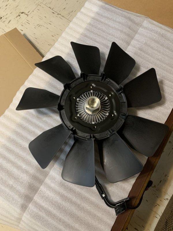

Good morning guys, so it turns out I think I am going to do the ev style clutch with the cooling upgrade. on the fan controller the AK used on his rig, the Hayden 3651, uses the threaded port in the back of the passenger head. is there another port that can be used? I would like to use that port to install a coolant gauge for a true in the cab temp reading. I also saw a Hayden 3652 fan controller that has a temp probe that would go into the cooling stack. would this be a better option?

Go through AKDD thread about the electro viscous fan. All the PNs are in there. Most order them all right from RA.

I read through his thread. parts on order :) I'm still wondering how to route the wires through the fan shroud though without slicing n dicing it lol. I'm thinking of trying to run through where the shroud splits hoping the harness is long enough.
I ended up going with the probe style that was adjustable for now. only because I want to install a manual temp gauge in the head and knowing there isn't another port to use unless I drill and tap one. since we are planning another trip to Kerrville for more house maintenance for my step mom, I wanted to just probe the stack and keep it simple. since it's adjustable I will be able to set the temp lower if I need to, to overcome the air temp flowing through the stack while on the road. It also has an override circuit for the ac that I can tap into with a switch if needed.

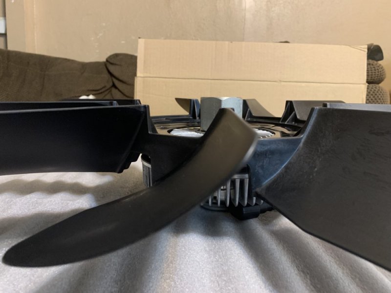

Looking My truck over, the mounts have sagged and the 9 blade steel fan is a lot lower to the shroud than it is to the top.
Might wanna give Your fan to shroud a good looksee.
oh crap! I forgot about that! my version of Homer Simpson... DOH!! I'm sure mine are sagging lol I did have the 9 blade fan I got from AK installed for a short time and it wasn't hitting the shroud. maybe just maybe (fingers crossed) it will clear and I can plan another weekend to do the mounts!

Very little noise and vibration difference between the two types of mounts, but you will notice that the engine doesn't sag or become offset over time with the polyurethane, unlike the rubber mounts that degrade/tear, especially important when running the better fan blade and/or CAC piping.
