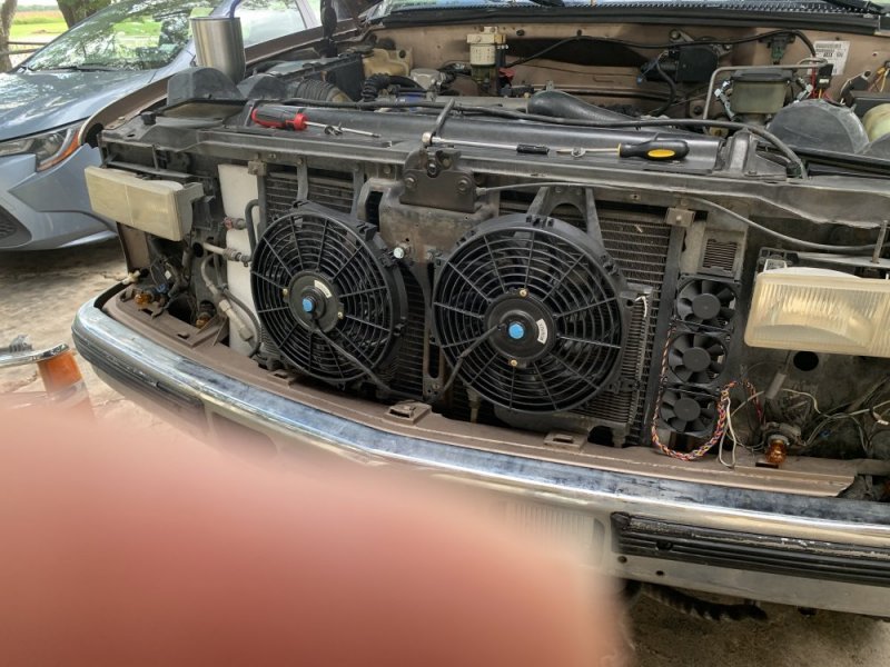

I used two 12" pusher fans! I may just wire in a switch in the cab to enable / disable the fans while on the road, they are wired to a relay that is triggered with the ac clutch. I also haven't installed the 9 blade fan I got from @ak diesel driver yet. still need to order a clutch for it.

Is the engine cooling fan running more with the pusher fans installed?
I would just use one pusher fan myself on the passenger side as that is where the refrigerant leaves the condenser. A pic of your fan setup would be interesting.
I'll post a pic later this afternoon, while I isolate the two fans to be able to control them separately. I havn't noticed the fan clutch running more, but then again I had modified the thermal coil a while back to make it come on at a lower temp. I have placed an order for a new fan clutch so I can install the 9 blade fan and get away from my OE 6 blade fan. it should arrive on Saturday. the clutch I ordered is a knock-off one just to get me by for now, as I don't want to dump money on a good clutch now when later I plan to upgrade the pump then buy a good spin-on clutch.
Then just go for the electro/viscous fan and You can adjust it to whatever temp You would like it to come on.
There is also a provision to hook up the AC compressor to it to so that the fan kicks on when the AC is turned on.

Sorry guys. I didn’t get to post a photo of the two pusher fans yesterday. We had an unfortunate event involving our granddog. Our baby girl has to spend 10 days in doggy jail 😢. I really despise city and county ordnances
anyhow. Here’s the photo. I’m in there isolating the fans to be able to control them separately

Well got the fans separated. Only have the passenger side connected right now. Polished up all the lights and reflectors while I was there showing some love lol. And have a planned trip to the junkyard in the morning. Will test my mileage with the trip 🙂

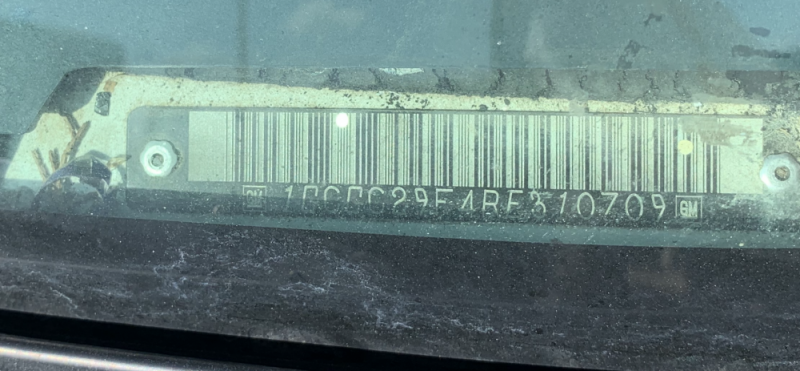

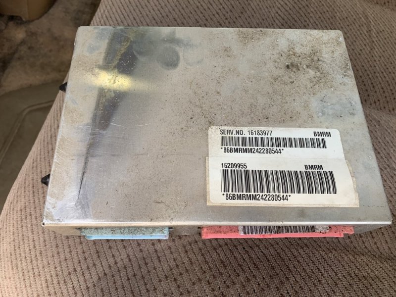

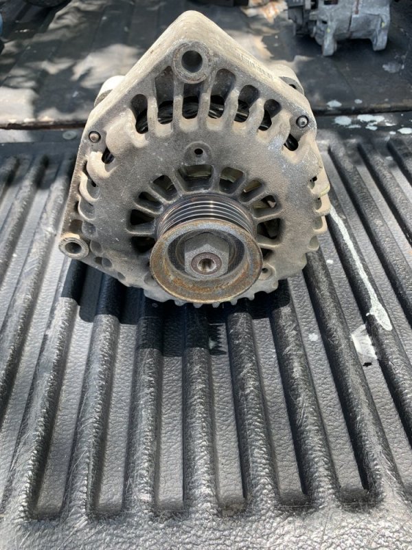

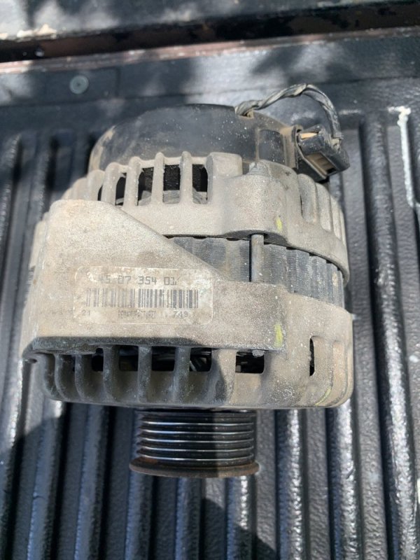

Well just got back from the junkyard scavenging VW parts for my daughters car and I might have scored on some stuff for my truck! Found two 6.5 trucks with the engines still intact except for the intakes. I pulled a PCM from one of them and then found what I think is an ad244 alternator. Is there any way to identify the alt or the options the pcm has? For $20 each I couldn’t refuse lol
The vin from the truck I pulled the pcm in one photo.

You are mighty fortunate to have an auto salvage that has 6.5 units.
There is 1 auto salvage here, they have two 6.5 trucks in the yard, one of the owners also has a GMT400 with a 6.5 and He will not lat anyone scavenge parts off of either one of those.
