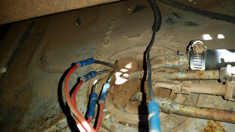

I also checked voltage at the pump and got 2 grounds, one at 13.5v, and one at 6v. This sound right?
You have 3 wires, 1 is a tank ground, 1 is pump power, and other is sender for the gauge. A tbi needs at leadt 8 to even run decent, but 11-12 is better. I'm surprised the injectors even pop at that pressure.

I have 4 wires at the tank head. They are badly faded and have at least 3 ft of splices 3" from the tank plug. One was greenish, one yelowish, one black, one black with white stripe.

From what I could find of pics on rockauto, you should have a 3 wire plug and a seperate ground with a ring terminal. 2 should be direct grounds, the one in the center of the 3 wire plug should be sending unit, and pump power. The 2 grounds I would think should be solid grounds. If you're not getting a good ground, then that could easily be your problem. Remember, grounds, grounds, and grounds.
As to tanks, does it have a single or dual tanks? Single tank is 34 gallons in front of axle, dual tanks is 25 in front and 31 in back. Rockauto had all 3 listed when I just looked.
13.5v power and 6v gauge sender wire sounds logical though wouldn't you think? I was below 1/4 tank, and by below 1/4 I mean the gauge read 3/4 lol
The rear tank is only meant to be a transfer tank if it works like the diesels. They only came with a really low pressure pump in them iirc. The front tank was the one that had the pump to run the engine. The rear pump should be a 6-8 psi pump while the front tank was a 13 psi pump. The sender wire should have arou,d 6 volts on it backprobing with less than a 1/4 a tank in it.
